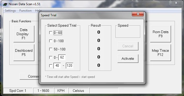

Sorry for digging up an old thread. But would it be possible (well i guess it would be, because i had something like this for my Nissan 1000NX GTi) to add "Speed trial" in this performance analyser? Here is picture from Nissan Data Scan:
I know it wouldn't take much time to add this in your software. Is it gonna be part of new "Vehicle Dynamics"? If so how much will it cost?
