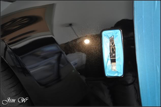

Long story short, the car wasn’t going back to Rolls Royce. Que WhiteDetails.

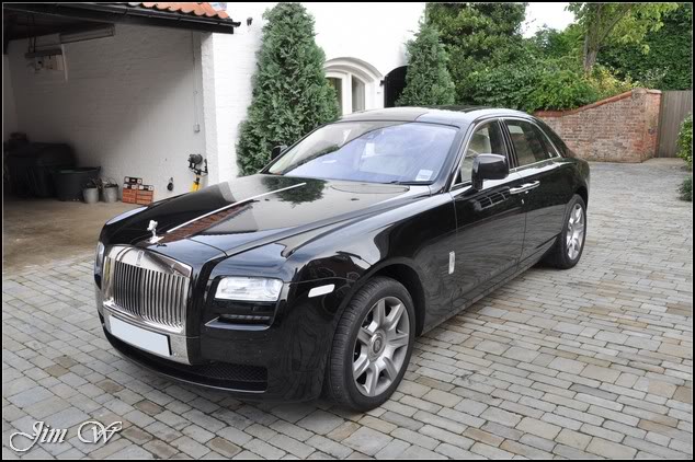

Upon inspection:
The bodyshop defects will be revealed a little later once the wash stage is out the way.
I was only asked to carry out repairs to the damaged areas left by the bodyshop’s doings. This included, the boot lid, N/S rear quarter, N/S rear door, N/S front door, N/S front wing, half the bonnet and the roofline.

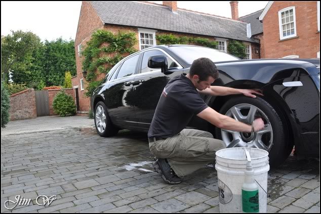

Starting with the wheels, these were cleaned up with Megs APC and various brushes.

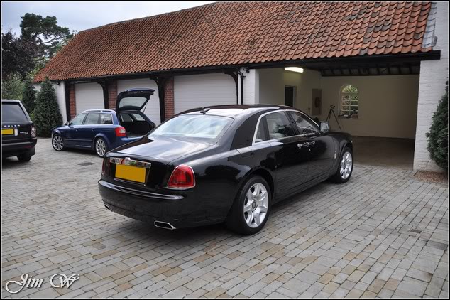

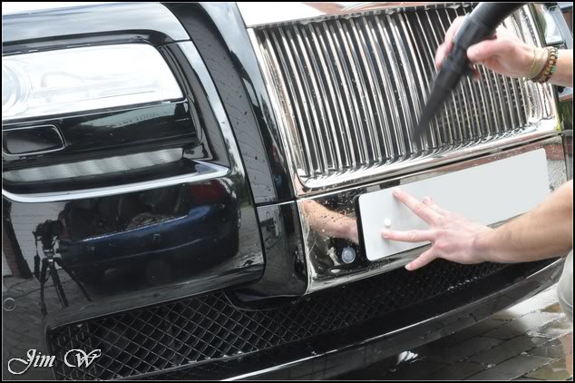

Vehicle had to be moved forwards to allow me to clean the area that was being blocked by the enormous calipers.

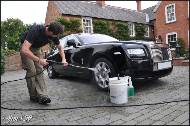

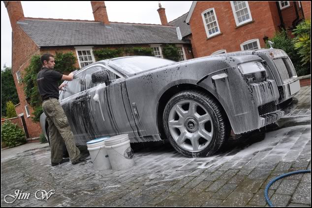

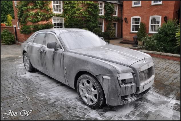

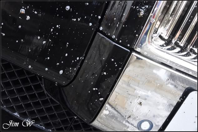

Front end was covered in bug splats. G101 applied and left to dwell for a minute or two…

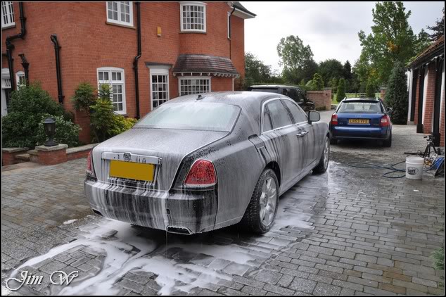

Snowfoam delivered to act as the pre-wash and help emulsify any surface dirt.
Snowfoam rinsed off at high pressure – further snowfoam application was given to aid the ultra slick wash with Dodo Juice’s Born To Be Mild shampoo.

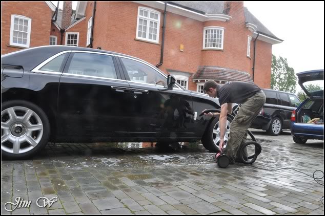

Washed via the two bucket system..

A priceless bit of kit, it really is. (Especially for the mammoth grille up front!)

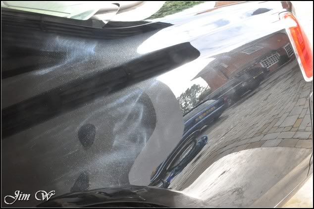

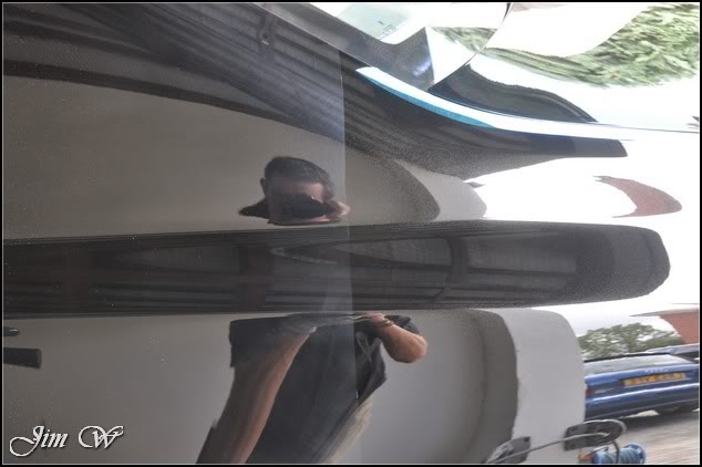

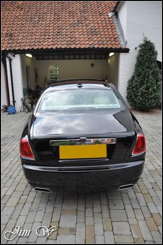

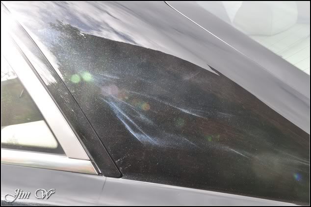

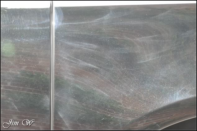

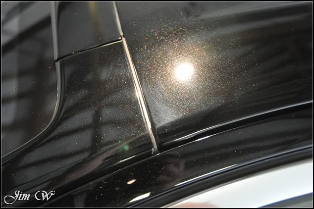

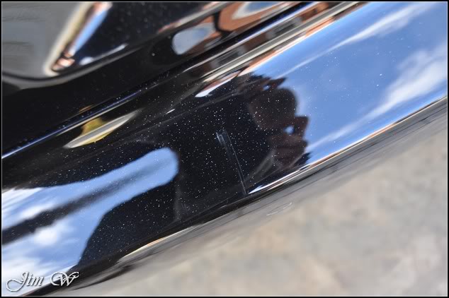

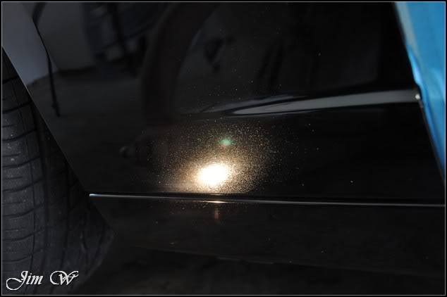

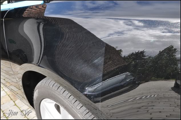

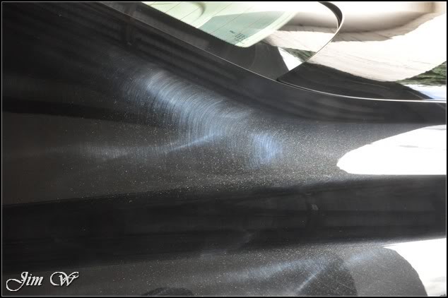

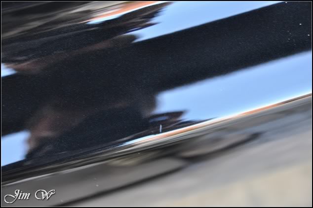

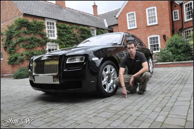

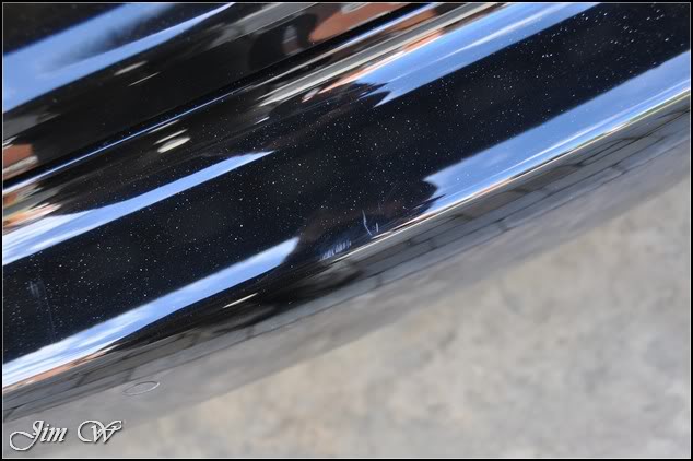

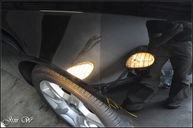

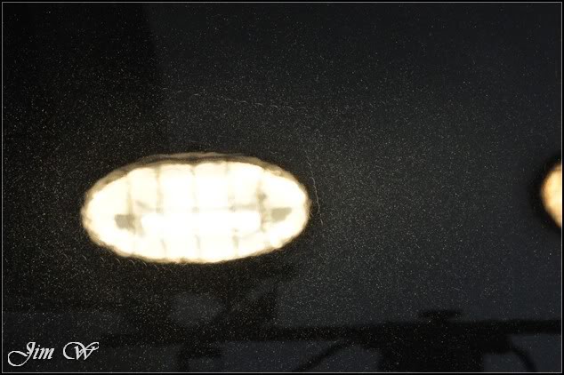

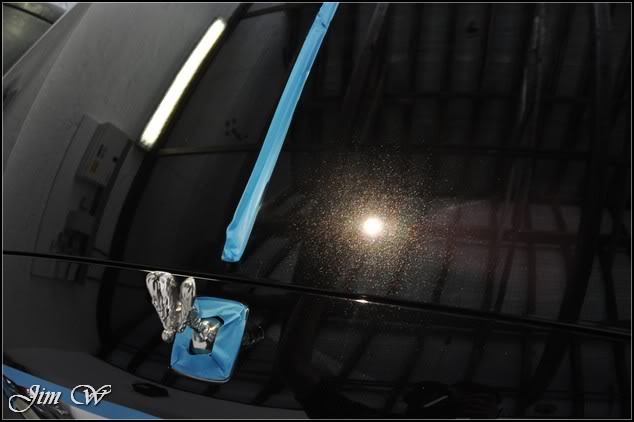

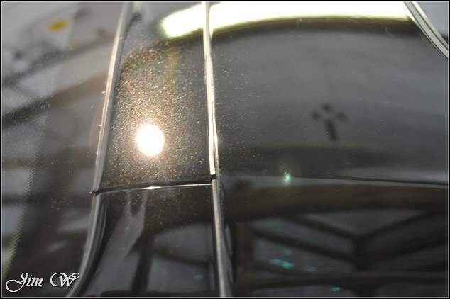

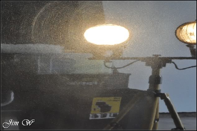

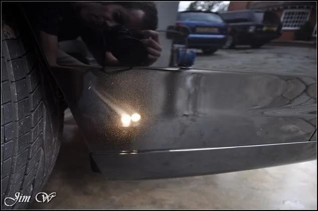

OK. So, after a quick jig, I leave the car in the sun to show the bodyshop horrors. (Please bear in mind this is a 7 month old £200k+ Rolls Royce)

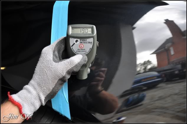

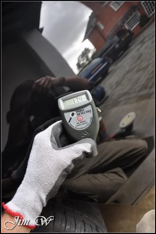

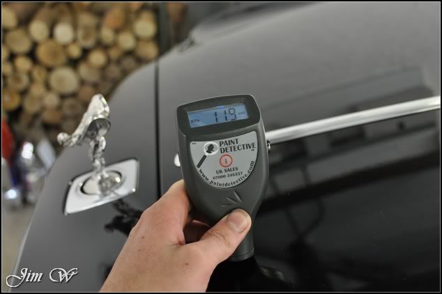

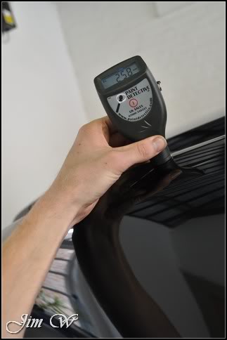

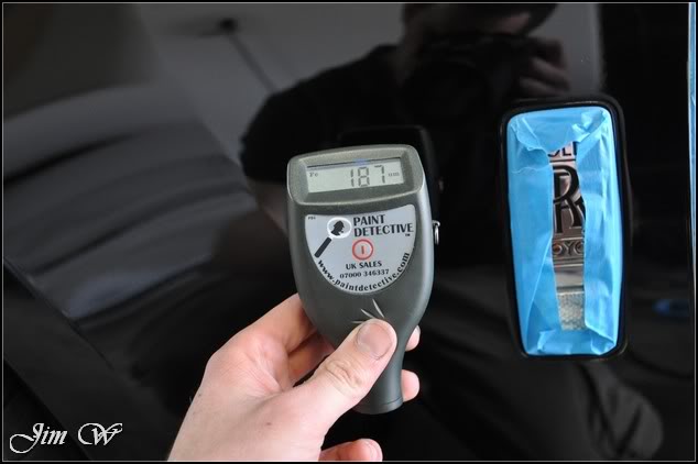

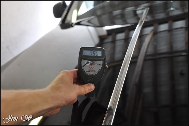

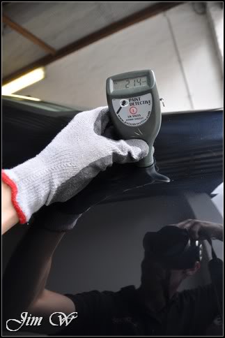

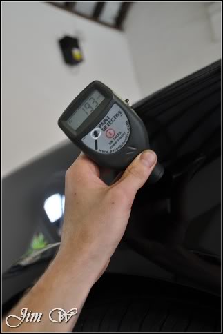

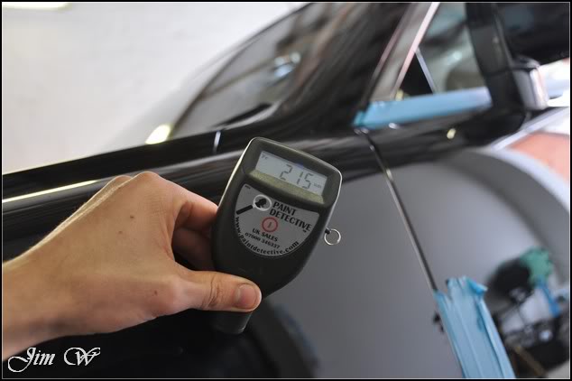

Paint thickness readings of the nearside were all over the place:

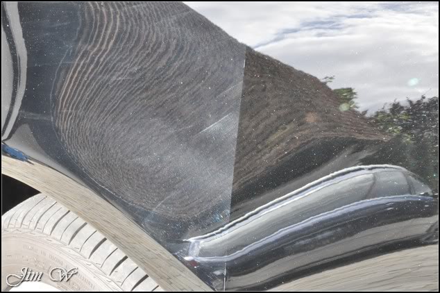

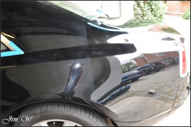

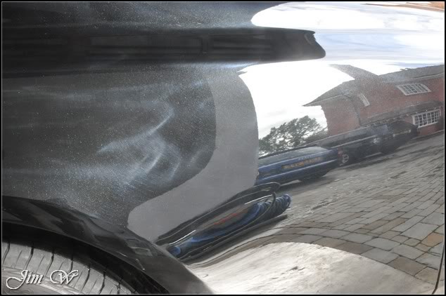

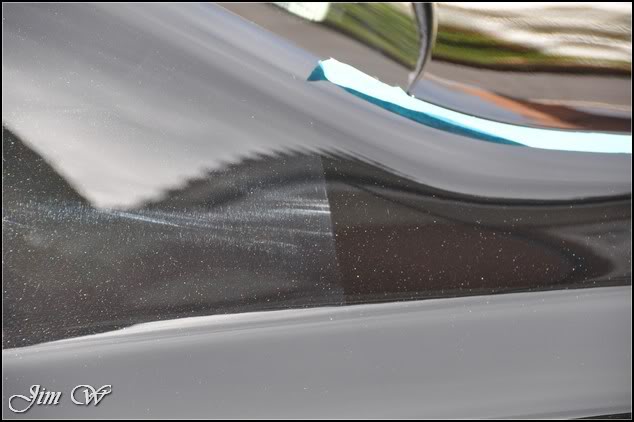

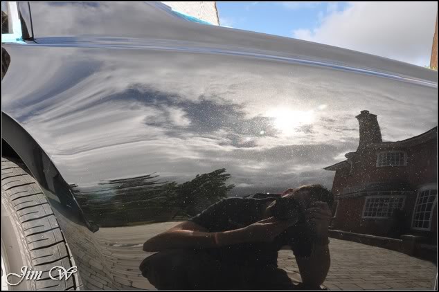

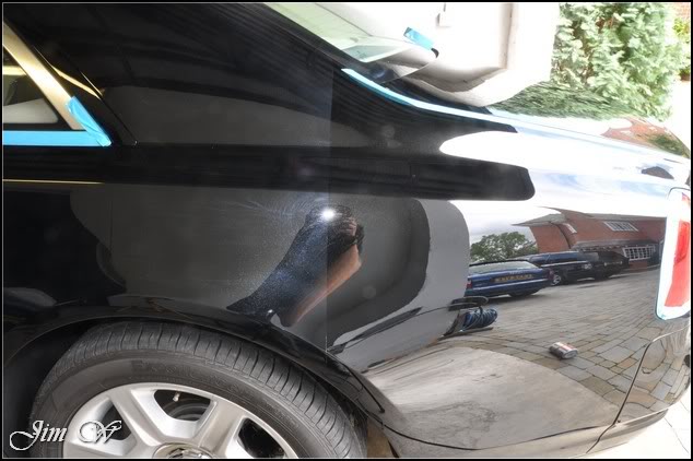

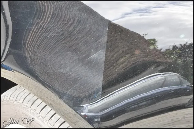

This shot shows the point at where the rear quarter had been compounded down to (but not making it all the way to the bottom) You could clearly see every pass that the machine polisher had made.

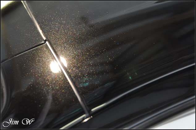

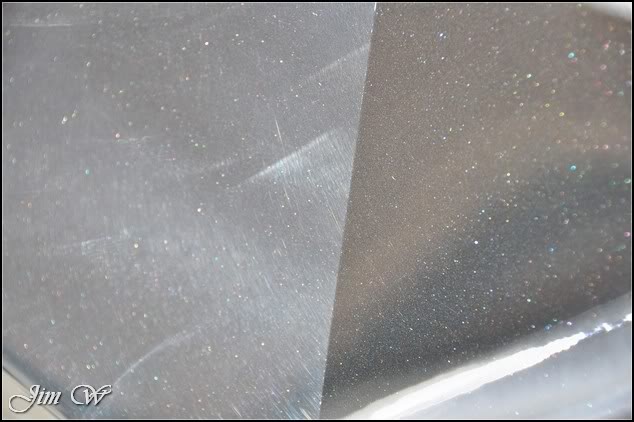

After some work on the boot lid and the rear quarter, we’re left with this 50/50:
Night and Day difference and it shows how much the bodyshop defects were stealing the true colour and clarity hidden beneath.

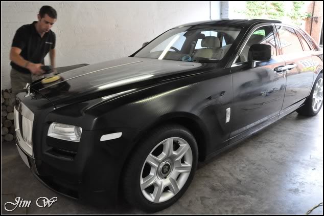

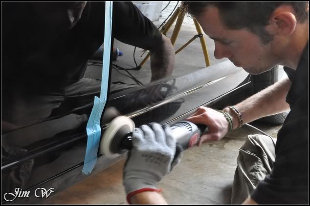

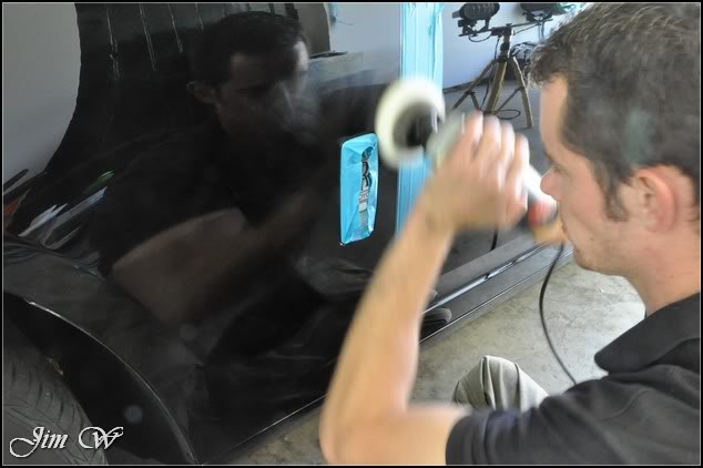

On most of the panels I could get away with only using a mild finishing polish and polishing pad. Some areas suffered badly though from sanding marks and deeper niggles which required chasing a little further.

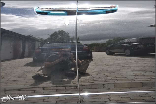

A 50/50 between the two doors:
Smaller spot pad work:

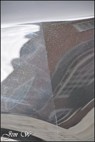

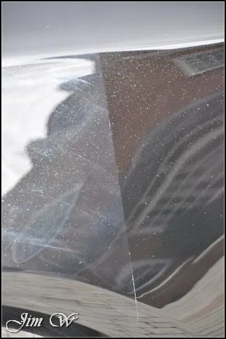

Rear wing before:
And after:

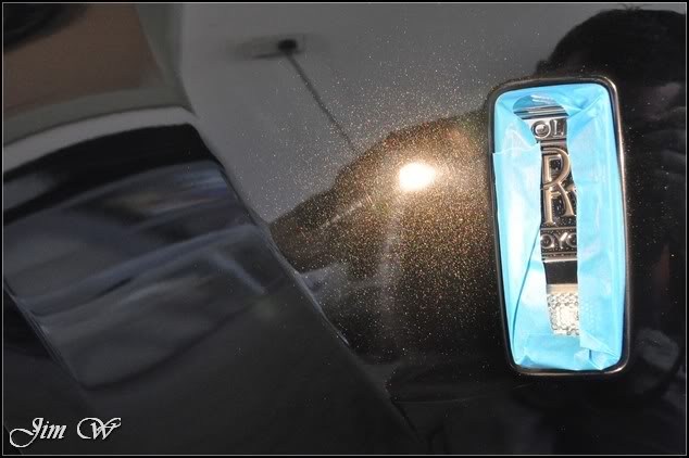

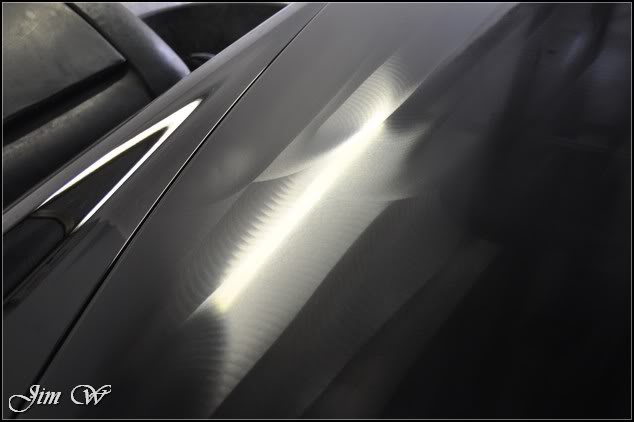

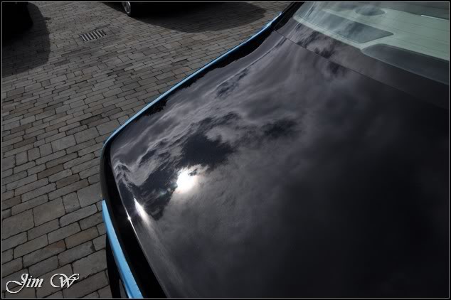

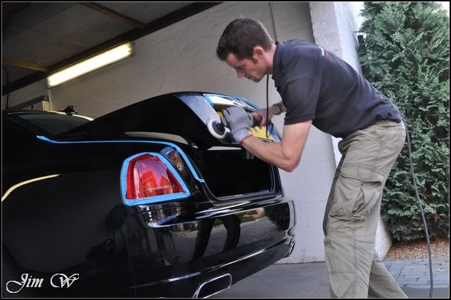

This made me laugh; they obviously didn’t ‘polish’ the whole bonnet - they just did a little area on the left hand side lower quarter:
Similarly, the boot lid only suffered in a small area but both panels were refined as one to give the finish that it should have been left with at the bodyshop.
Before on the N/S front wing:
After:

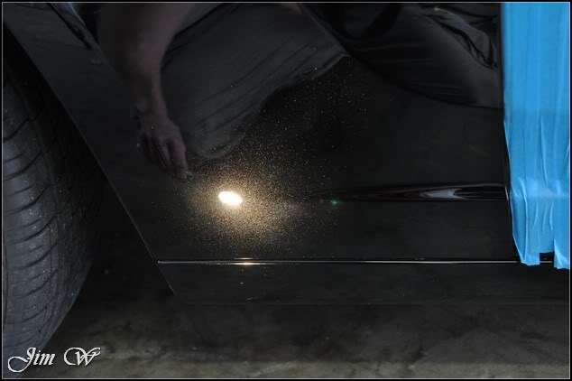

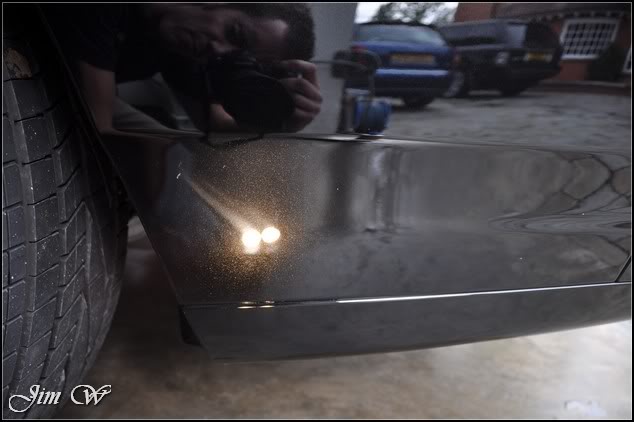

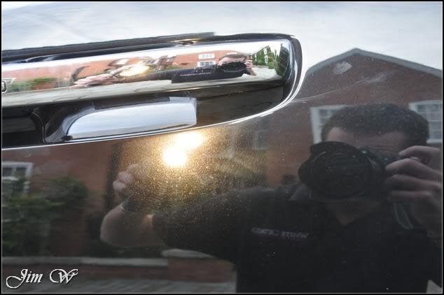

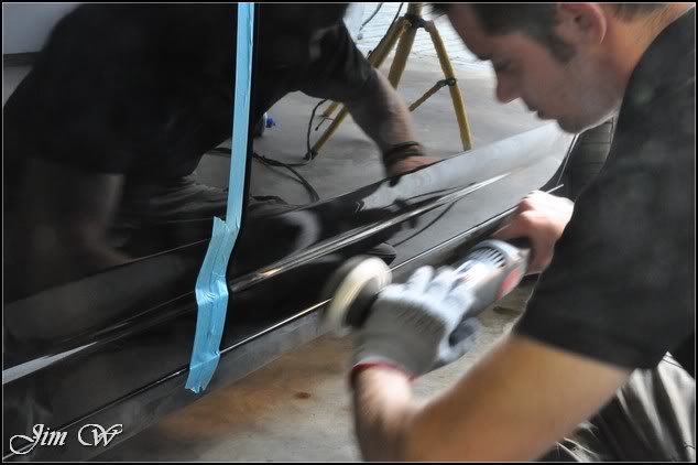

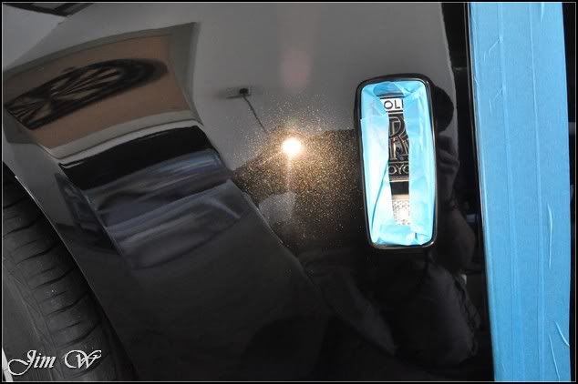

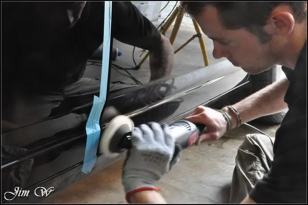

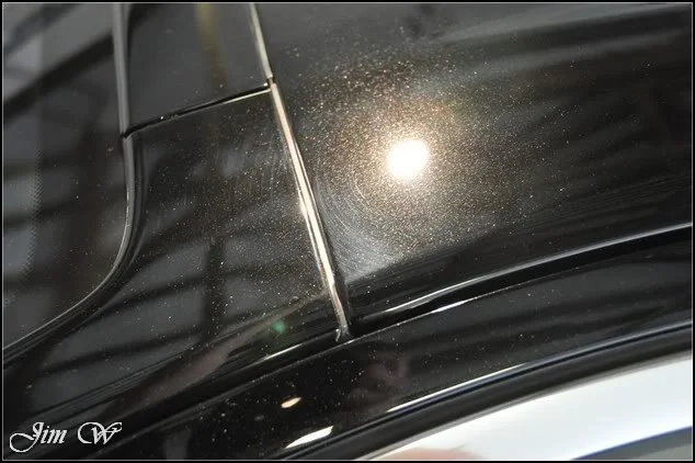

Lower down on the sills lots of rough sanding marks were still present:
To improve, this required stepping up to FastCut+ on a light cut pad and the refining later with Menz 203s.
Readings:
Door before and after:

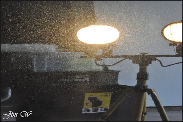

Look real closely and you’ll see we’re left with deep pig-tailing from the DA sanding stages.

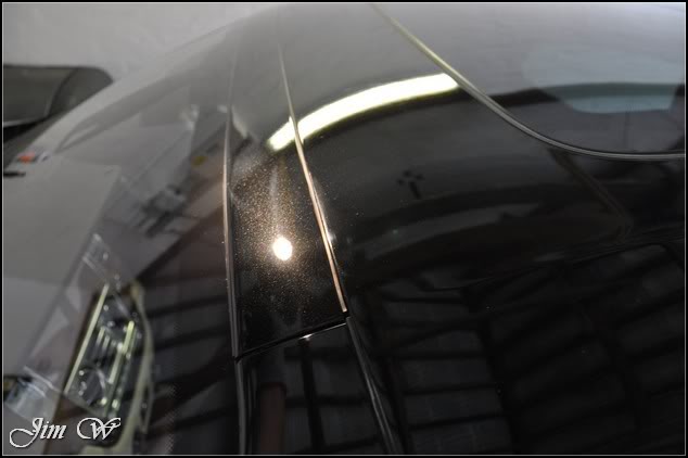

Bonnet refined nicely:

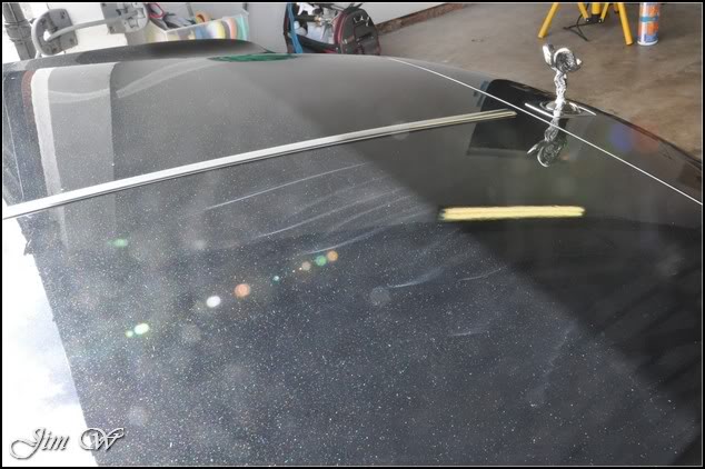

Roof befores:
Roof afters:

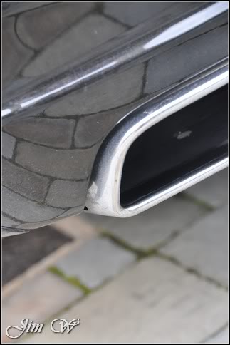

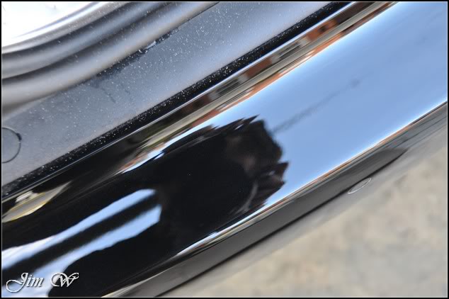

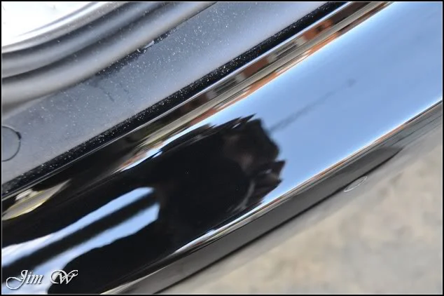

Although not one of the areas of concern, the lip of the rear bumper had a couple of light nicks too it.
Before/After:
And Before/After:
Much improved.

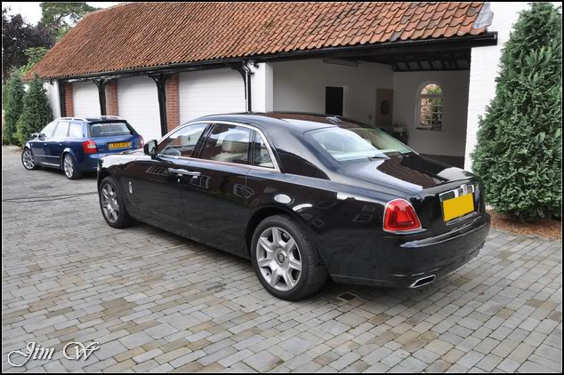

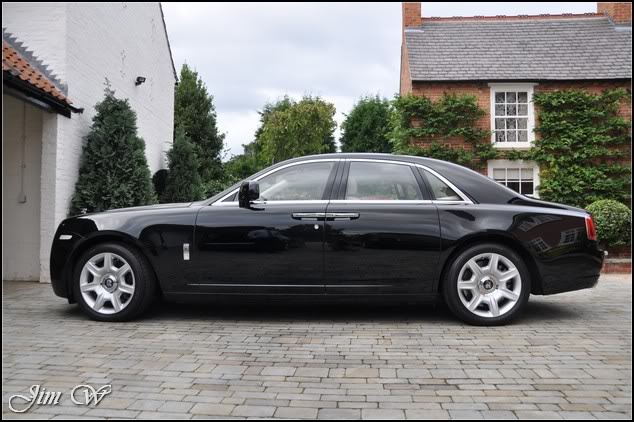

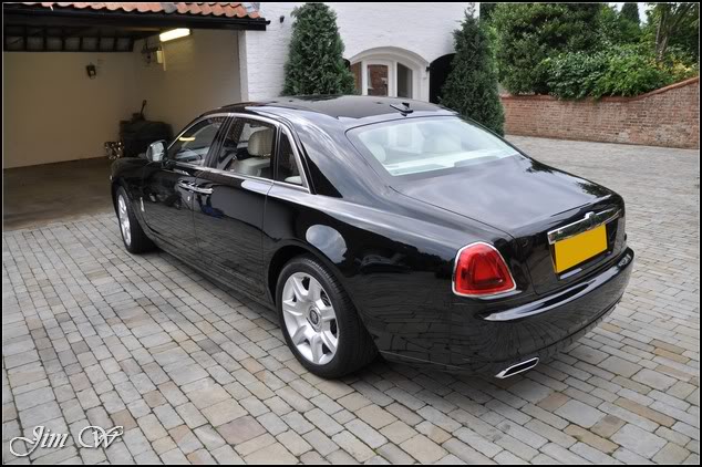

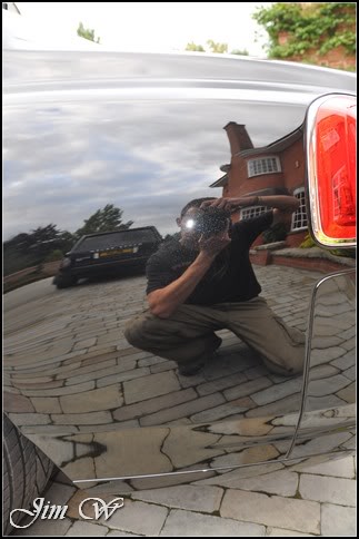

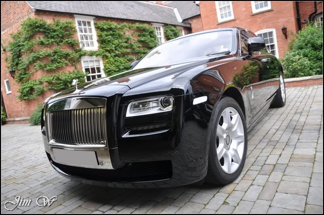

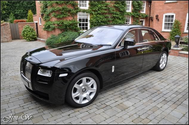

9 hours later, a Rolls Royce Ghost looking like it should:
What a car.

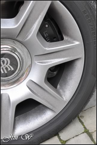

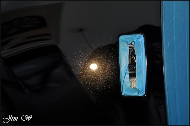

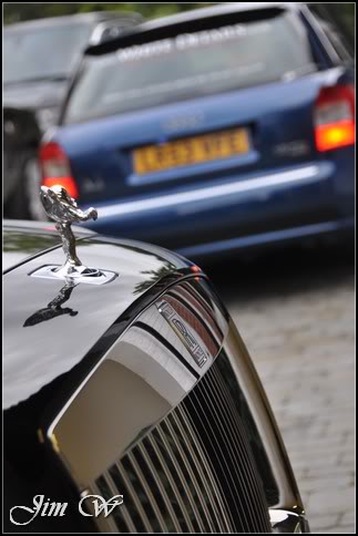

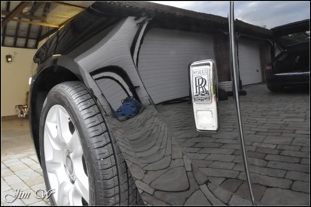

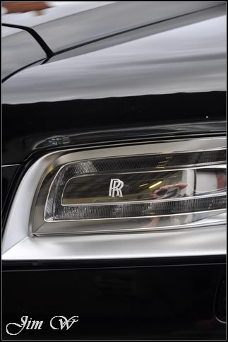

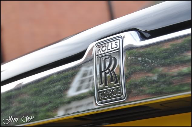

The second picture down, picture of the calliper, are there letters missing off the Rolls Royce branding on the calliper?
  Audi A4 AVANT 1.9TDi
It's a very good spot that Danny - I'd noticed that too... It was the same on the driver's side aswel.
Wasnt sure if i was just seeing things! Does the owners know? Id be pretty pissed i reckon, such a boss's car, the pads superb aswell!
