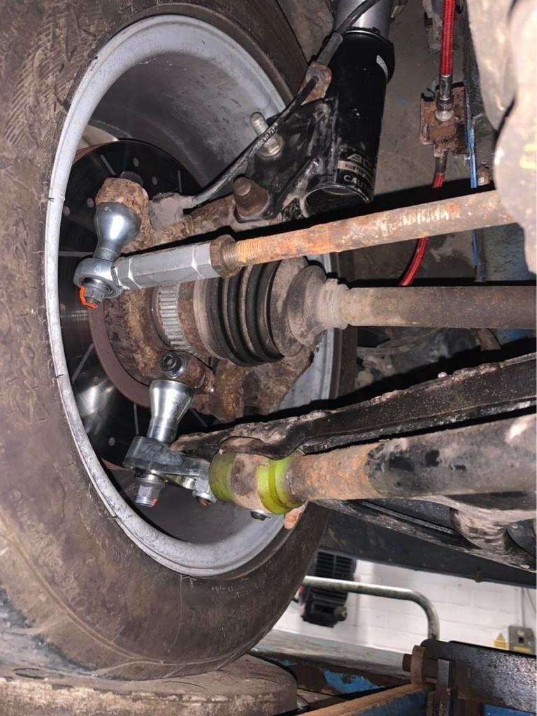

Ive had the Northloop kit and the ACS in the past and the Northloop kit was much better quality.

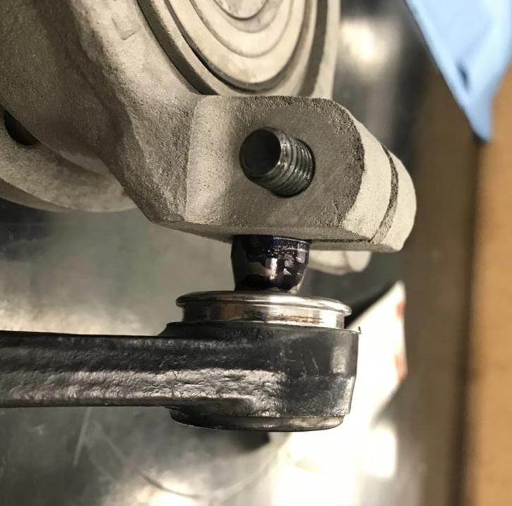

I know of at least 3 cars that have had the bottom pin snap on the ACS kits while on track.
I know the first batch of the lower pins from ACS were made from stainless steel 304 or 316 (chosen for corrosion) which is what caused the failures as the UTS and fatigue properties of the material is far lower than the high strength steel used on most other kits... Anthony did replace people’s broken ones with the high strength steel ones , Ilya included, hence no issues now I believe..

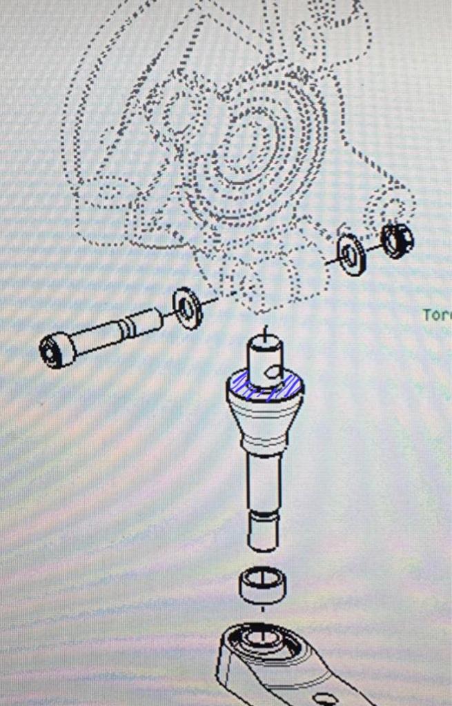

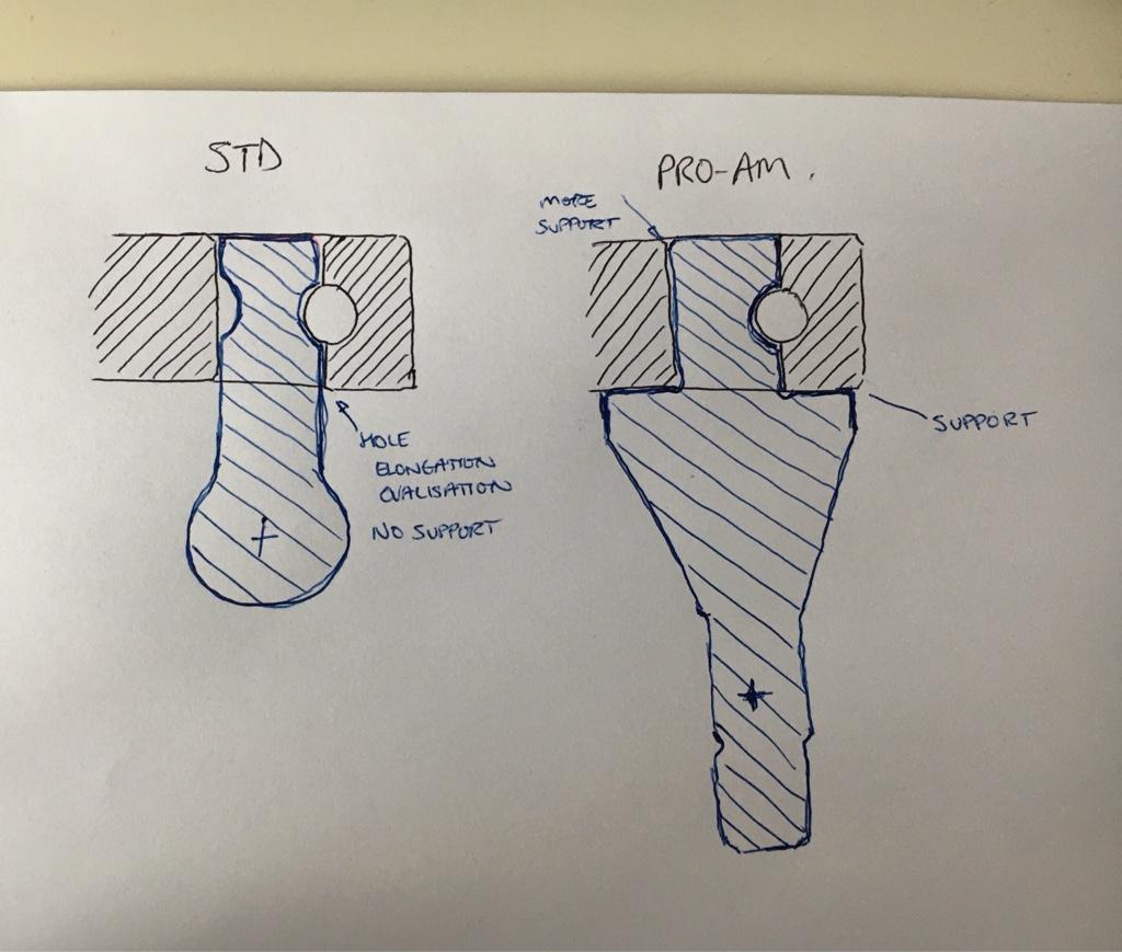

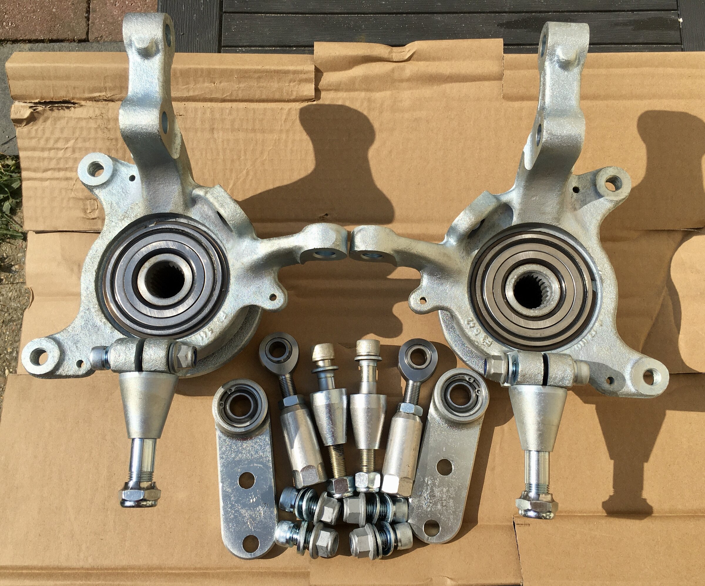

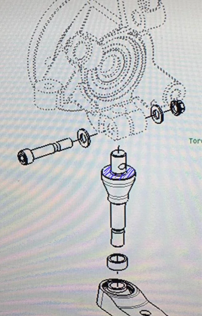

Not sure which kits your referring to that had the potential oval issue.

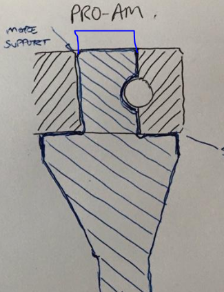

However we aren’t concerned with the Hubs ovalising on the PRO-AM kit. As long as you fully support the lower surface of the hub with the pin,which it does, then it’s probably got less chance of ovalising the hub than the std pin, even with a lower fulcrum..
When you remove the rubber boot you can see the std lower ball joint pin is only supported by the hole itself.. so all the load wants to try and pry the hole open and closed.
Our kit has a large flange supporting the bottom surface, and the pinch bolt groove to locate the bolt is milled into one side (adding cost but worth it) this allows full face contact 300deg of the pin inside the hub adding more strength and most importantly surface area and durability.

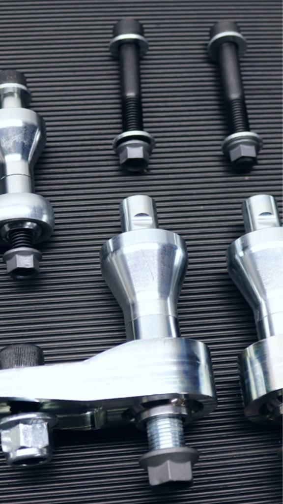

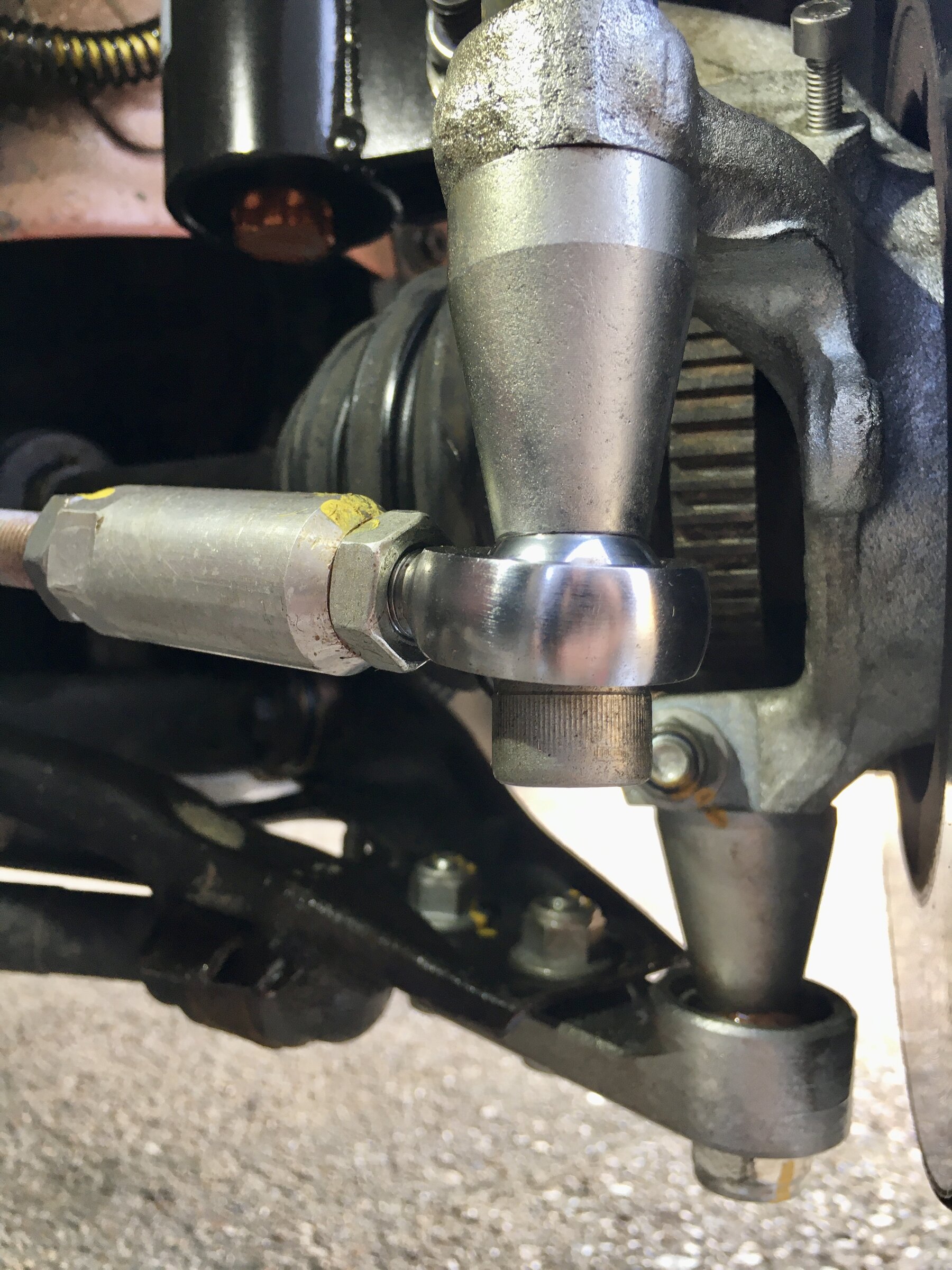

Tomotek out of professional curiosity and not as criticism, - lovely design. However - as the lower ball joint bracket/holder looks to be machined from solid why didn't you guys add a small top/bottom lip for a rubber boot? If its being machined already its basically free...
Are silicone boots for rose joints available? Would be a simple mould and a useful part if not.
My only other observation with regard to the ovaling comments above - if you are reliant on the extender being up against the pinch bolt face how can you be sure that the cast face is flat and free of annoying casting defects? What steel have you spec'd and what is its fatigue properties? I think realistically you will need to treat the two faces as not being in full contact.

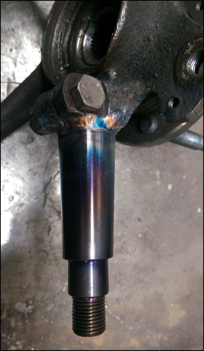

PS I would be happy with either solution over welding anything to a cast hub. Guess the only other potential solution might be to have a slim nut on top of the extender plus the pinch bolt... Not sure how much room there is there though (from memory just enough).

Hi Rob, all points noted, not taken in a bad way at all :) ... my thoughts below:
1: Rubber Boots - OEM ball joints more often than not are a steel on steel type for cost which are very sensitive to dirt ingress into the joint, as dirt can get between the two surfaces and start to wear it away causing play.. made cheaply needing more protection
We are using motorsport grade spherical bearings (x8 the price) with high precision PTFE liners.. The PTFE liner is a much tighter fit to the inner ball and it’s other function is the edges clean the ball face during articulation, so no boot is really needed.. They are also Stainless steel so don’t need protection for the elements to stop rust... That’s why you never see rubber boots on any wishbones, or Track rod ends on GT or Rally cars etc.. yes they do get cleaned more regularly.. but they are used in much harsher environments and for up to 24hrs straight etc.
2. we state in our build guide to ensure that surface is cleaned properly, and free from rust and defects... however realistically the extender doesn’t need to be in full contact, even if it’s point contacts around the circumference it is far better than the std OEM design.. or if there was a 0.2mm gap it only needs to flex less than 0.5deg before the extender face contacts and offers full support... (looking at some bad examples of ovalising, the OEM pin must have articulated about 10deg!) We also measured lotsss of hubs to make sure we got the right dimensions.. We use EN24-T which is then Zinc plated and de embrittled
3. Yeah a nut would be a nice addition, which we looked into, on the top side, however there is no room between the hub and the ABS ring on the outboard CV joint of the driveshaft.. only about 2mm between the ABS ring and Hub itself, hence why our extender is flush at the top, as per OEM position.
And yeah I’m fully with you on the not welding to the cast hub!, it’s a pain!, and the HAZ effects in the extender would weaken the material properties locally to the highest loaded point, which isn’t good.

Hi Tom?
Nice reply - I am always really interested in the thought process behind design features. Yours seem well reasoned.
1. Sounds good, the pessimist in me still doesn't like open joints thought, cnc machines often have PTFE wipers yet without covers they still wear. Common failure mode for motorbike forks is a stone chip to the stanchions plating, so its really nice to see that the ball joint is stainless and not chrome plated. My feeling is that slight wear the PTFE liner would result in rapid accelerated wear as more and more grime gets into the joint - I see this with robotic actuators where I like to use Igus leadscrew/ptfe nut systems - I can't effectively cover these up due to space. Guessing a joint with boot and ptfe lube would probably last for ever by the sound of it! But appreciate your reasons and I'm sure you carefully considered it during design.
2. Nice - you've clearly thought about it well. For severe ovaling I would suspect the clamp joint is not done up properly, clamp joints aren't perfect, they are not in 100% circumferential contact with the pin (unless the clamp i super funky!) so I guess you could argue there might be the chance of very slight rock - for similar applications in other fields I have used Loctite 648 or 638 with very good success.
3. Ahhh
Cheers for the replies dude, not that you need any validation from others but I think it looks like a lovely, well thought out/engineered kit - and as said before my questions were not criticism of the design (which clearly works well) just curiosity over some of your design decisions.
All the best

It’s actually Scott .. my surname is Thompson and used to get called Tomo, so was going to use TomoTek as an engineering name lol.. everyone thinks Tom tho :)
Thanks Rob, no worries, it’s good to pass on knowledge and opinions as it can generate ideas and invoke thoughts that you may not have otherwise had etc.
I defo agree on the clamp bolt!.. very key it’s done up properly and remains tight.. as soon as it comes loose on the OEM it’s asking for trouble.. that’s why we only use K-Nuts on all crtitical joints in our kits.. cost a small fortune but worth it haha!

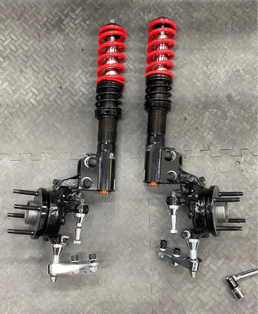

I should probably update here since I started this thread but never gave an answer.
I ended up picking up a set of @NorthloopCup / Bridgecraft Engineering hubs. The first word that springs to mind is 'beefy'. Well designed, thought through and look like they'd survive Hiroshima twice over.
I upgraded a lot of things at once, one of them being the hubs and a quiafe diff. The car is 1000x more predictable now, no more bouncing around correcting the steering around corners and you can just point it and tell it where to go. It no longer feels boat like and feels so much flatter going around a corner even with cup shocks and Grams springs. With coilovers I think it'd be perfect for track
