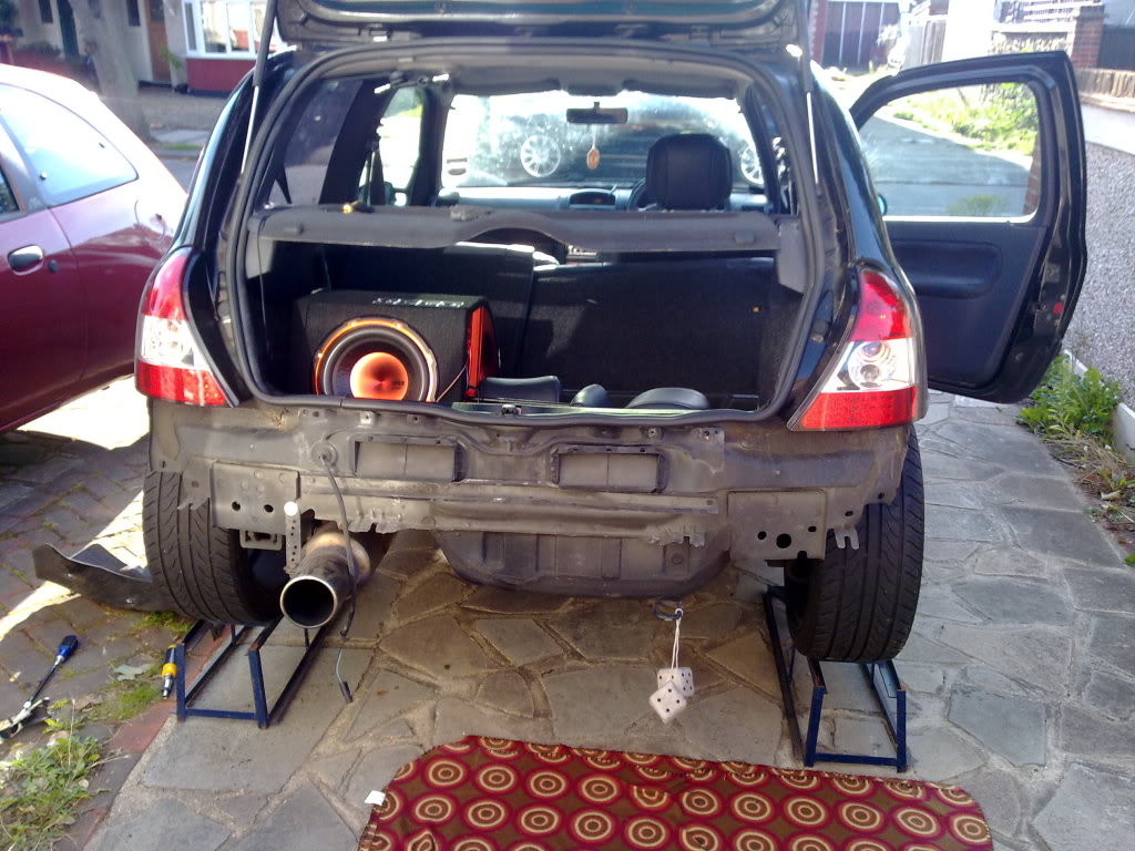

another thing, putting the back bumper on today but i need to do a cut out for my exhaust, any tips? cheers, max

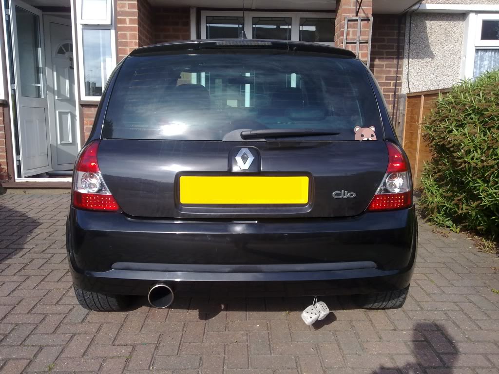

Got the back bumper on the other day, Fingers crossed i can put the rest on today.
Pictures.
(Yes I know it needs a clean but have been busy with work and getting the parts :))

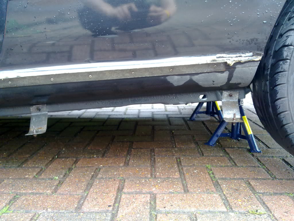

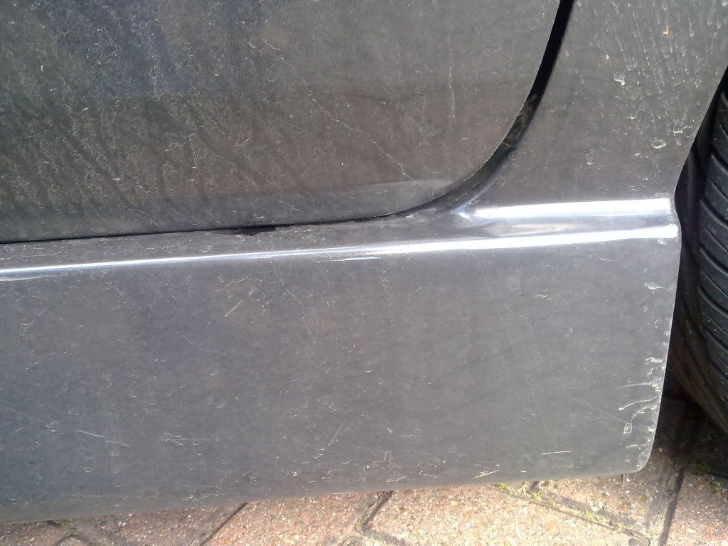

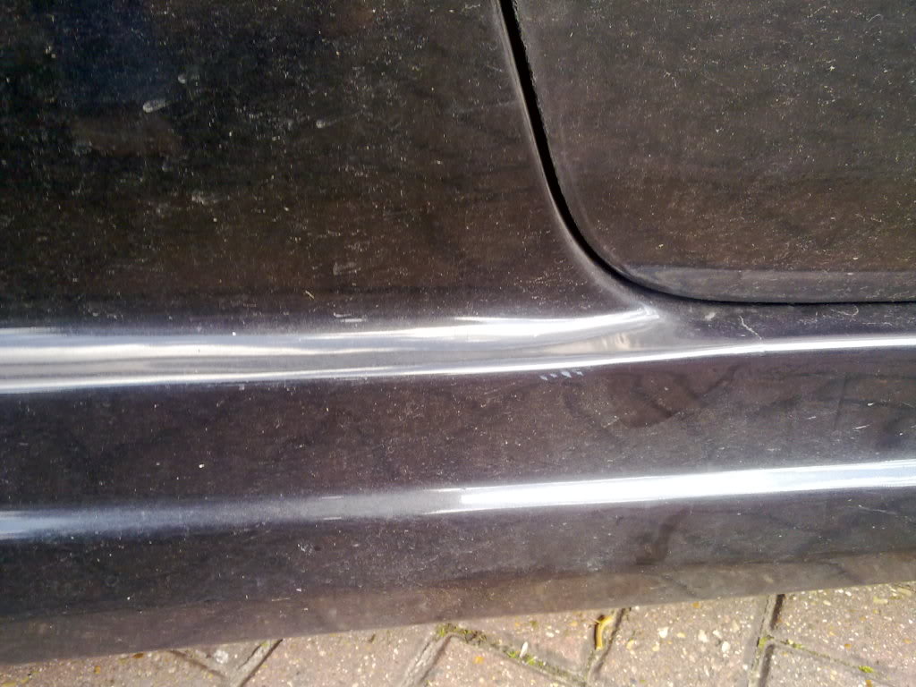

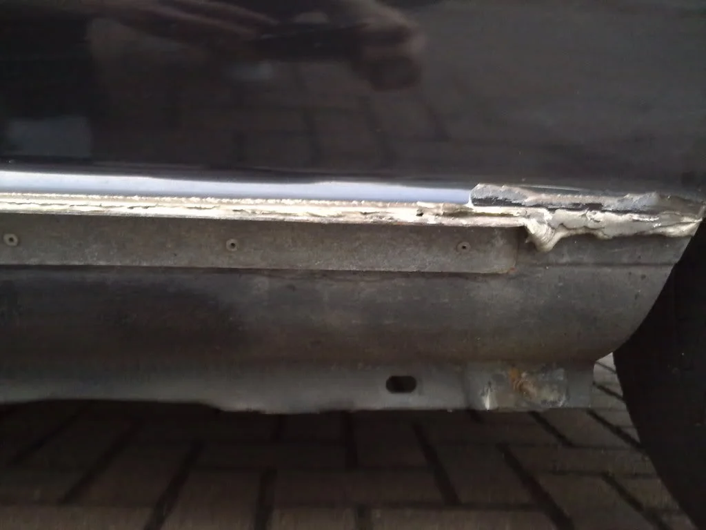

finally got some pictures of the skirts!
help me :(
held on by brackets behind and then have been smoothed and sprayed over :dapprove:
got a feeling that will need a bit of paint work on the bottom sides of the cars as when the you pull away the skirts it will need sanding
  Renault Clio GT 1.6
dam, should i do this before i put the rest of the kit back on? i really want it on regardless the damage of taking the skirts off. would sort out the paintwork when ive got the dosh

Suppose the only way to tell mate is to get them off!
Why someone would spend money on smoothing those onto the car is beyond me!

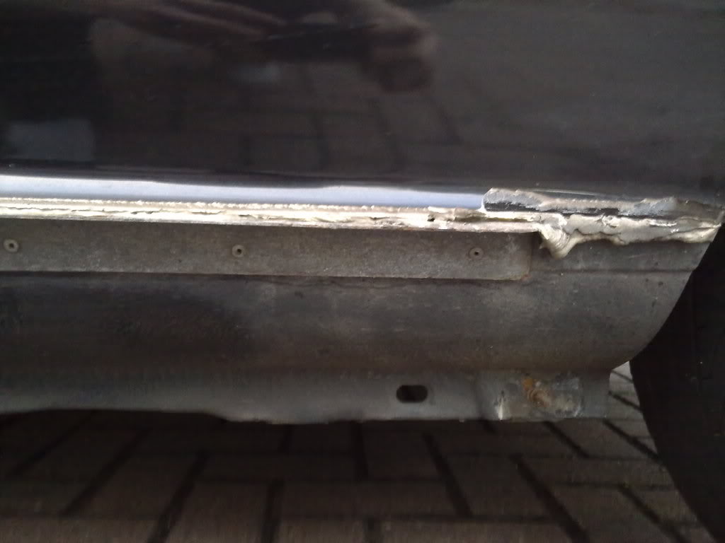

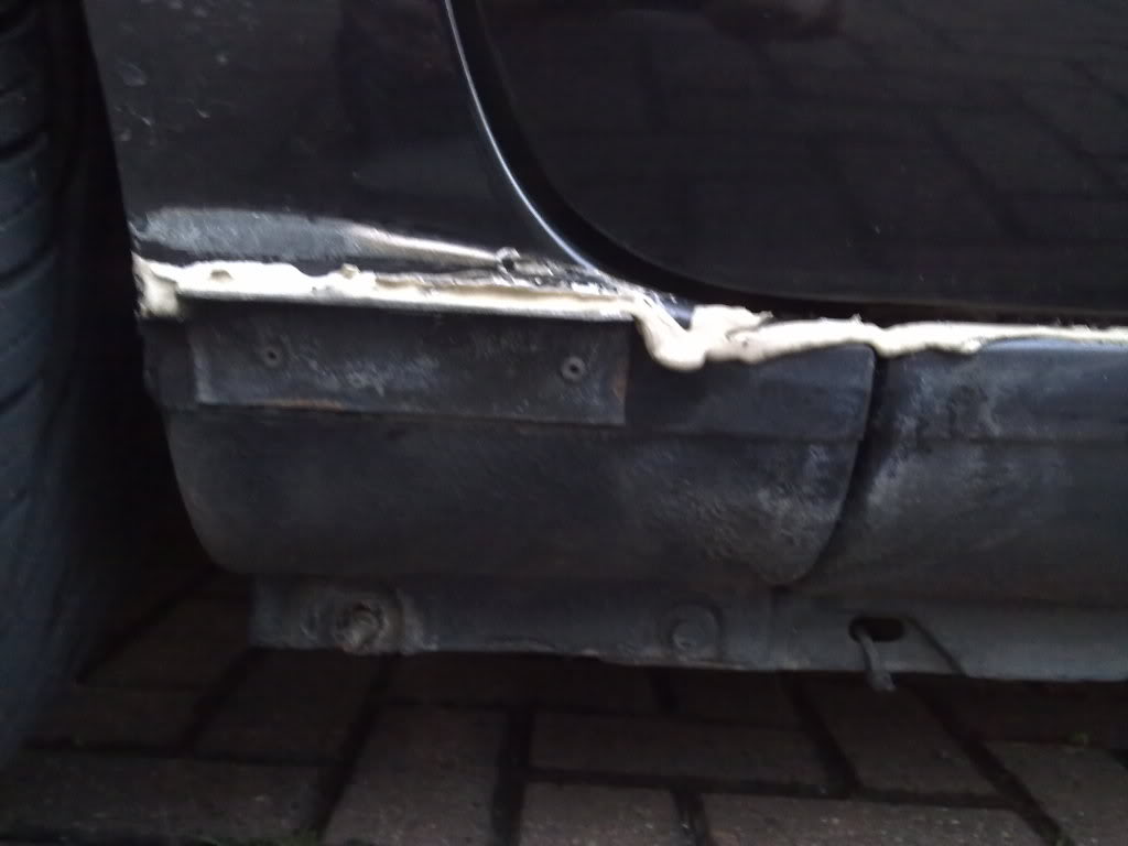

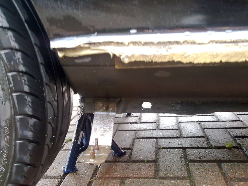

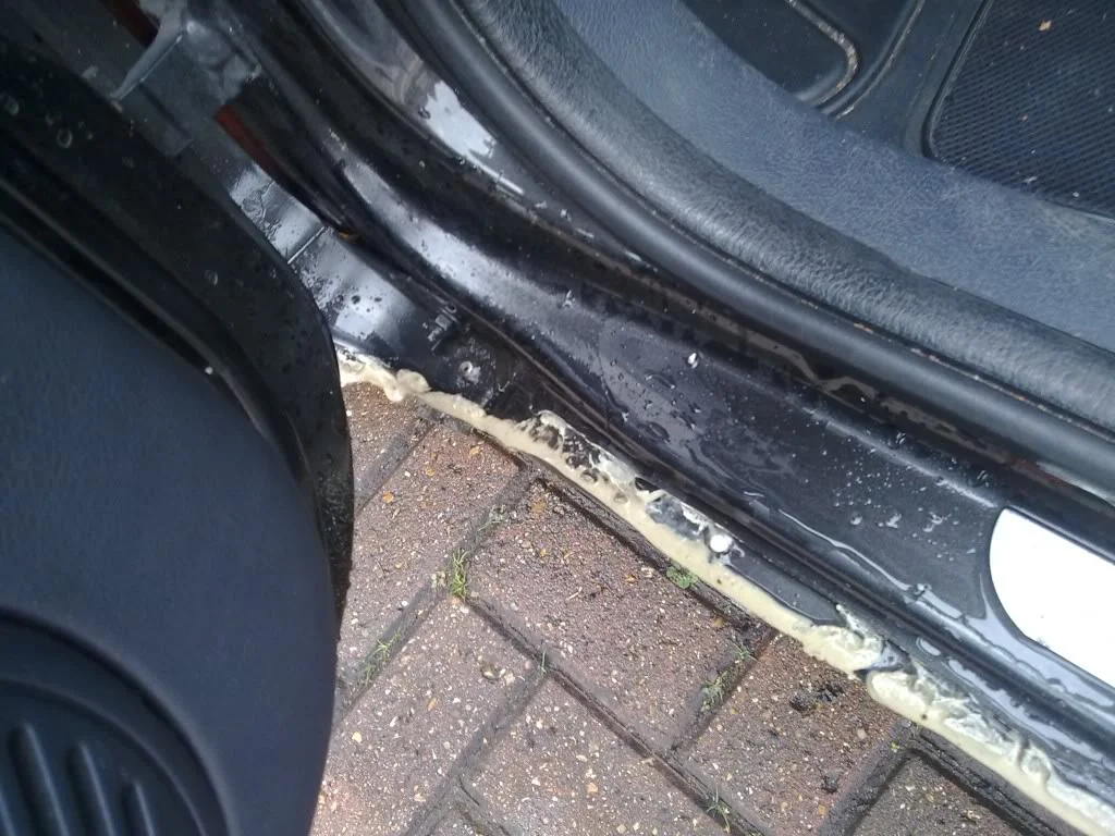

Skirts are off! not as bad as a i thought, especially as the actual sport skirts cover a lot.
Metal brackets have been taken off
will get the white adhesive crap off tomora, gotta feeling if i put a hair dryer up to it, it should fall off. anyone have any tips or anything about what i need to do to propa clean up the sides?
cheers, max
  Stagecoach Ticket
Safest way if you have no experiance with thinners and heat guns
is hair dryer and autoglym intensive tar remover , rags, blade will get most of it off mate you will cause some damage to the paint though just try and keep it as light as possiable.
Would be my method on a drive someone else might be able to suggest better though

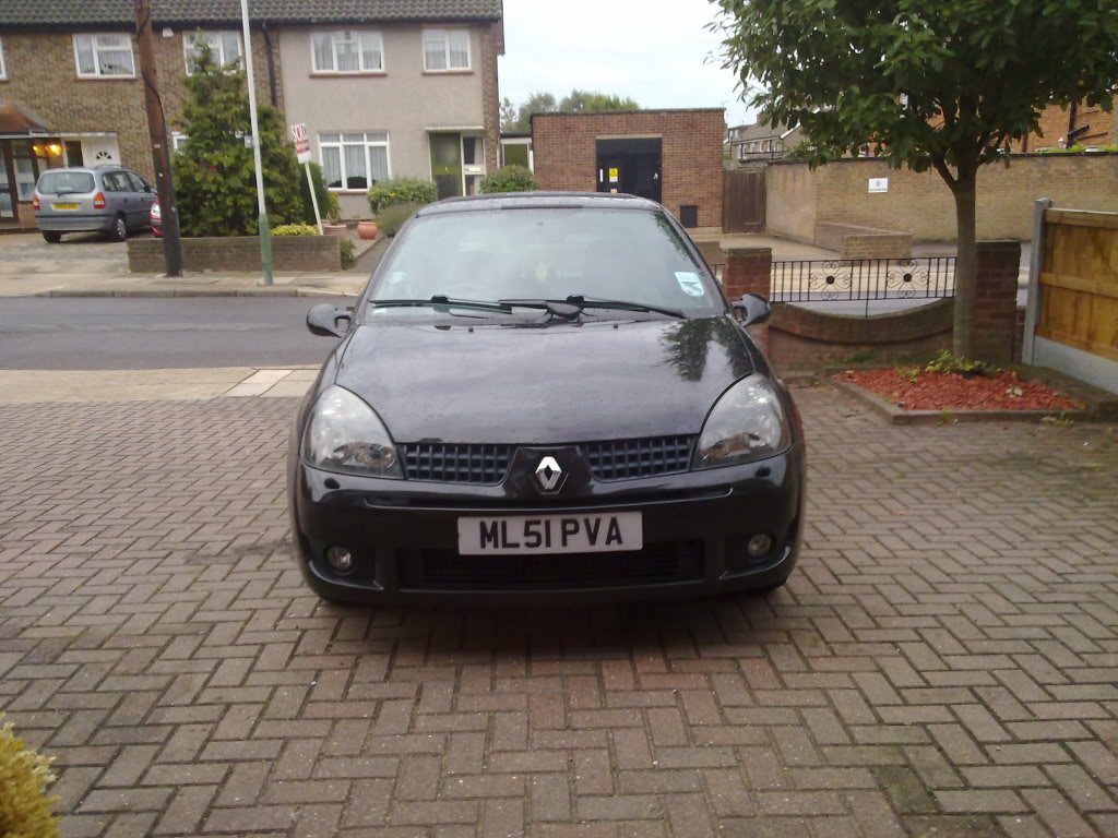

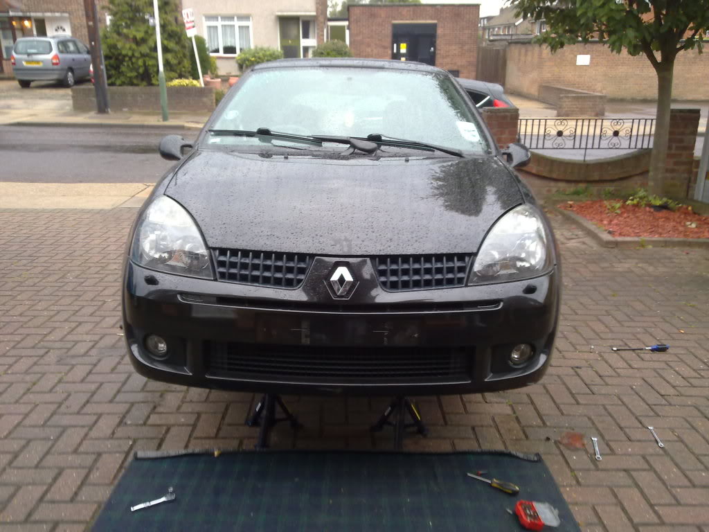

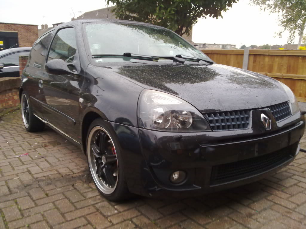

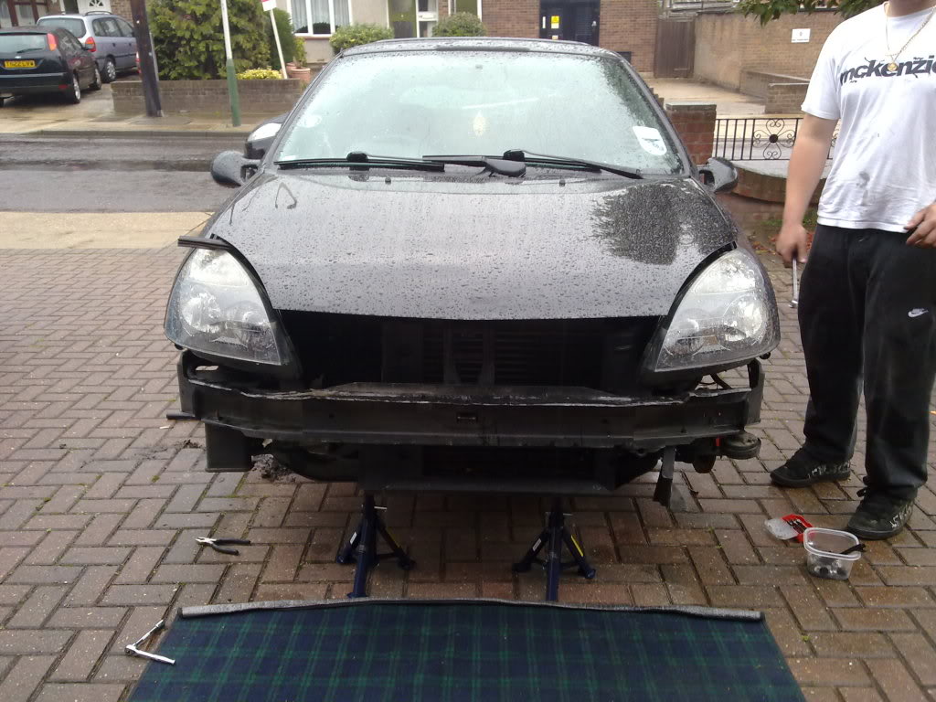

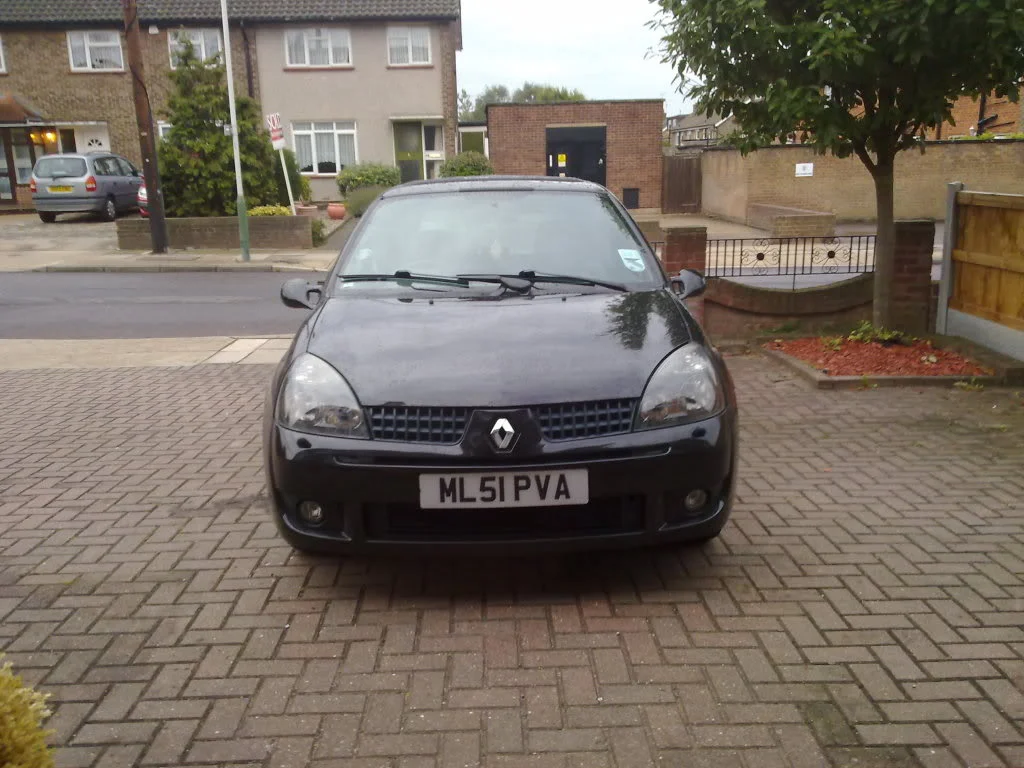

cheers, did what you said and got some of it off but got bored and decided to focus on putting the front bumper and wings on before it chucked it down with rain.
so thats what i did and got a few snaps before it poured down. shall take some better ones tomorra to let ya see the progress.
skirts still need to be done but shall be taking it to a body shop i know and getting them to do it there
no that is not me, its my friend who knows alot more about cars than i do.. ha
and just realised my window wipers didnt go on right... awsome! lol
skirts to go on soon :)

nearly there!
