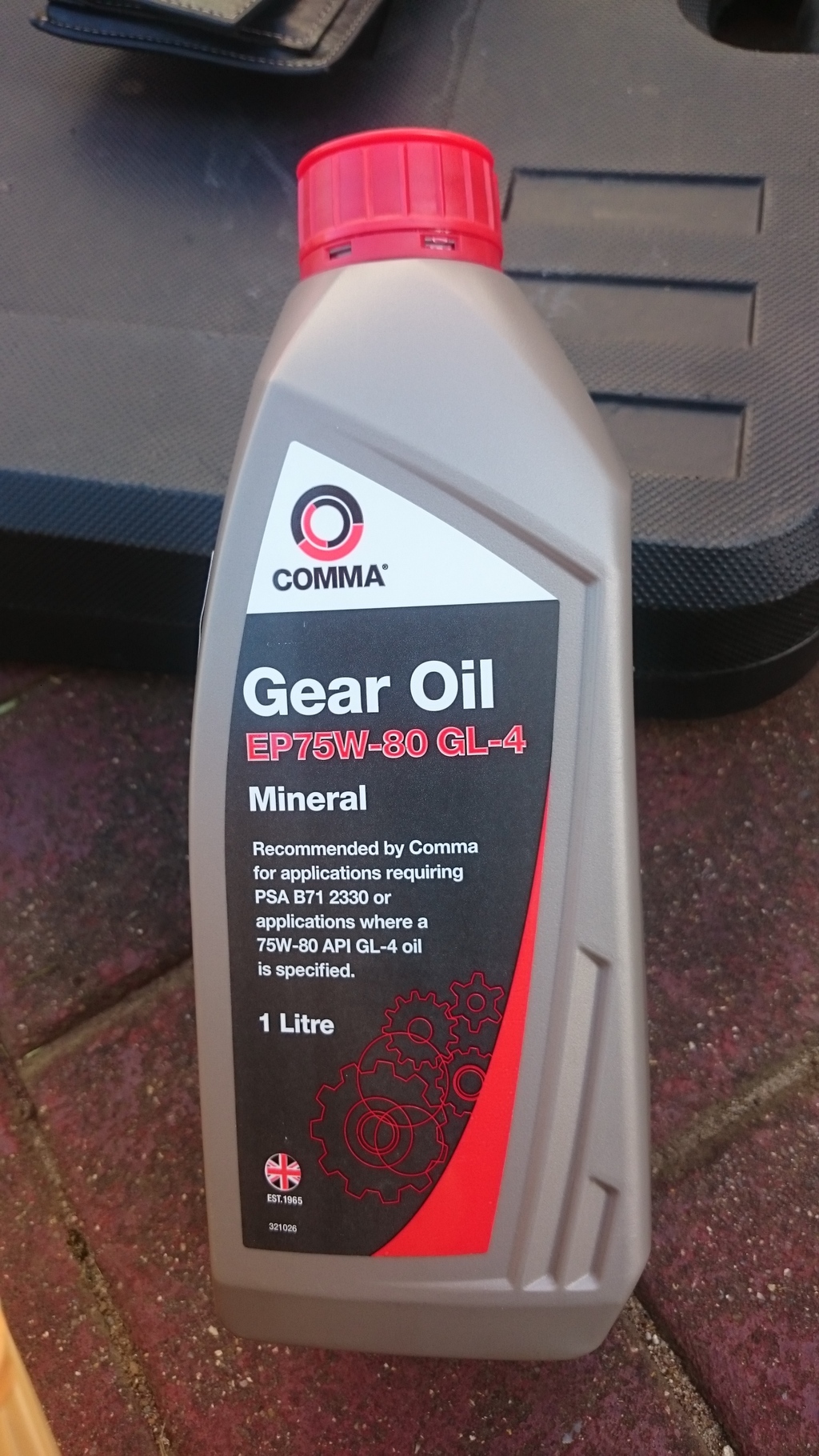

This is all halfrauds had, I don't care about brand just will this do without damaging the gearbox?
  Inferno 182 & Saxo
that stuff will be fine, comma arent too bad . Me personally id drain it all and add a fresh 3.1 litres or so, i find the some of the bottles have a little filler nozzle in the cap that you can attach to some hose and fill up via the filler plug, just make a hole in the bottle so the air can get it and it'll fill super quick otherwise you can be waiting a while
