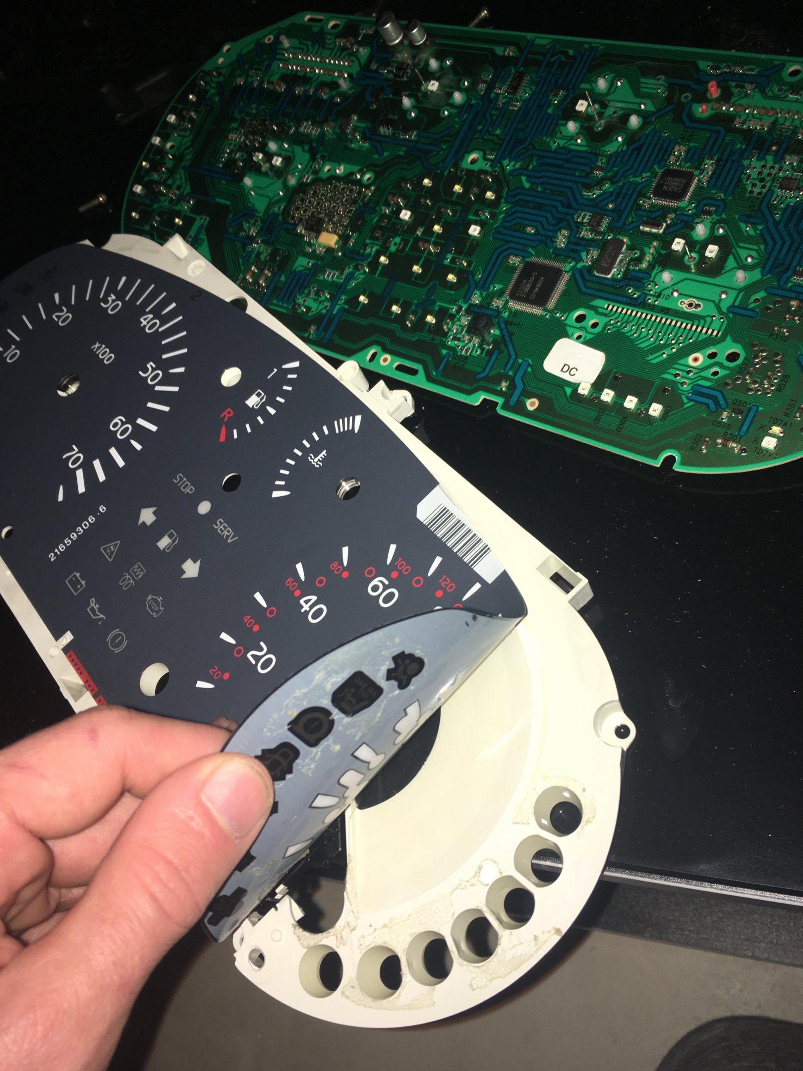

Ok so I am just seeing if this can be done/is worth doing?
I have some of the coating that covers the instrument panel coming away just below my EML. I thought it was black tape at first but after closer
inspection can now see it is the panel itself...
I realise this will involved taking apart the dash to remove the clocks but do not know if it is possible to buy this panel by itself? Contains indicator, petrol, EML, SERV, STOP lights
I planned to add a Handsfree phone kit, so will do this at the same time.
If I have to buy the whole panel including speed and rev counter, has anyone got a part number please?
Alternatively, can I replace using any instrument panel and just buy one second hand, or are these 172 ph2 specific?
Thanks in advance! :smile:

I'd just replace then whole thing as you'll have to pull all your needles off to replace just the black bit and it can break them anyway.
Plenty of used panels on Facebook groups from breakers. The panel retains the mileage of whatever car it came off so make sure you get one that's nearish miles

That's what I was worried about, the mileage. Would rather keep mine!
It seems to have a frame of some kind around it so maybe I can get a second hand one and Frankenstein the panel...

It's possible don't get me wrong. I've changed the silver trim bit for a painted one but didn't have to remove any needles for that
BoatNonce
I've pulled a few sets of dials apart. You'd struggle to break the needles IMO. Just get an ordinary kitchen fork, tape over the dials so you don't scratch the surface, then slide the prongs in either side of the needle and push the handle down. Sometimes the caps come off the centre but they pop right back on anyway.

Not breaking as in snapping, but i've seen people having problems with needles dropping weirdly etc after having them off and putting them back on. May aswell change the whole thing over and save opening it up
