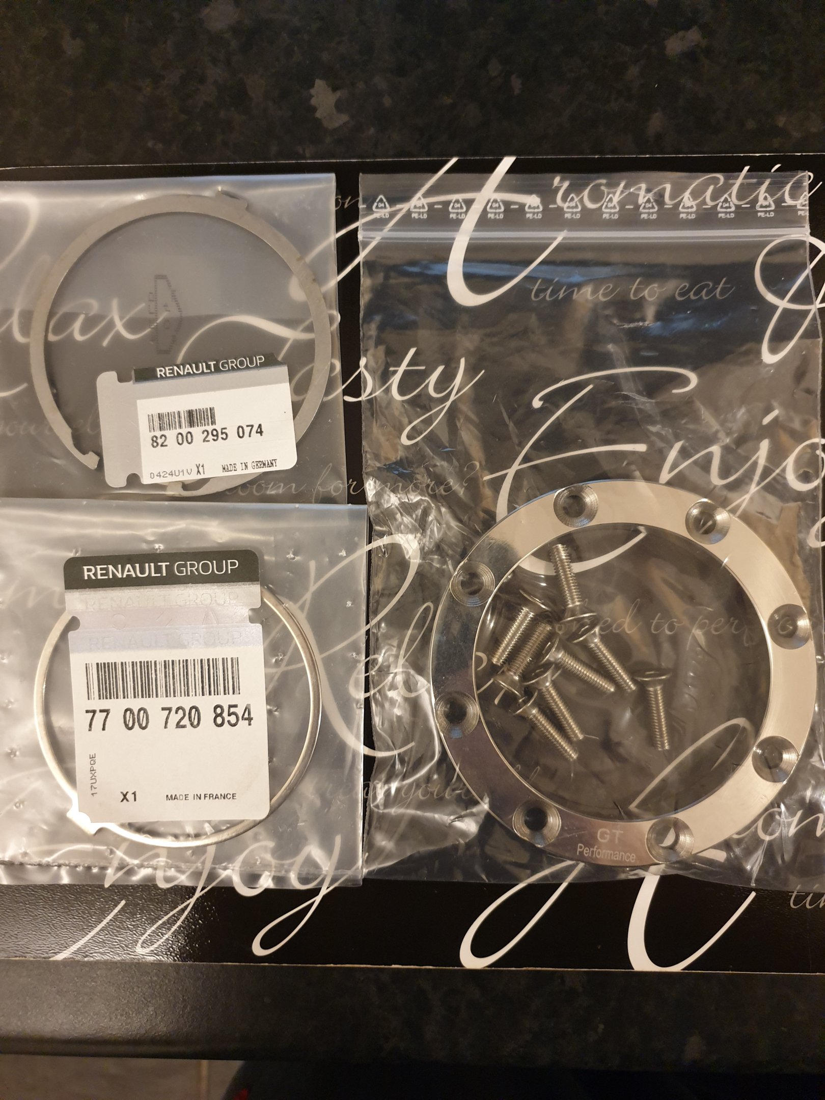

Ordered a Renfort plate and new genuine circlip after Saturdays circlip saga at Croft

Parts have arrived, just need to pop down the local fasteners for some 12.9 high tensile bolts tomorrow, get it stripped and hopefully wont find any nasties. Half expecting the box to be knackered with my luck lately.

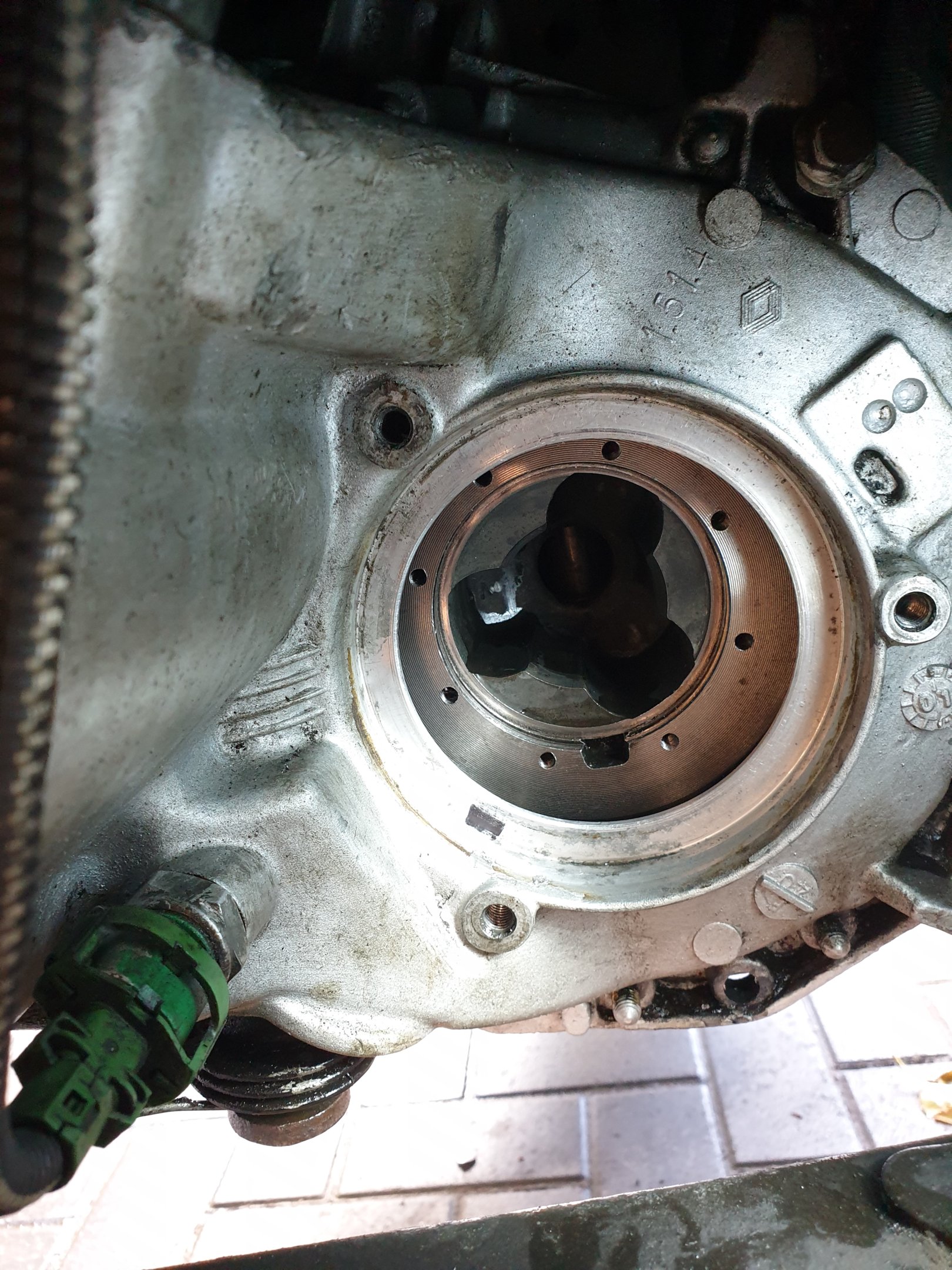

Stripped down and ready to fit. Ballache to get in with a drill. Have borrowed a small drill see how that goes.

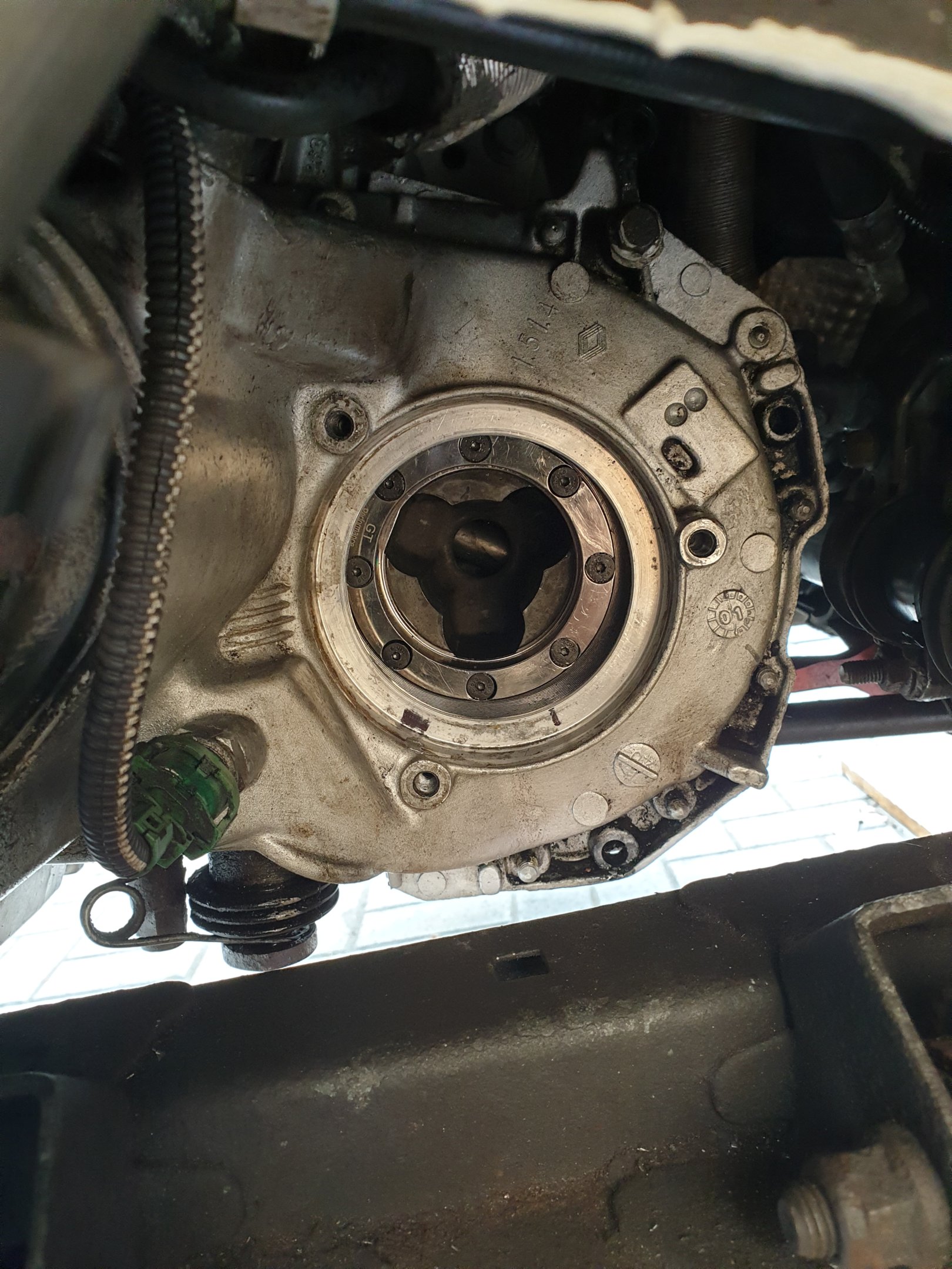

Job done. Bolts are countersunk M5x0.8 and 20mm long.
Not the worst job to do, hopefully permanent fix. Quite a bit of endfloat in the diff, spacer shim is fitted and same thickness as the snapped one. I checked a spare low mileage jb3 and it appears to have the same large endfloat so assuming crap tolerances from new?
