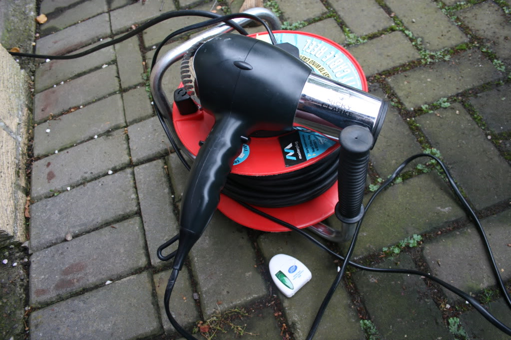

If it was in a Haynes Manual I would give it Half a Spanner. You will need dental floss and a hair dryer;
- I also used white spirit and T-cut but this is down to you.

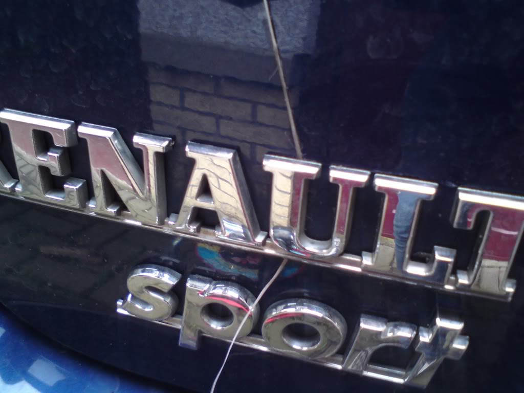

First of all you need to heat up the badge a fair bit (not enough to damage the paint) with the hairdryer. This will soften the glue holding the badge on. Then gentley run the dental floss behind the badge. I recomend holding the floss vertically and moving along the badge horizontally as shown;

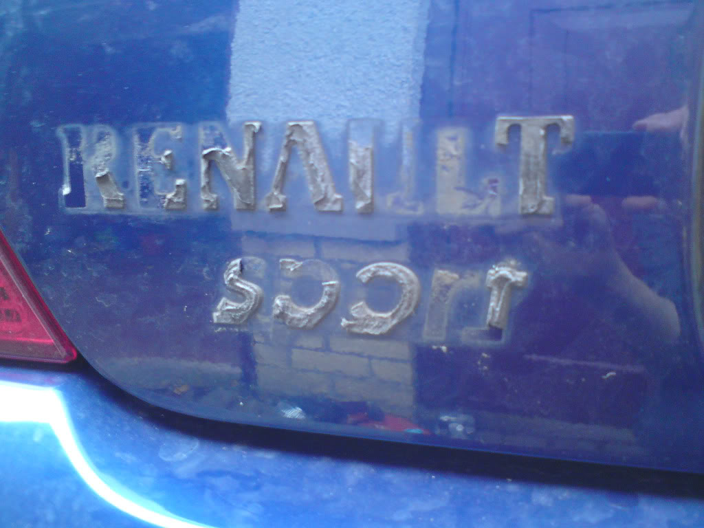

This will leave a fair amount of the double-sided sticky pad and dirt as shown;
I then gently peeled as much of the sticky pad off as possible by hand. This left this;

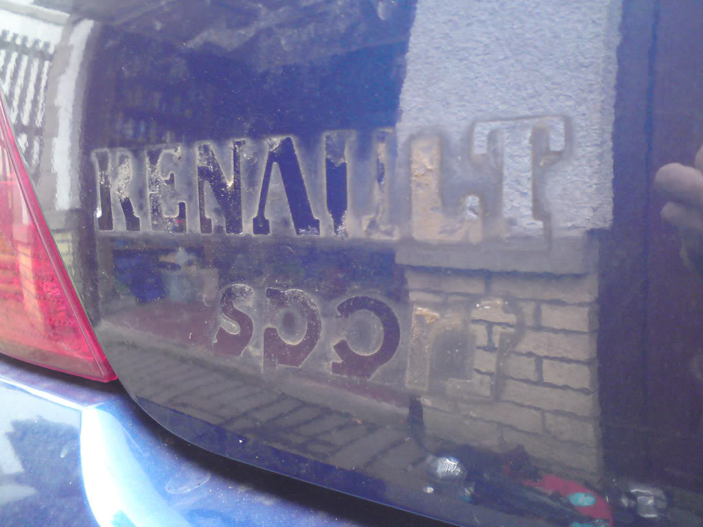

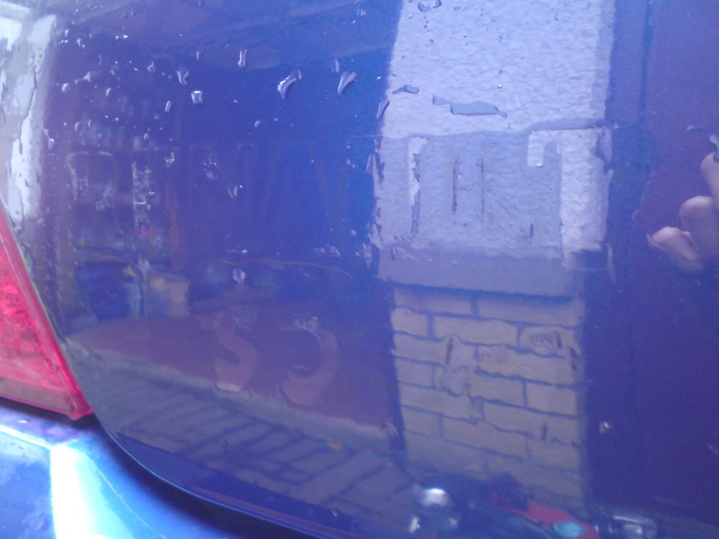

I next wiped over the area using white spirit on a soft cloth. However it is better to use a tar remover such as Meguires, etc. This left the area looking a bit cleaner. However upon wetting the area there is clearly alot residue still left on the paintwork;

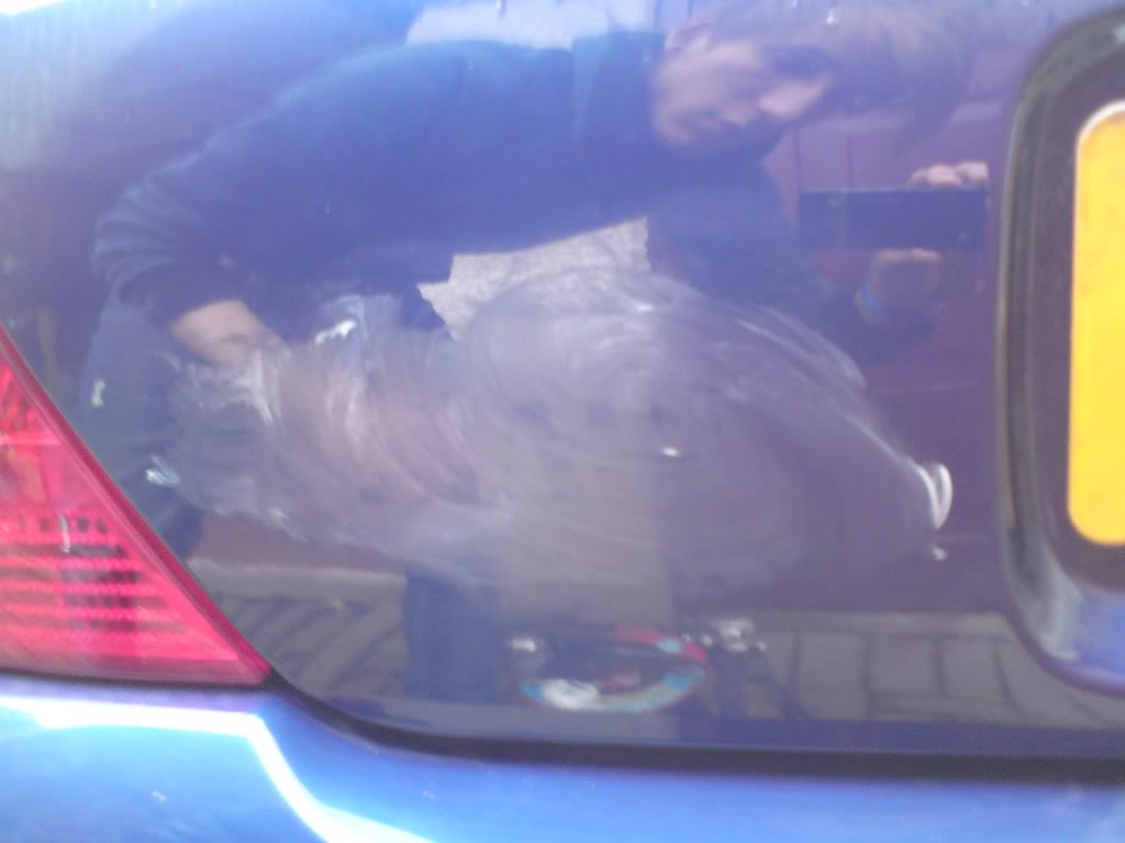

I used wiped over again with white spirit and it left a similar residue. Next i used T-cut. Again I would recommend a better product but this is just what was lying around;

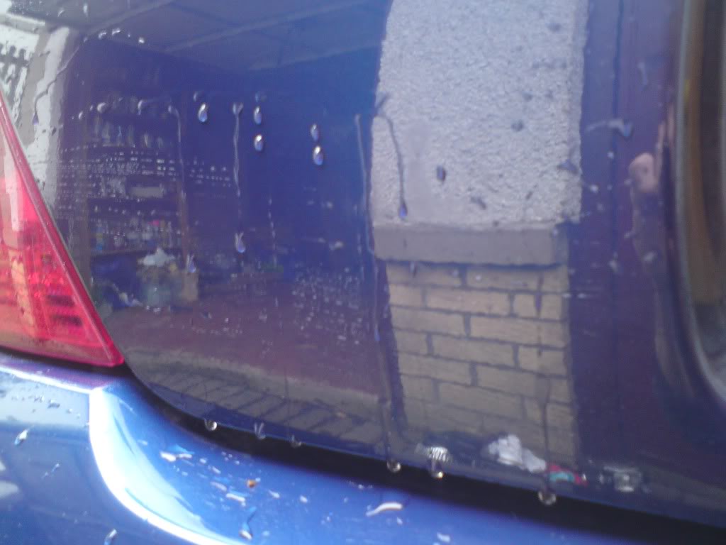

This was buffed off by hand and then the area was wetted again;
Normally I would then polish the area to finish the job but as you can see my car is filthy so the polish will come in the next couple of days when I give the car a proper clean. The results I achieved were good, the job took about half an hour and i used the most schoolboy set of tools and product possible...except for the hair dryer, that's a serious machine.

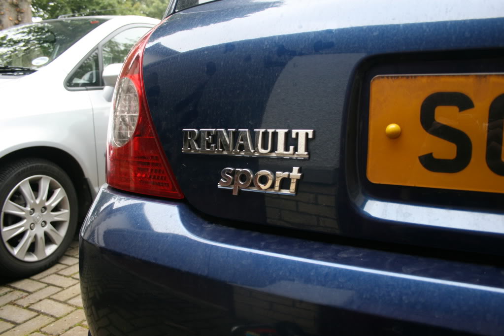

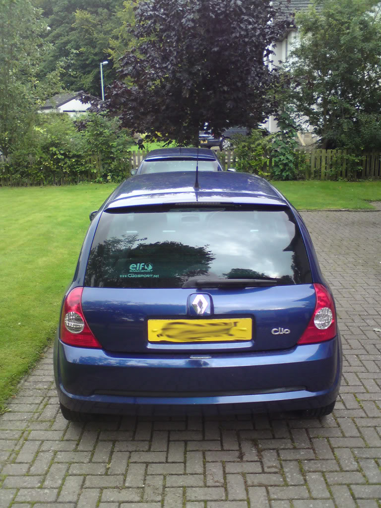

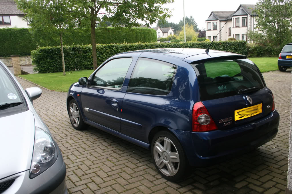

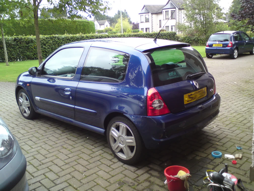

Before;
After;
