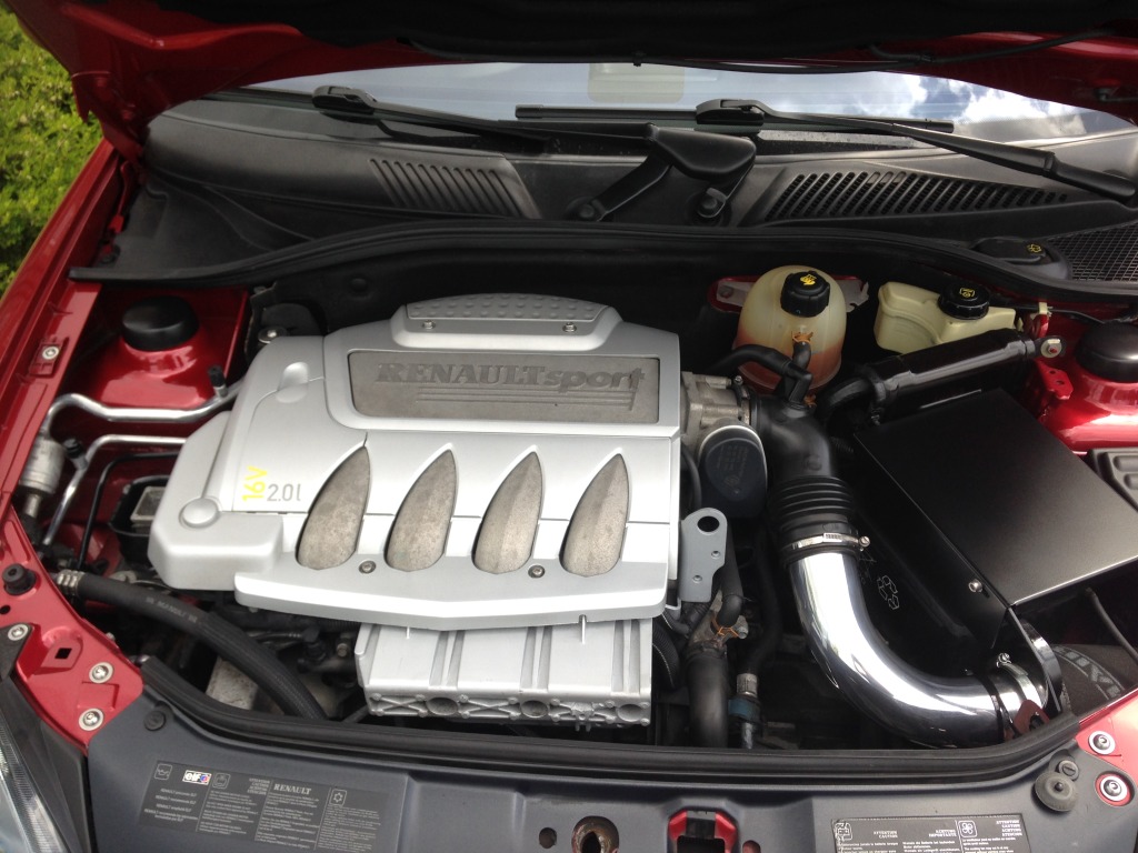

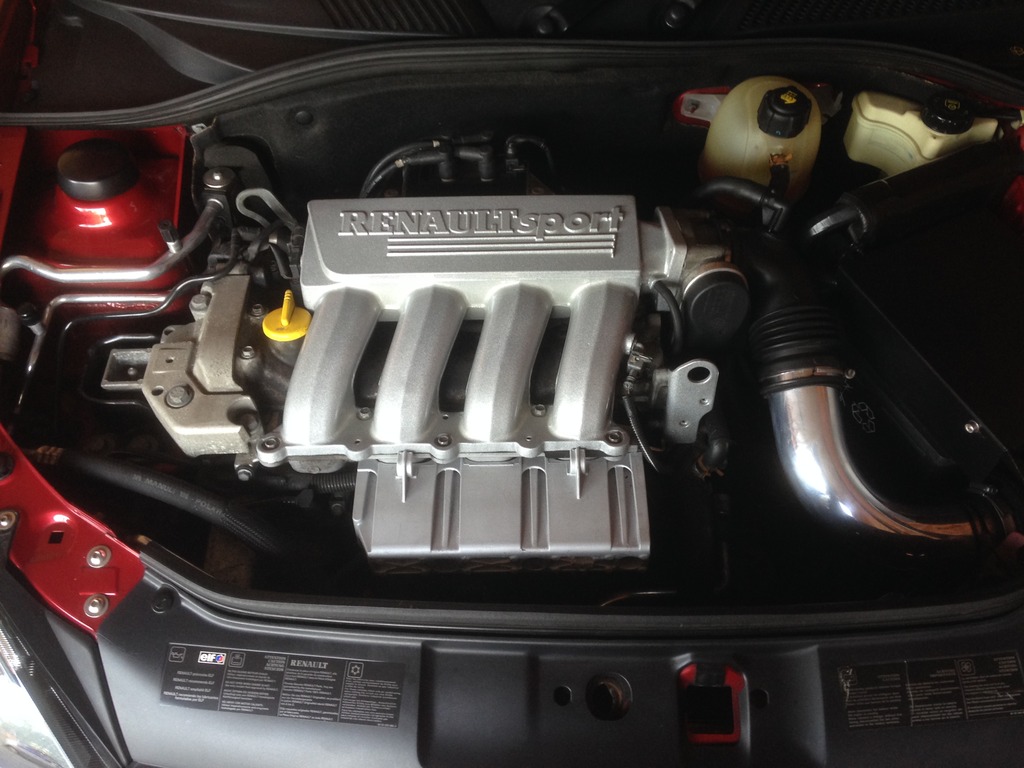

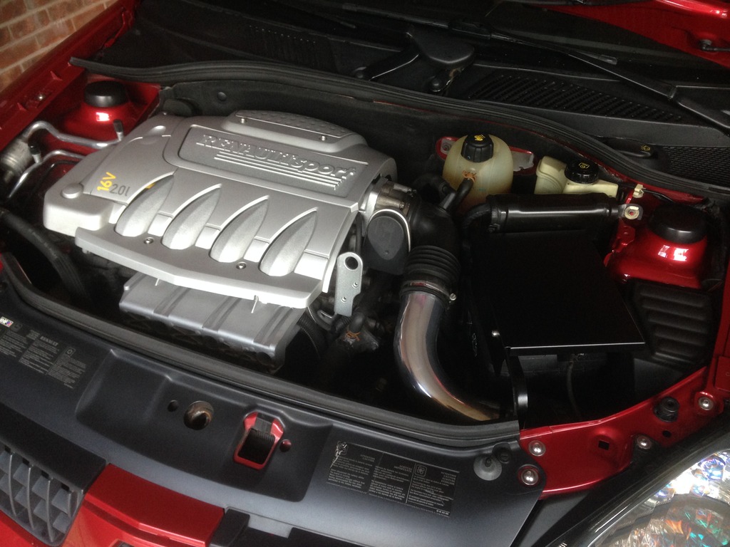

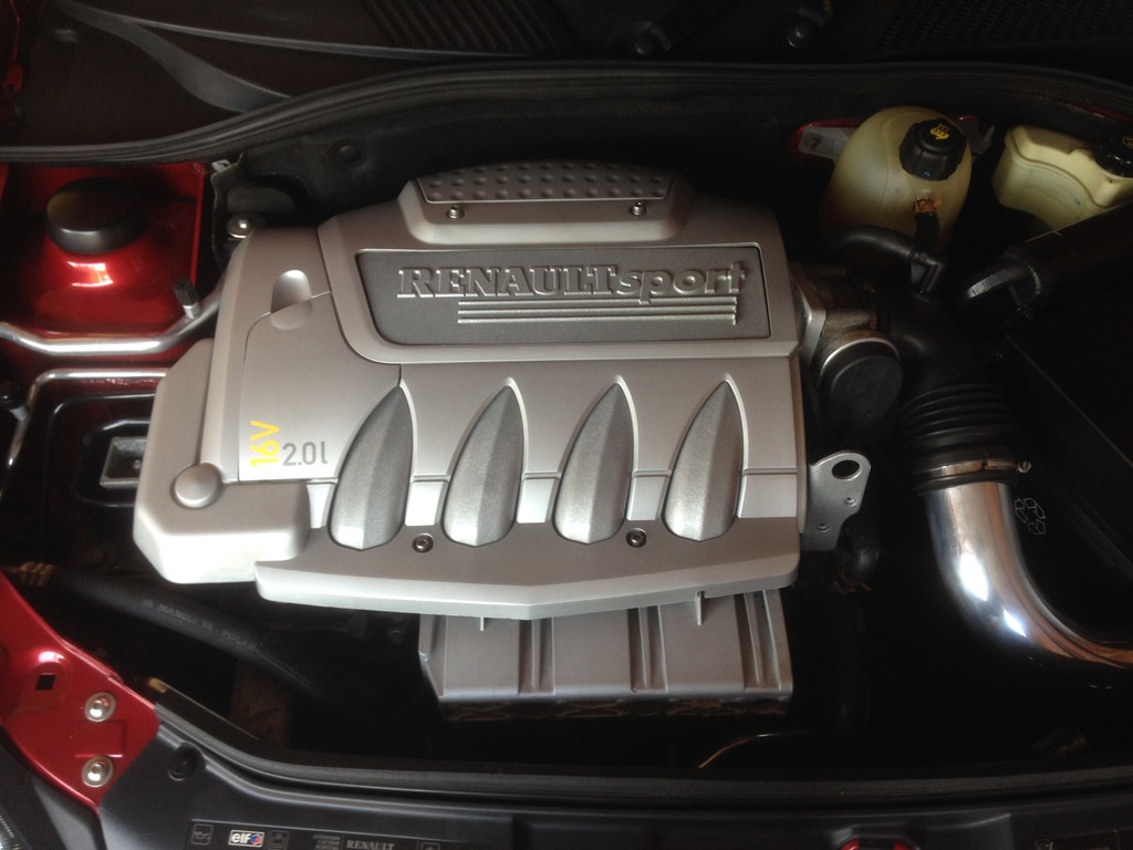

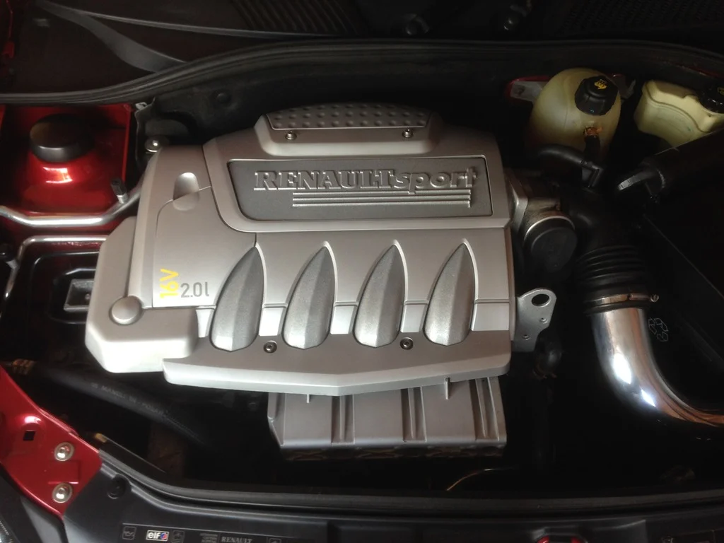

All sorted. few pics to show the difference, not the greatest but you get the idea!
