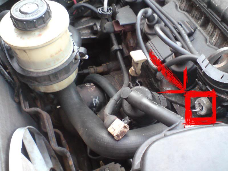

I neede to replace this on my 1994 1.8 RSi....

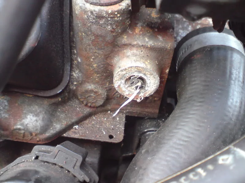

Got the old one out no worries, when replacing with new I got carried away and snapped the bloody thing off flush with the block :(
Any ideas/help with removing it so i can try again ????
Thanks Keith.....
  Renault Clio RSi Mk1
I have tried hitting a flat blade screwdriver into it (as it has a solid resin core) and then turning that....No luck :(
It does seem stuck..
Thats gunna be a real nightmare to get out then! Maybe drillings the only way to do it but gunna be a pig to get at it
  Megane Team II F1 R26
If you have enough room and depending how wide it actually is, rather than drilling out i would get some thin pliers, and drill 2 small holes a good couple of mm apart, insert pliers, grip and twist like a key.
Failing that its a drill out job :(

Will try that at the weekend...Cheers :cool:
