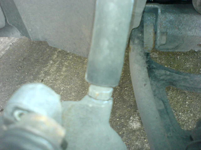

I'm outside removing my brake calipers (god bless wireless) do I take the brake fluid reservoir off the caliper or off the end going into the car?
Thanks!

Should I be taking this off??

Brake fluid reservoir on a caliper ?? Just undo the brakeline going into the caliper mate . Get plenty of rags ready for the fluid that will spill out , then either used a clamp for the brake line of stick something in the end of the pipe to stop it leaking out .
And whatever you do " DON'T " get brake fluid on any of the paintwork , its as good as paint stripper and will fcuk it up bigtime .

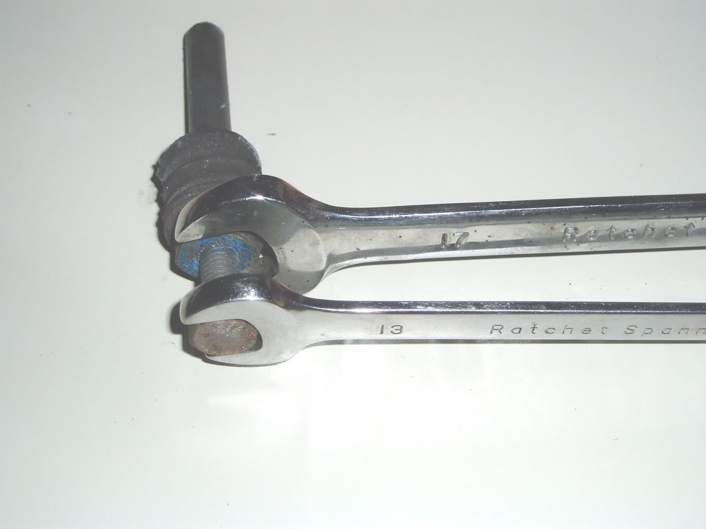

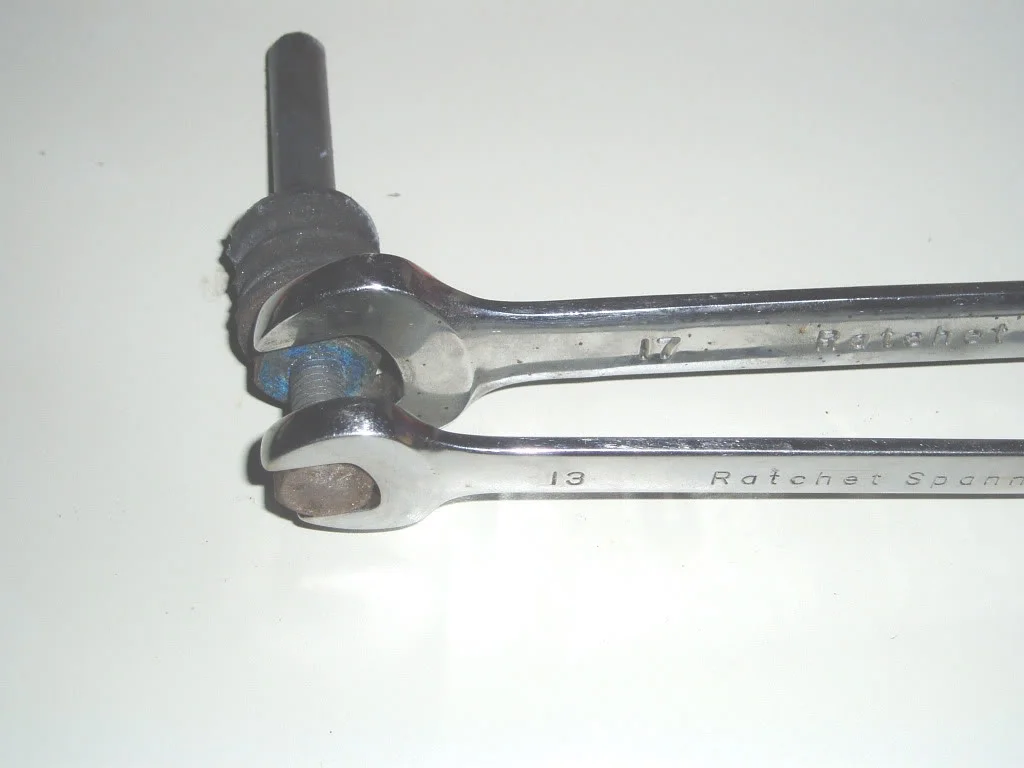

13mm and 17mm spanners to remove the caliper mounting bracket to replace your pads .
