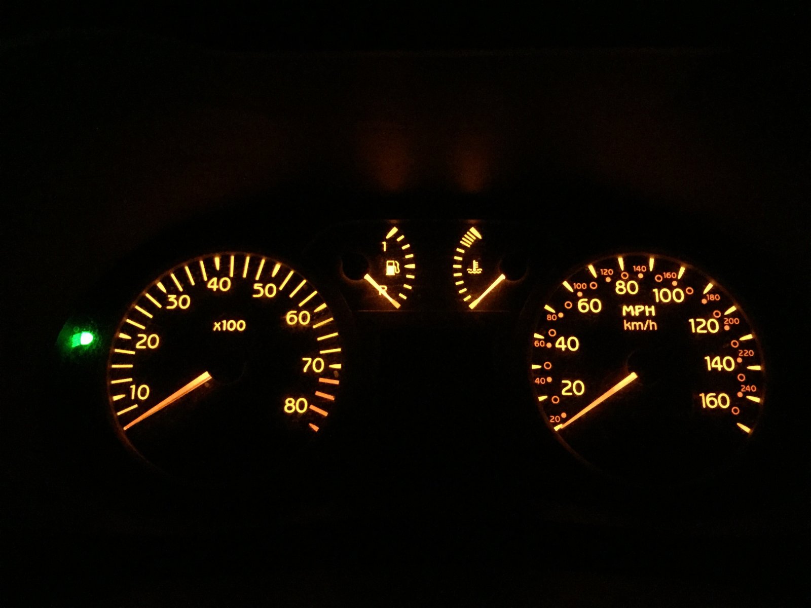

Yeah didnt touch the batt. Car runs, drive etc fine. Headlights /rear lights work, indicators work, radio works. Dash illuminates, shows that the headlights are on, but revs, speedo, fuel, temp dont work, nor do rear brake lights.

Nothing mate.
This is the car running, and only just been out in it so temp and fuel should move, and mileage should show.
And all interior lights work.

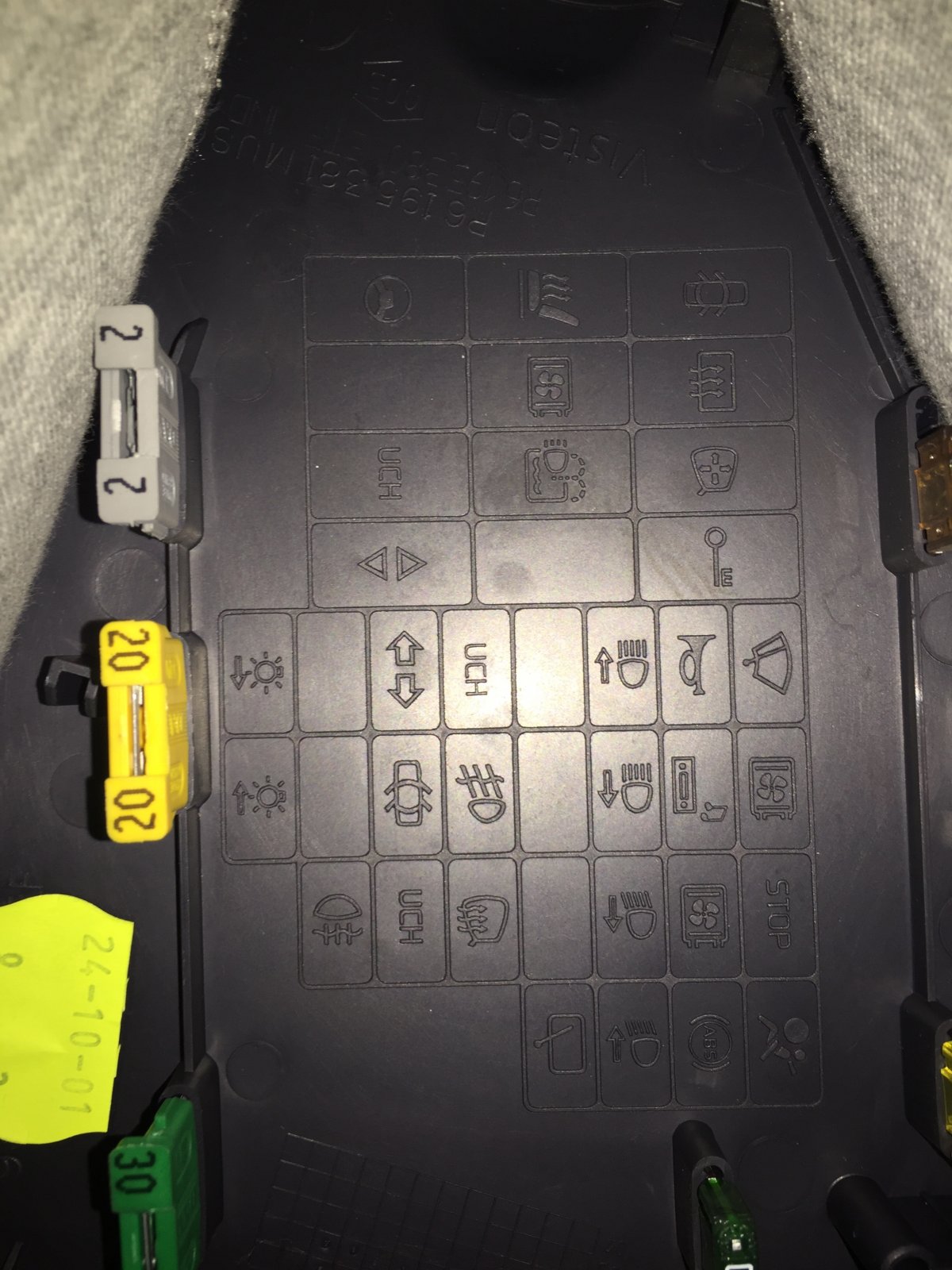

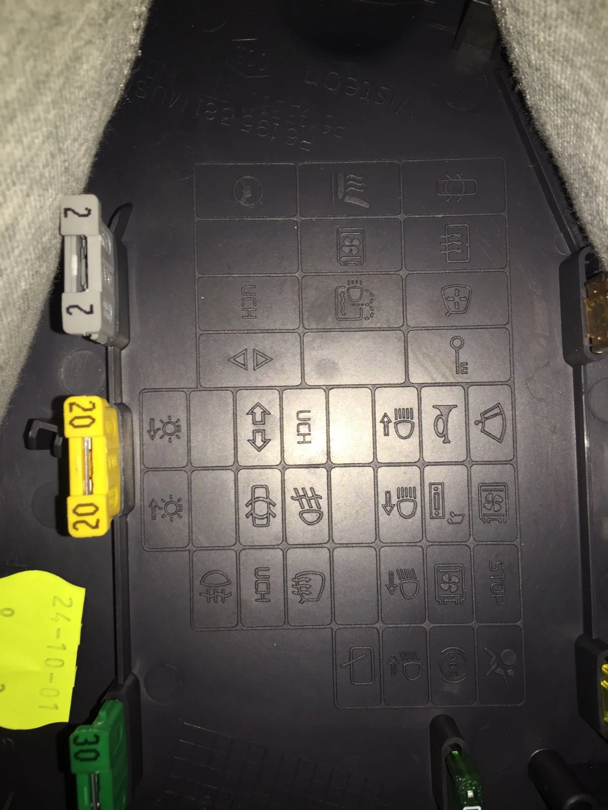

Nothing obvious for interior/rear brake lights

Check your relays underneath the glovebox mate. Or take out each fuse individually to see if broken.
Louis
I Park Like a C**t
Relays can do funny things. Just check all fuses whilst you're there. Shine a light on them from behind, it's easier.
Stay Puft
  Clio 172
Relays in passenger footwell? What am I looking for? I hear all the normal clicks etc on first turn of ignition.
