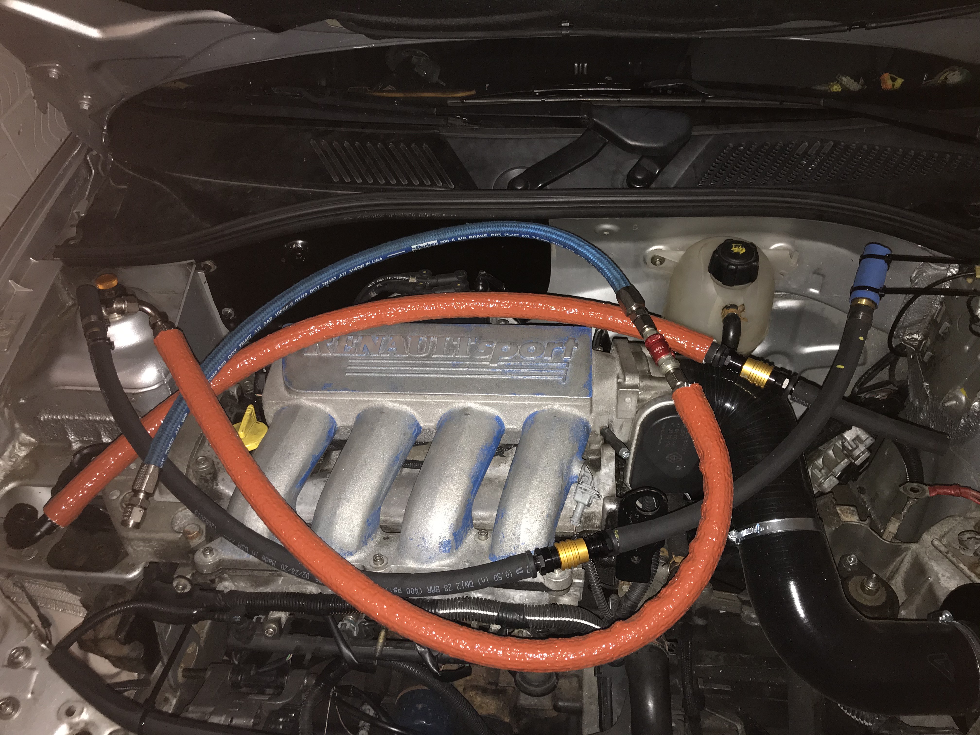

Yeah stock hoses aren't great, these will do the job 😄 Will be able to take out the whole pas setup without any mess, not cheap though o_O
MLB
Wow those are some serious hoses, must cost a pretty penny!
