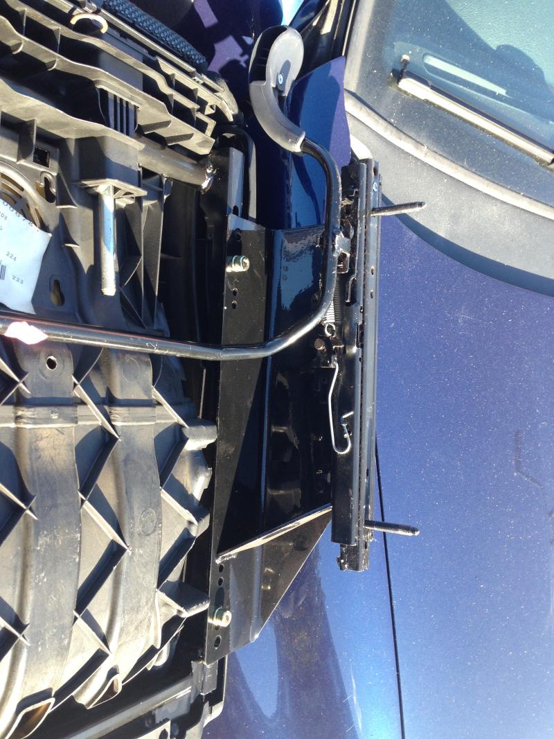

Thats the view of the bottom of the seat, the two silver round bolts are the ones that fasten the seat to the frame.
you could also go under the car with a deep 13mm socket and remove the whole seat +frame and rails.

A pic of your runners would be good as they may have been bodged in and not used the correct sliders or adaptors.

Thanks for the picture man, great help. Im not really in a position to rip the whole frame out but ill try the Allen/Hex first.
I'll throw a picture up in due course, though I can't imagine that would be it, they've been functional for the past 2 years.
