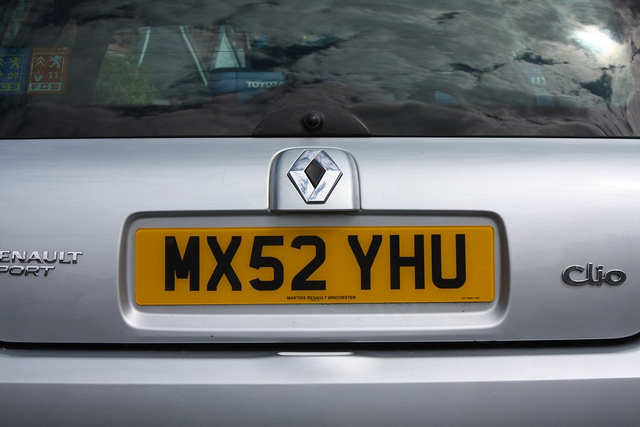

I just cut mine off with the dremel.
IMG_7498 by fletcher10, on Flickr
£1.80 for a pack of bungs from Halfords. Job done!

that looks a lot nicer i must admit. noticed you have the newer renault sport badge two any tips where to get that from apart paying renaults prices lol
