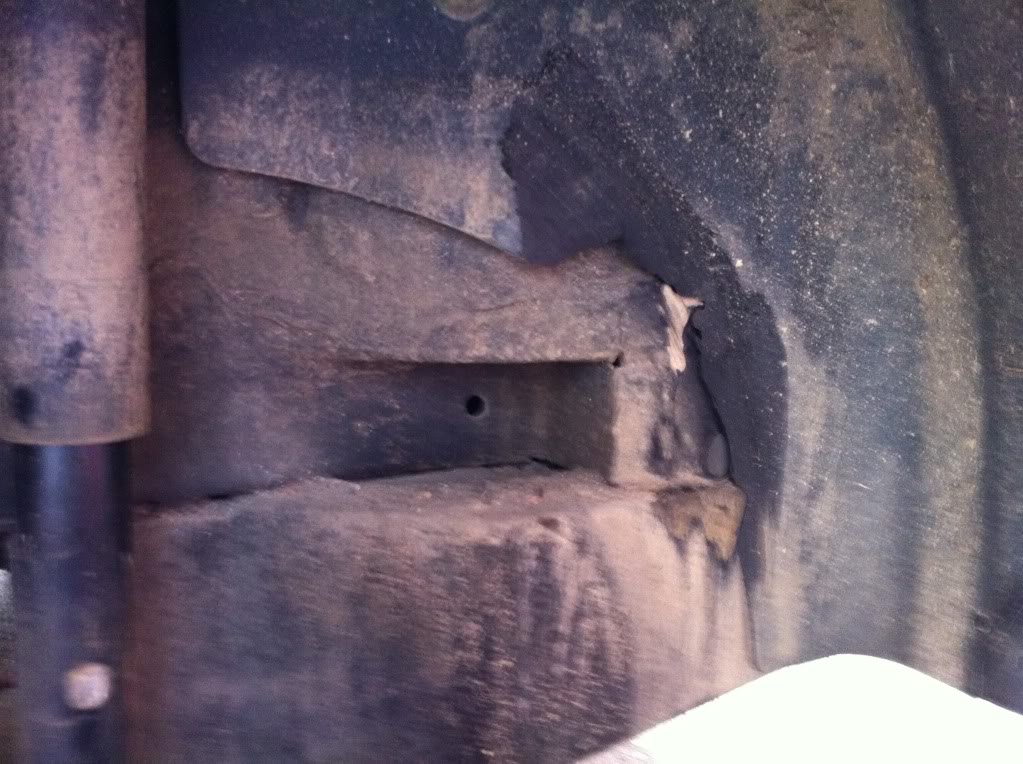

Started to rub behind the liner aswell.

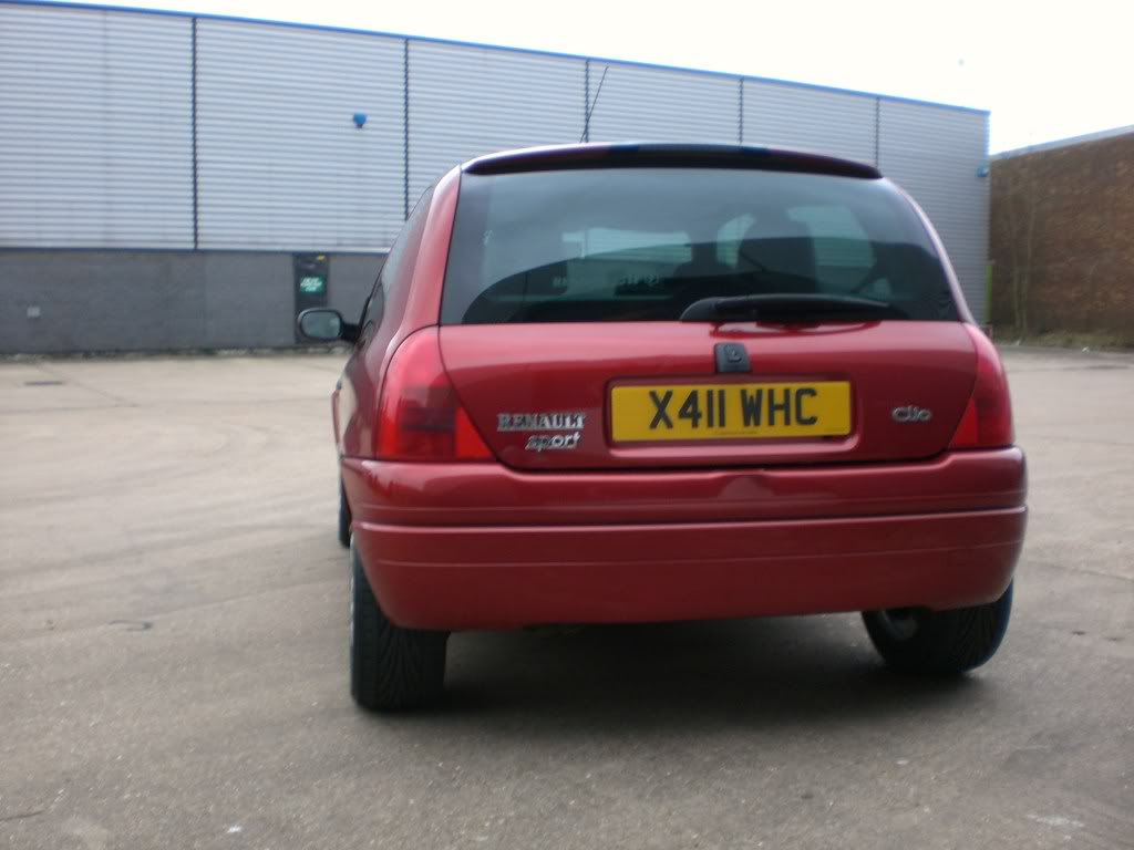

and you can make out the camber in this shot.
