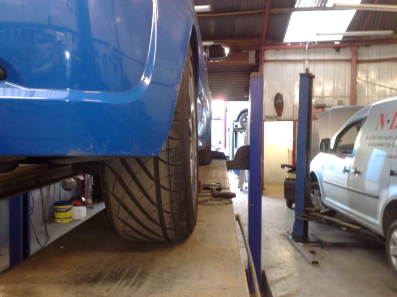

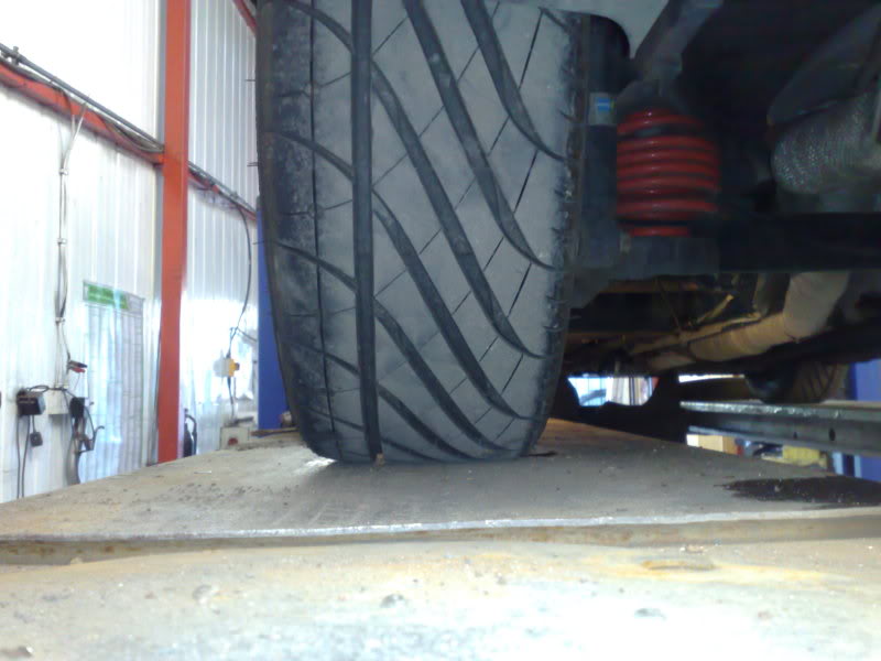

i want to get rid of my negative camber as mines only a roadcar. the wheels lean in but only a bit but the evidence on the tyre shows 3-4mm of the outside edge is not touching the road.
Washers are surly a bodge job? the stub axel wouldt sit flush would it?

This is my rear tyre. you can see the outer edge is not touching by 5cm. no play in bearings and no damage to rear beam.
could i get camber shims and install the upside down to reduce the negative camber?
  alien green rs133
thats a bent beam almost put money on it, or tyre design
Gez
  Yozza'd 182 RB 188bhp
bent beam? with exactly the same wear on both tyres? surly not?
There is no obvious damage and no stress marks on any joins.

  Lionel Richie
does look a bit excessive on 2nd look, bet it on a 4 wheel laser alinger and check the tolerences, don't go trying to "fix it" with shims
  alien green rs133
the beam can bend and you wont see any signs of it on the beam just with the camber of the wheels ill see if i cna get pics of the beam on the rally car atm its mental :D
