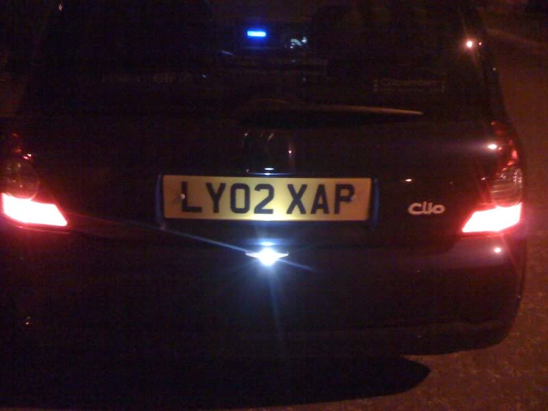

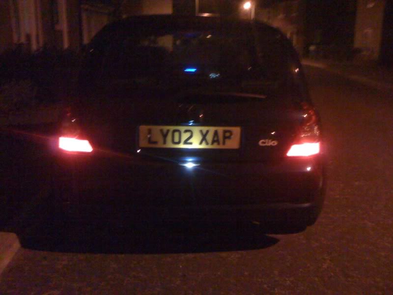

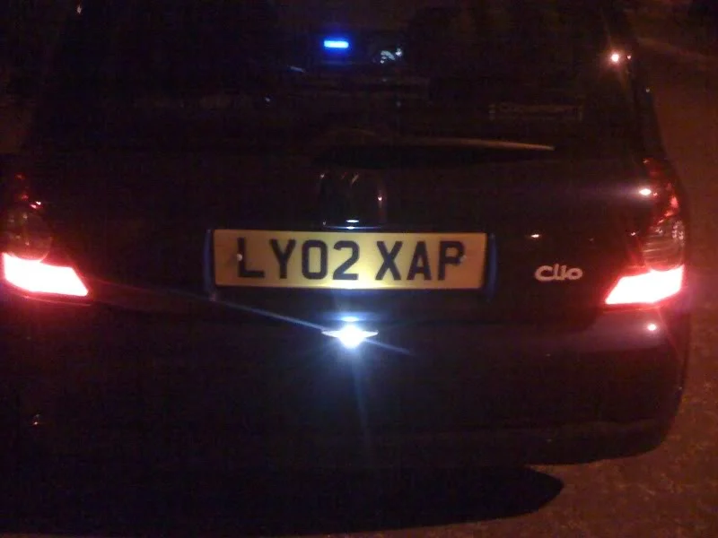

I made my own custom number plate light holder thingy (the black bit at the bottom)
Went through to of them and this one is waterproof and the clips wont get corroded/break...

Guy at work had that grey bulb holder lying around and I said "that'l fit!!!"
Spent an hour one friday afternoon knocking it up..dremel, plastic and hot glue/sealent = happy days :) Havent had a problem since (about 2 months ago now)

Cheeky cnut of course it does! in fact you pissed me off so much I HAD to go take a photo to put your doubt in my engineering skills to shame! ;) .....

Oh yeah, it does work! ;)
