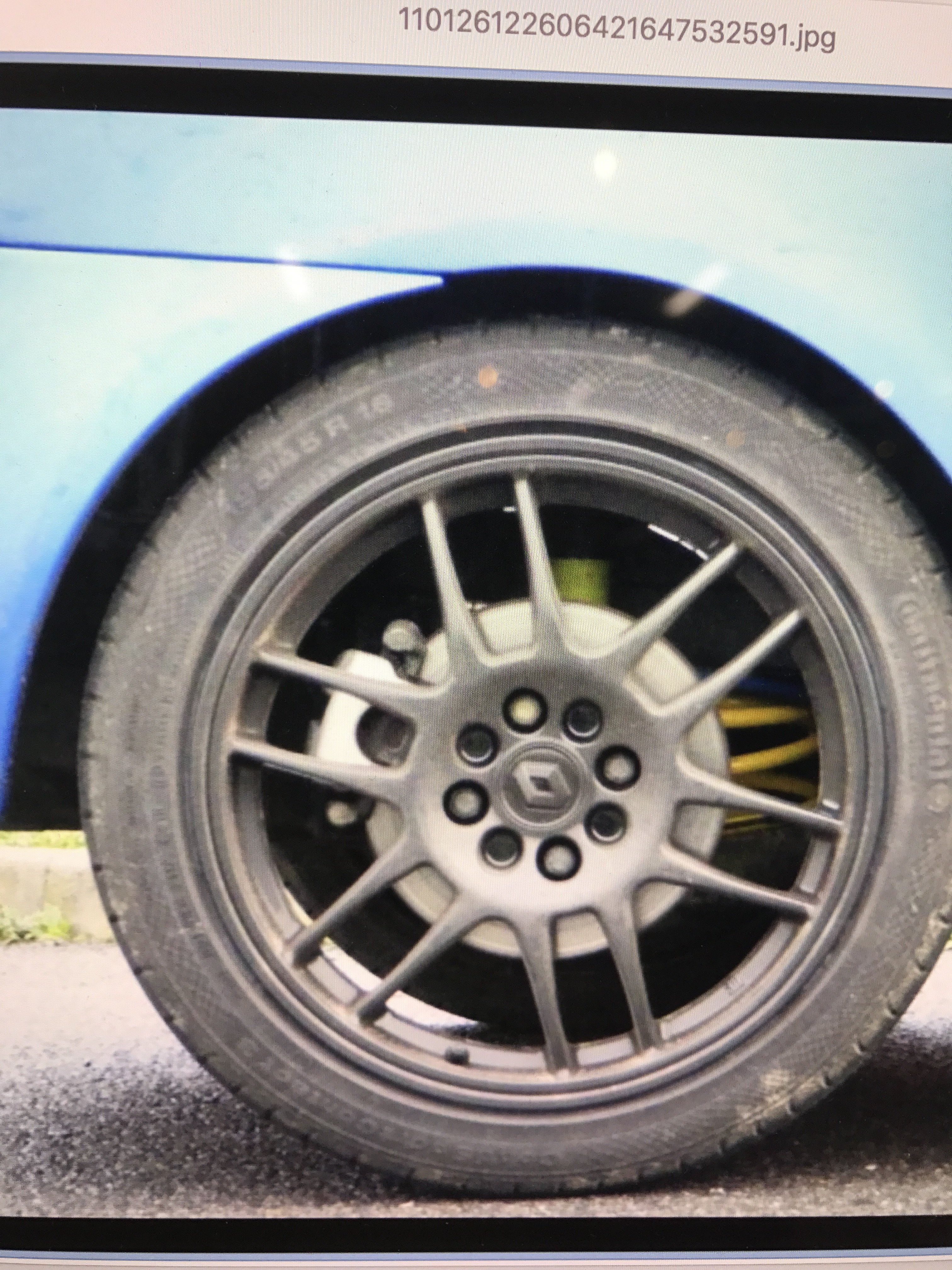

  182
Noos has done it by the looks of it. But the calliper doesnt look like it's mounted in the same place ad a 197
Has he just made a custom bracket?
That way you could keep the standard set up
  182
So if you wanted to keep the abs. The only thing you can do is make a custom bracket on the existing hub to mount the carrier...
