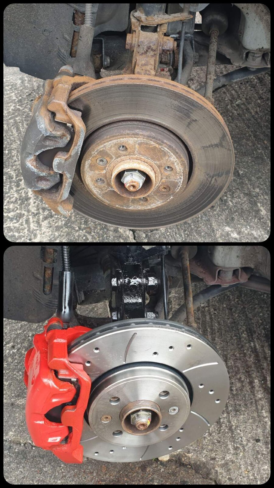

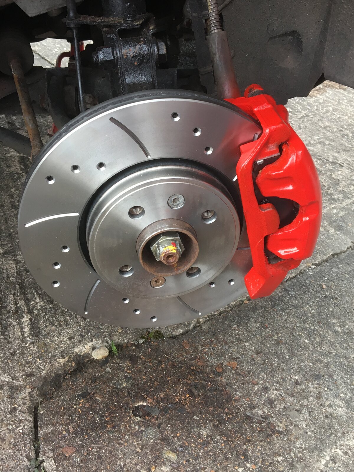

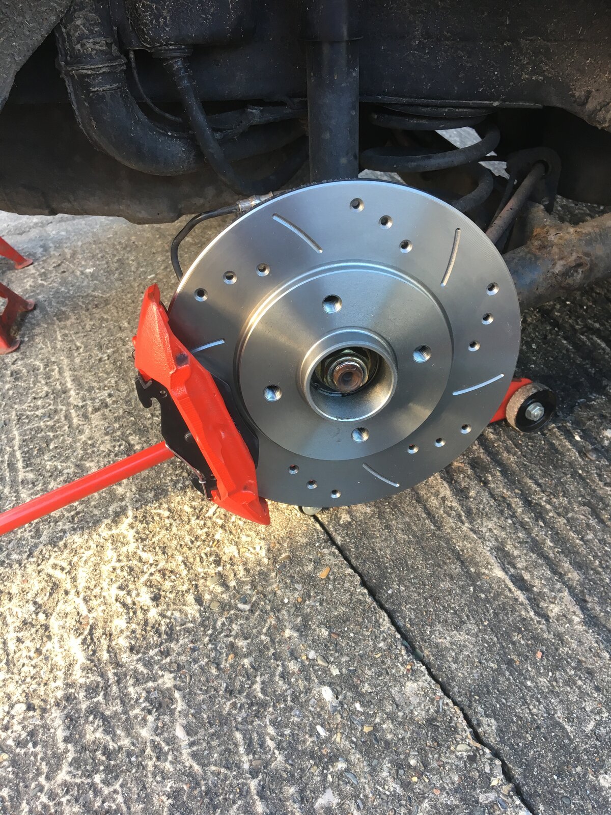

  Clio 172 Ph2
I purchased MTEC drilled and grooved discs for the front and back when I was refurbing my Clio this summer.
£50 for front discs £94 for rear discs with 44 tooth abs ring and bearings prefitted.
I’ve got ultimax front pads and brembo rear pads. Different pads due to availability locally.
for general road use I think they are great.
The ultimax pads are lower brake dust versions for less alloy mess.
