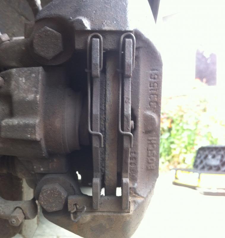

These are the bolts facing that I wish to know the torque setting for please
Can I also ask... the picture above you can see the pad facing away from the car has a locating tab in the middle. That's supposed to slot into the piston isnt it? as that's what I've done on with my new pads.
  SQ5
Yes those rear pads are the wrong way round.
Those two bolts are the carrier to caliper so 40nM

Them pads are in ok as all the pads i fit they have knobs on all the pads.

Those where the old pads chaps, The new ones I have the tab sitting in the piston each side then the flat pad facing outwards each side.
Ok 40Nm for the big bolts, whats the 100Nm figure for?

I would have though it would be 100 for those bolts as 40 isnt a lot the spark plugs are toqued to 40 iirc. i dont know for sure but seems a little low to me
allthough i would say they are caliper to carrier bolts.
