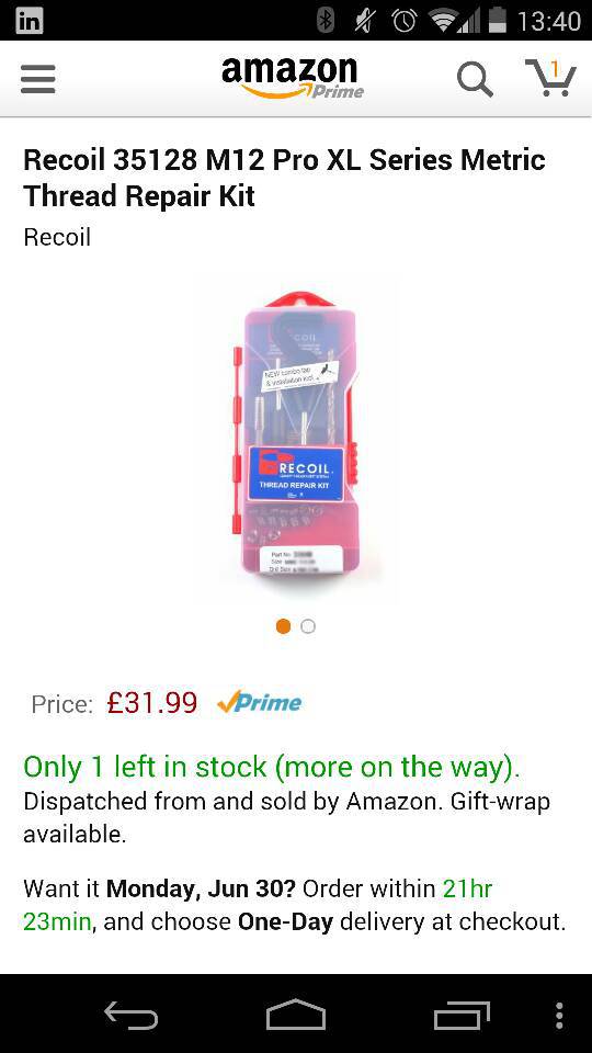

I believe the bolts on Renault are metric, so for completeness and future reference, here's the recoil kit I'm going to buy to fix this....
"Recoil 35128 M12 Pro XL Series Metric Thread Repair Kit by Recoil"
http://www.amazon.co.uk/dp/B00GSPDE90/?tag=cliospnet01-21

That's what I thought first, and probably what I'm going to end up doing anyway. Although the recoil product is more than adequate, for this situation a longer bolt and a nyloc nut + washer is cheaper. Plus as I'm fitting an ARB, I need a longer bolt.
