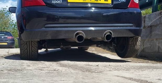

Jack up one of the rear wheels and see if it lifts both or just one. Then you'll see what it does.
Whether you want one or not is a different question.
sburrell93
Scotland - South
Can see the difference they make if you jack up the rear of a clio with one fitted. Can lift the whole rear of the car easily jacking it only on one side, instead of it leaving the other wheel on the ground.
