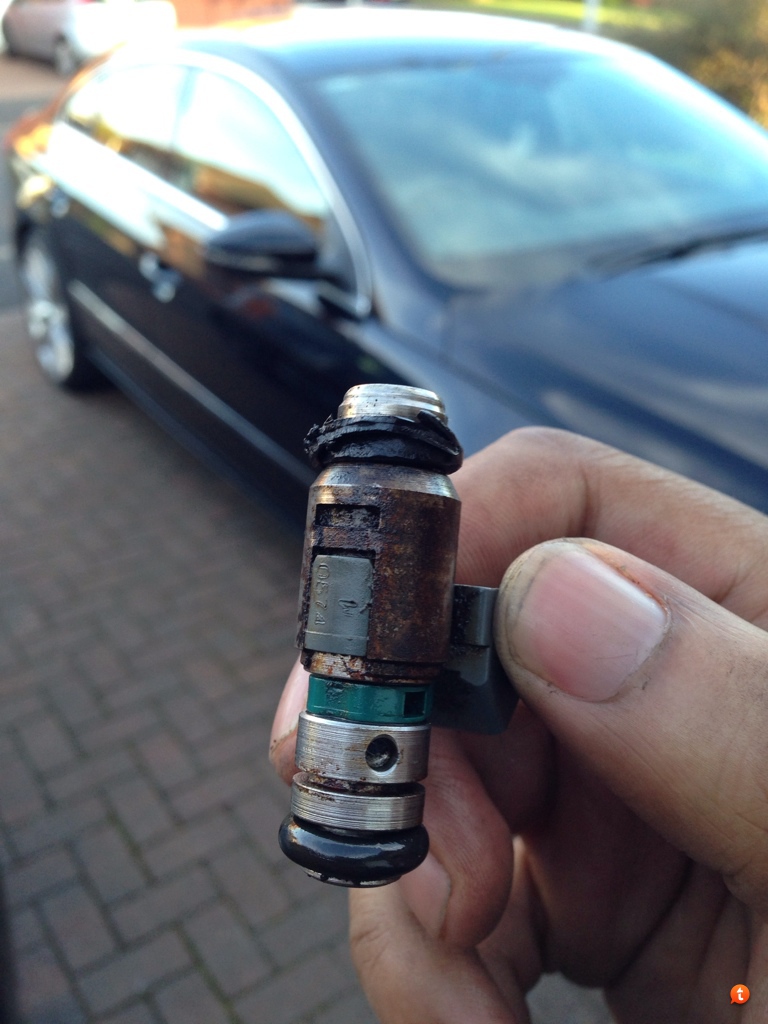

Just swapped over an injector on my 182 which has sorted the misfire at low rpm problem I've been having recently (many thanks to Leew88!).
The old injector came out with a pretty busted up seal ring (see pic below) - could this have been the cause of the misfire and not an actual fault with the injector itself? If so, where can I get a new ring?
Cheers all! My local Renault specialist wanted £65 to diagnose and then £105 to replace the injector - sorted it out via CS for a grand total of £15 - well happy with that!!!
