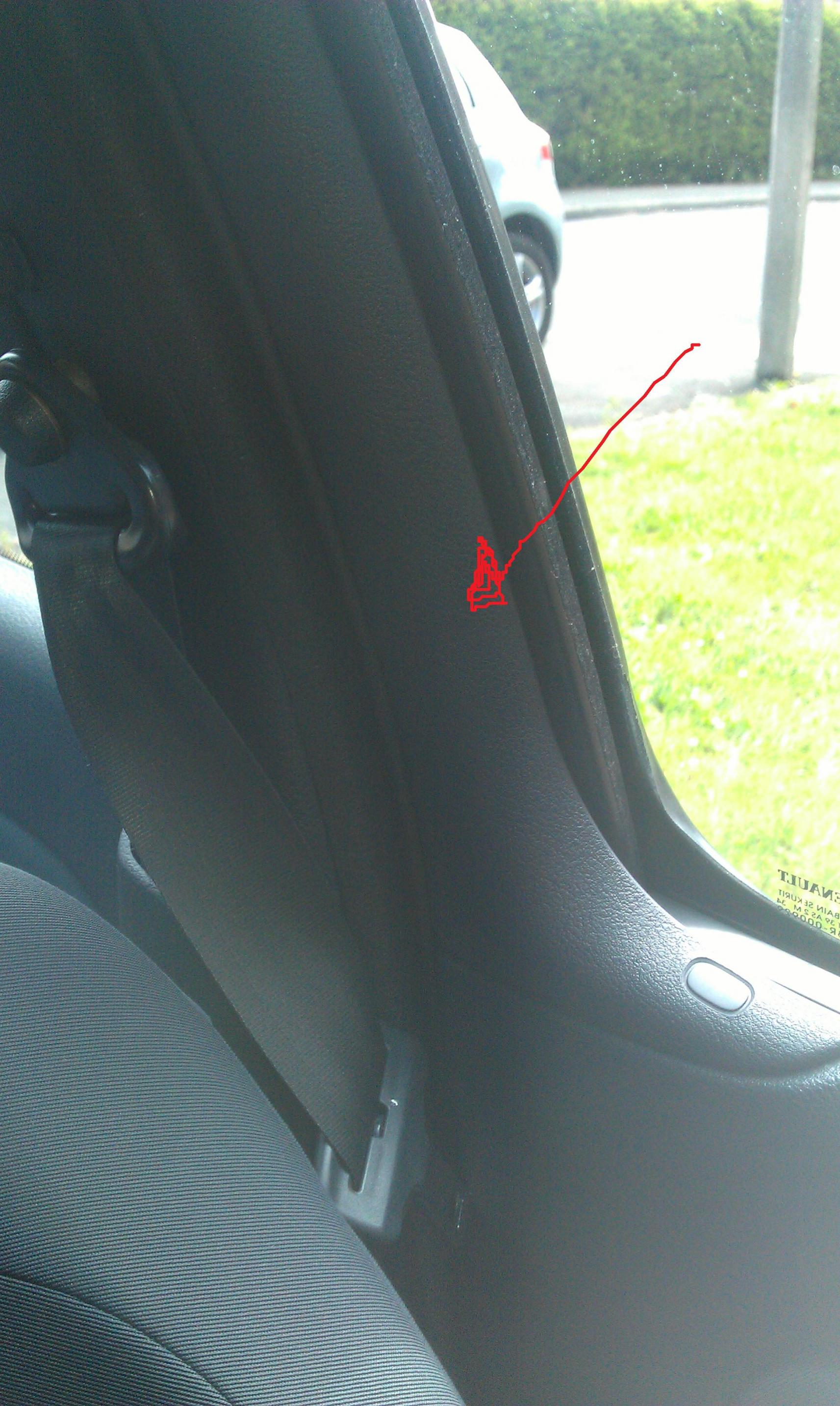

Hello everyone,
This part in my car on the passenger side door has just started rattling :mad:
Does anybody know how to get to this part and to stop the rattle!!
Many thanks
Just pull it off, a few clps on there, I then put some cotton wool behind mine to stop the rattle :)
Mine does the same, was meaning to put a thread to ask where to get the clips from or something to sort it. I think the reason mine rattle is a couple of them are cracked so it doesn't clip into them all.
I used the cotton wool trick, i didnt think it would work but there is no more rattle! thanks everyone :)
With the cotton wool, where abouts did you put it to stop the rattling ?
I pulled it out where it clips in and filled the empty part behind it with cotton wool so it cant move, hope that makes sense, because the rattle is so annoying especially with music!!
