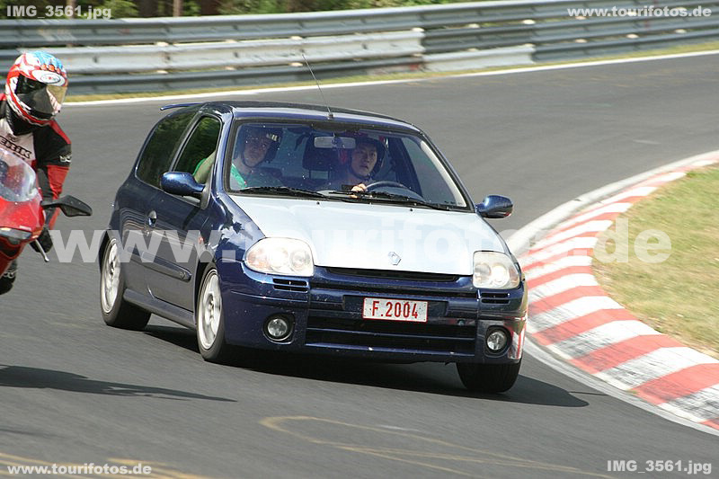

Finally got around to getting my ph1 corner weighed. I had made some adjustments to the suspension myself so I was rather pleased that it was pretty much fine without having to adjust it at all.
Weights with me in the car in kg, seems better than the silver Clio, from which the aluminium bonnet was swapped from (still need to paint it) :)
FL 365.5 FR 360.0
RL 206.0 RR 201.5
Total 1133.0
50.44% on the left side
35.97% on the rear
Still have a mysterious noise issue that I need to sort out, definitely not the topmounts, probably the engine bush.
Picture of the car:

hello mate i recognise that multi colour car! we were at the ring at the same time as you last week Sunday 4th clio 182 in silver. We had the evo too? thought i'd jump on here for a look!

Yes I remember you guys :D
