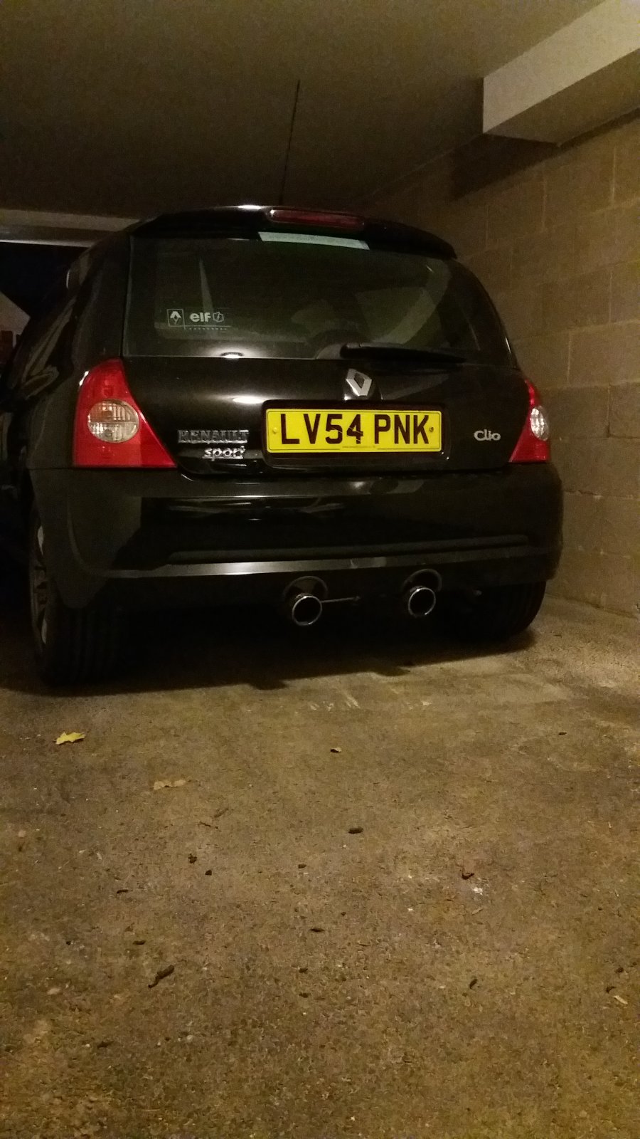

Its also hanging so low the back end looks like its crapping pipes.
I aint convinced replacing the center mount will give it any more lift to make any difference on the rear. How the hell do i get this thing to sit up in the bumper?

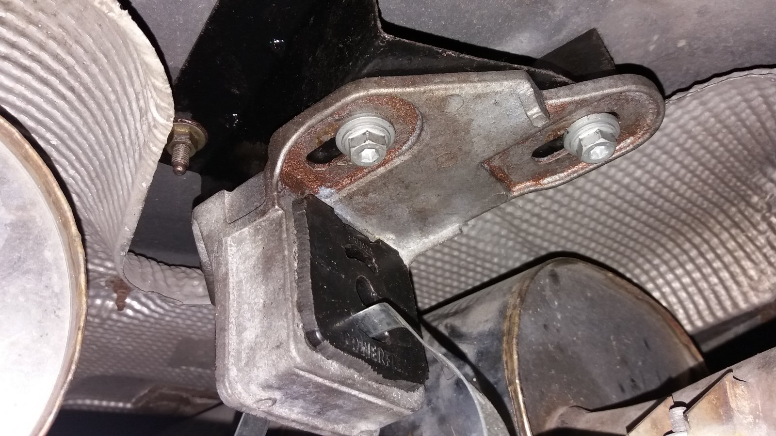

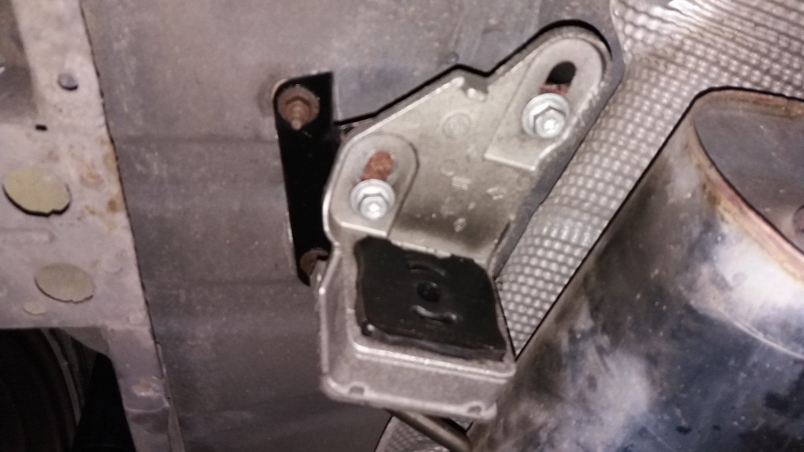

yeah mate i did the rear hangers already, new brackets and fitted powerflex bushes. Aint tried bending the hangers though, is there enough flex in the chassis mount brackets?
Thats not what the exhaust should look like with new rear mounts, very strange put up some pictures of the mounting points,you shouldn't have to bend the hangers.

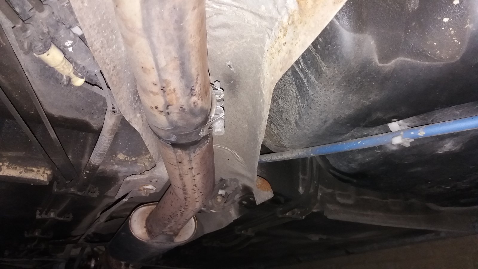

It was hanging lower than that before hangers where replaced! I pushed the exhaust as far as it would go into the hangers. That last pic shows the center mount on the right.

Slacken all the joints. Jack it up around the centre section and backbox. Then tighten all joints and lower jack. If it still sags then remove rear hangers, centralise, fill the lower bits with tigerseal and wait for it to set. Then refit.

A couple of places I would look for blowing is the cat to exhaust join and also the around the centre silencer. Scorpion eventually added flexi's to help stop it cracking.

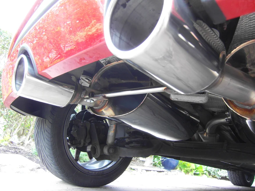

I got so fed up with it, I got plates added to the silencer and welded the sleeve!

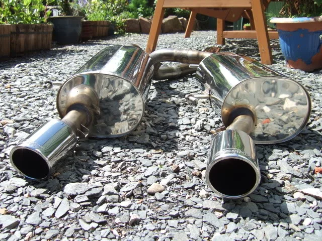

Wtf is that on the right silencer?
Should look like this
Also where its leaking at the join you can use black rtv to seal it, dosnt crack like exhaust paste.

A straight bar has been welded on both boxes, im guessing thats what you can just about see the top off on the right side. I might just cut that off as it hangs below the bumper and looks crap. As @hipwell suggested im just going to slacken everything at the weekend, fit the new center mount and got a mani to cat gasket so might as well fit that too. See if i can get it better aligned and check all joints.

The straight bar should be held in place with alen head bolts, but the captive nuts are welded to each tail pipe this is how it should look, sit.
