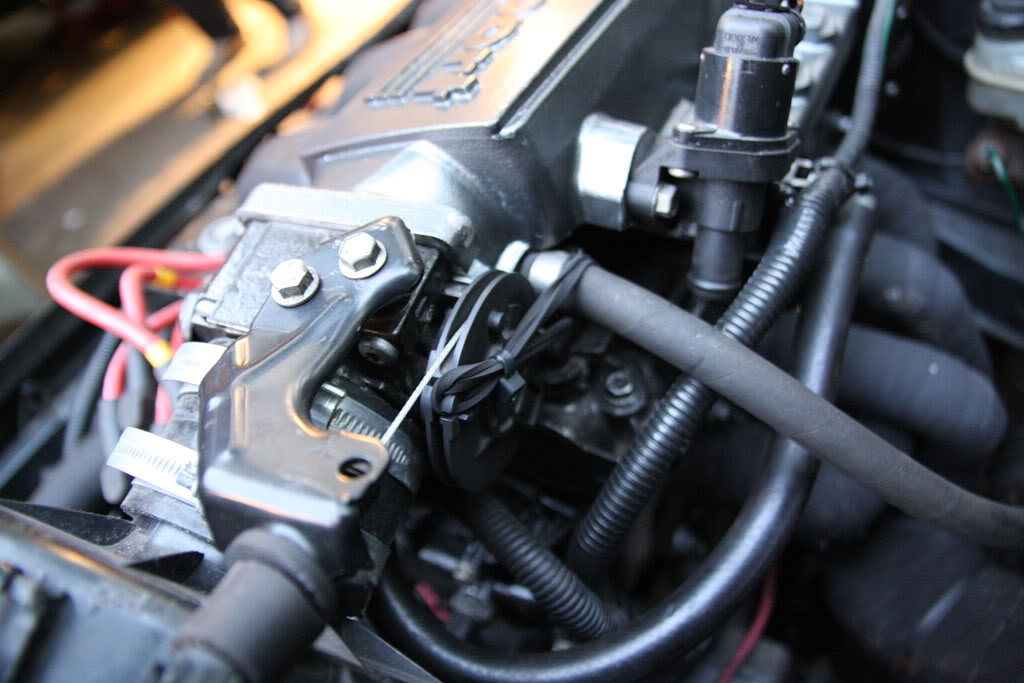

People on here say they have cleaned them and regreased with success, but ive done mine 4 or 5 times now and it didnt make much difference. I rigged it up with some heavy duty industrial elastic bands like so:
It just returns the TB that last millimeter perfectly..Got millions of them in the factory if you want a couple. Only other option is new TB really!

...but wont moving the throttle stop will just raise the idle? They tend to be a pain in the arse when you start playing with them!
