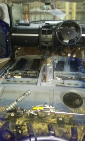

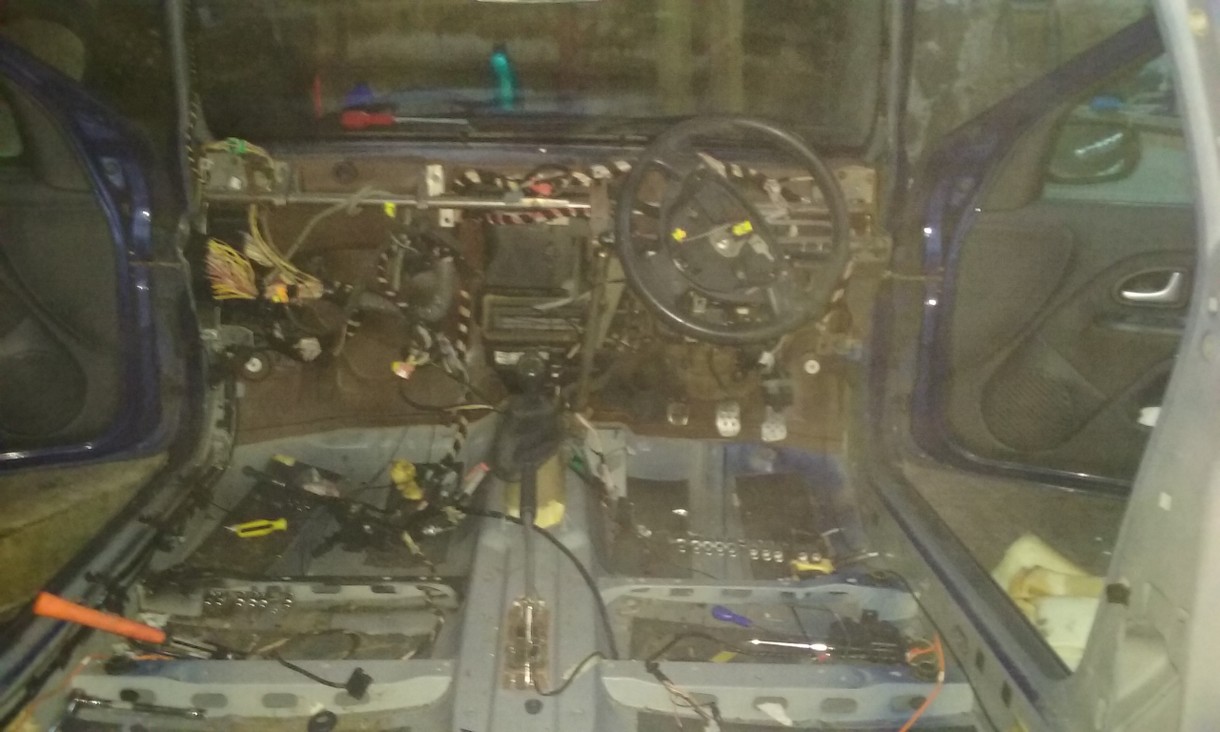

So it has been a while but I thought I would update a few pics and let you know what is happening.

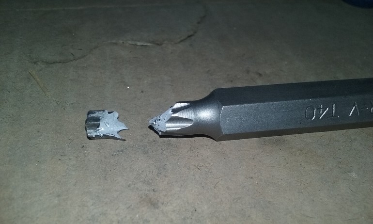

Above it a cheap torx bit bought of ebay. It didn't manage to remove any of the bolts but I did break it on perhaps the hardest bolt on the whole car. The bolt that sits in between the rear passenger seats. I managed to break 2 and had to go and but a Halfords set. Which I would recommend. Any way that was a weekend wasted!

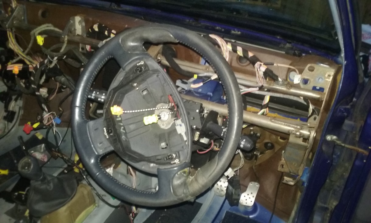

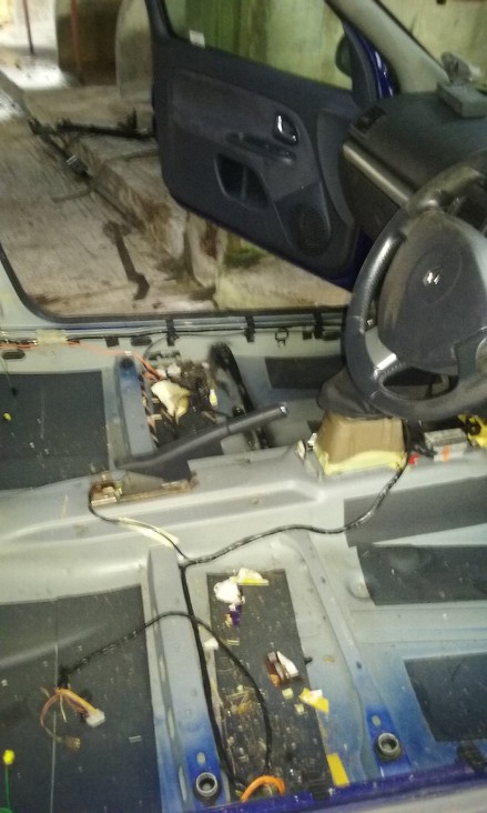

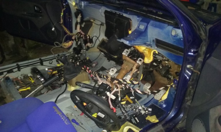

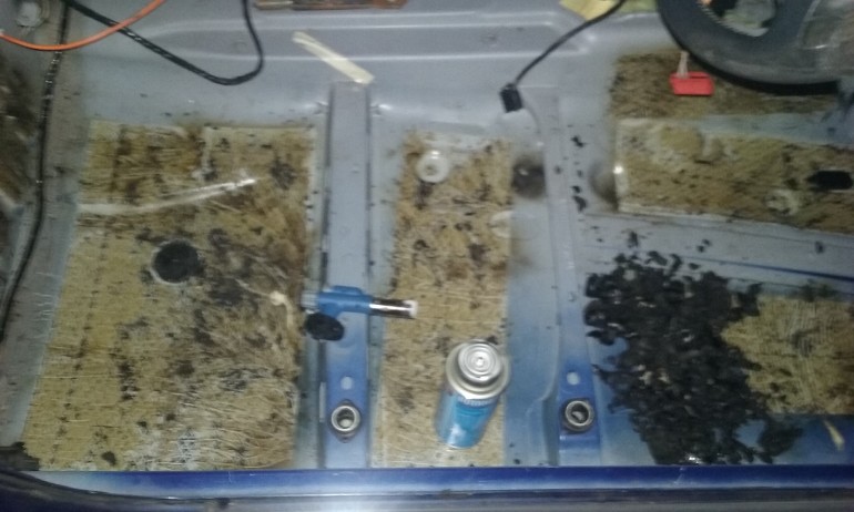

Progress is a bit slow due to no leccy in the barn and daylight is in short supply at the moment. I have managed to strip down the whole of the interior including the difficult dash top which decided it didn't want to "just pull out." I have removed almost all the sound deadening and a day sniffing tar fumes is overated!
I have decided to drill out all the excess brackets and will crack on with that soon. The cage is due to go in early February. I have chosen a weld in cage which will go behind the dash hence the removal of the dash. My welding is a bit like pigeon s**t so this task will be done by professionals. I will get a diagonal with harness bar, door bars and I hope to have a rear brace between the shocker tops. This will be MSA standard and once in I will spray it up to stop the surface rust getting hold

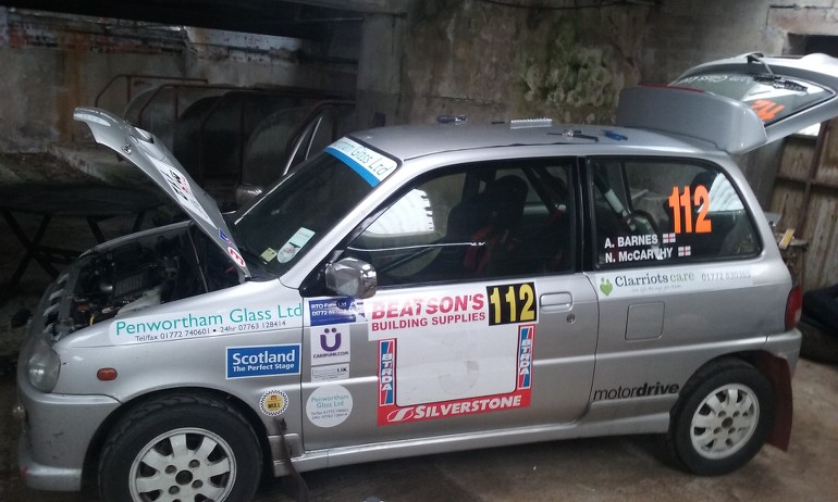

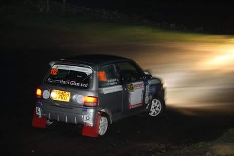

What is the reason for all this sudden activity? well I did Mull this year in this
  Mazda mps
And God was it slow. I can honestly say that I have never driven anything as hard and gone as slow.
We were 102nd when the rally was cancelled and I was driving the socks off it. Still I was beating 50 other cars so god knows what their excuses are!!!!!!
