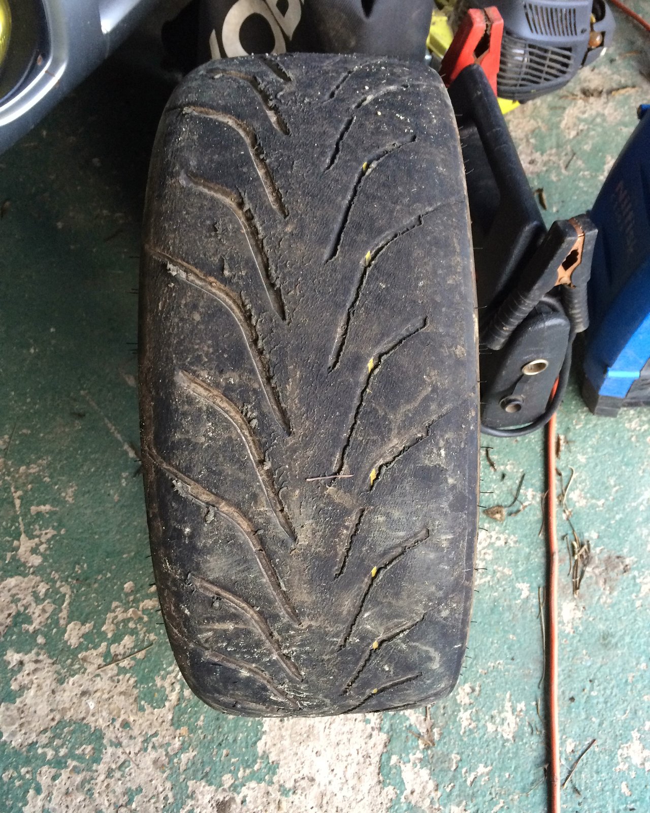

My R888 have done just two track days and no longer look legal, I think wear rate is sensitive to ambient temperature and tyre pressures
