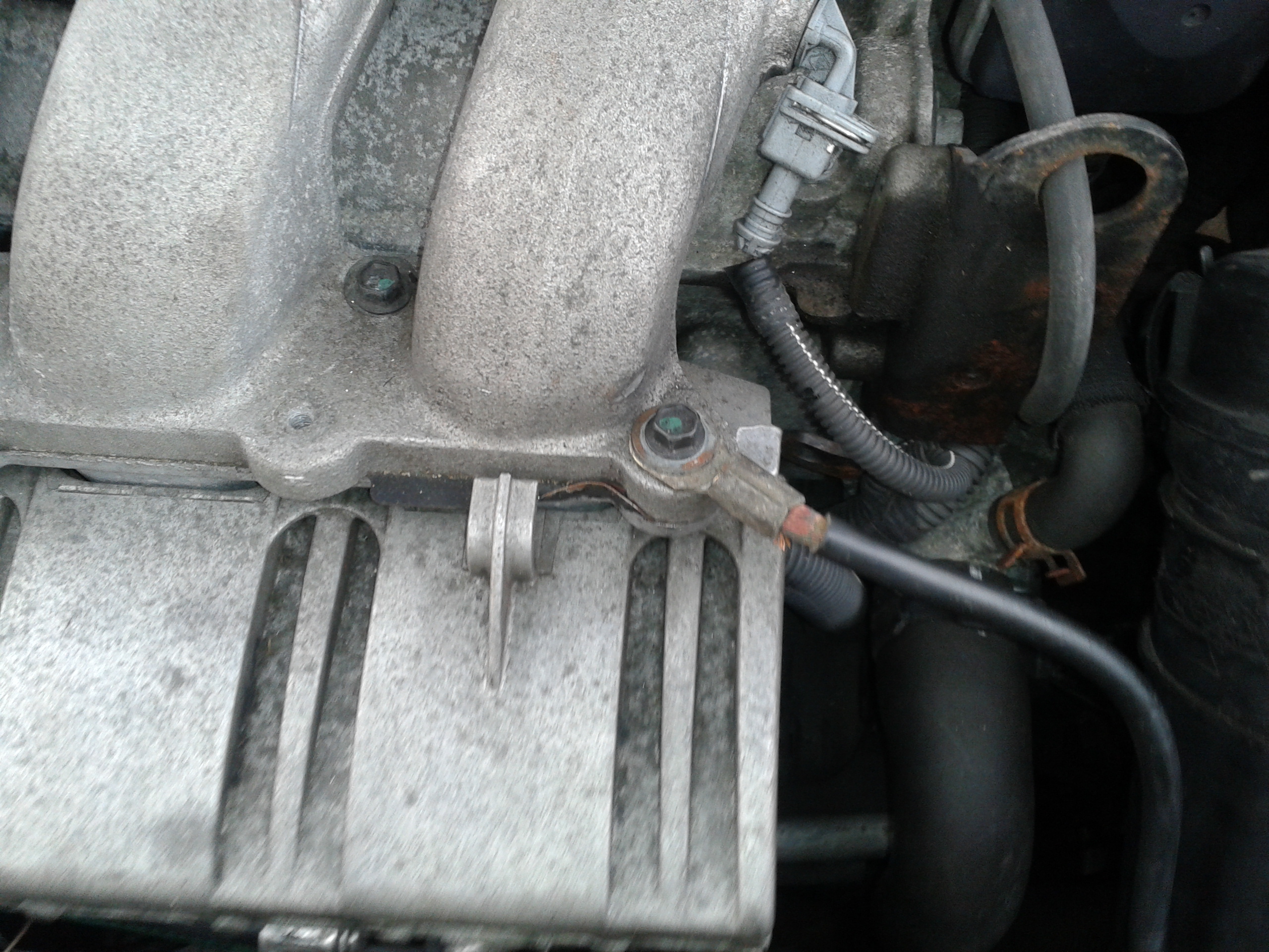

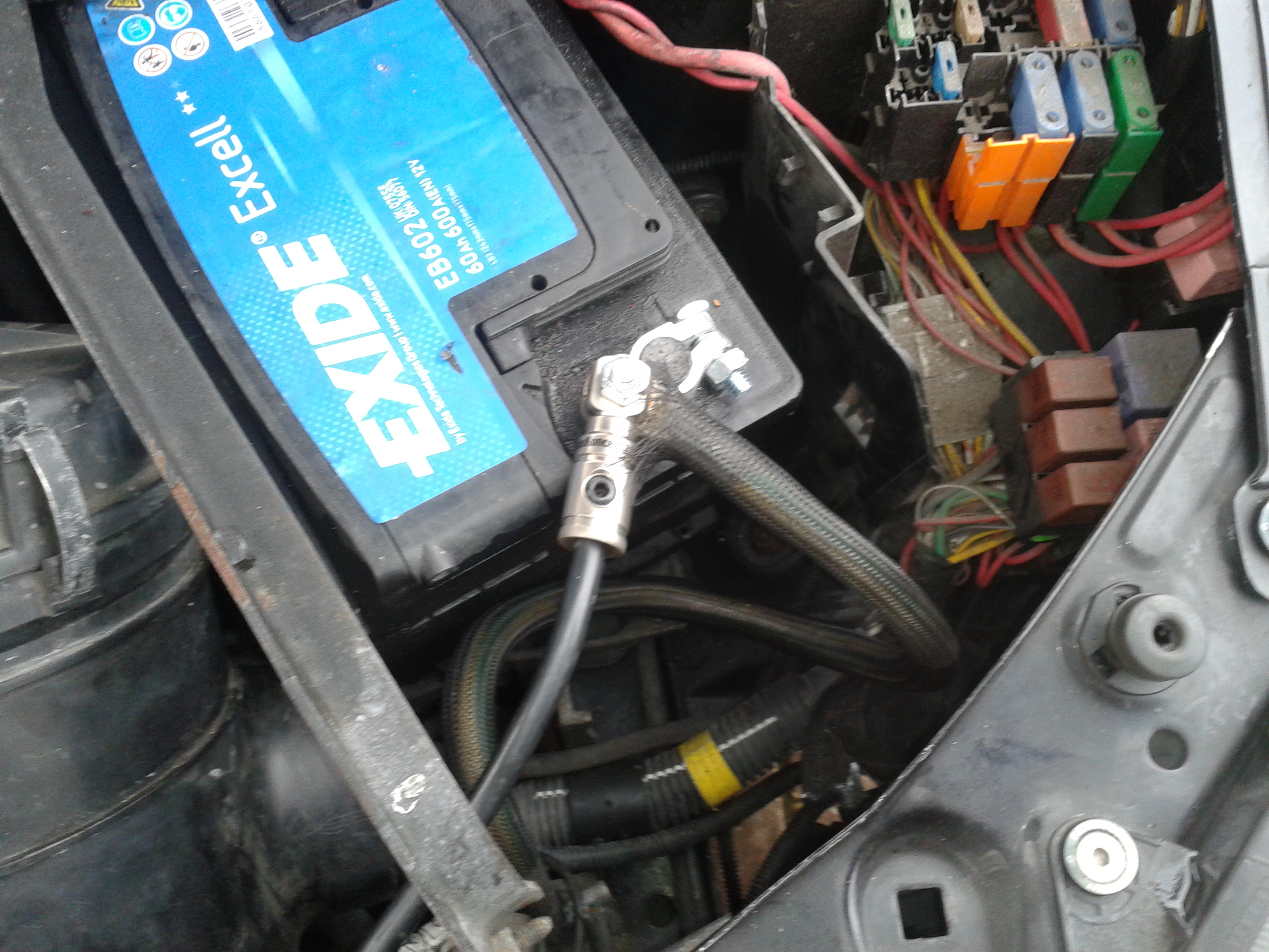

Might not be helpful but if the engines been out have you made sure the earth strap has been put back on?
  PH2 172
earth on the top of the box first port of call.
A lashed up earth or a jump lead from battery negative to engine will confirm a poor earth.
