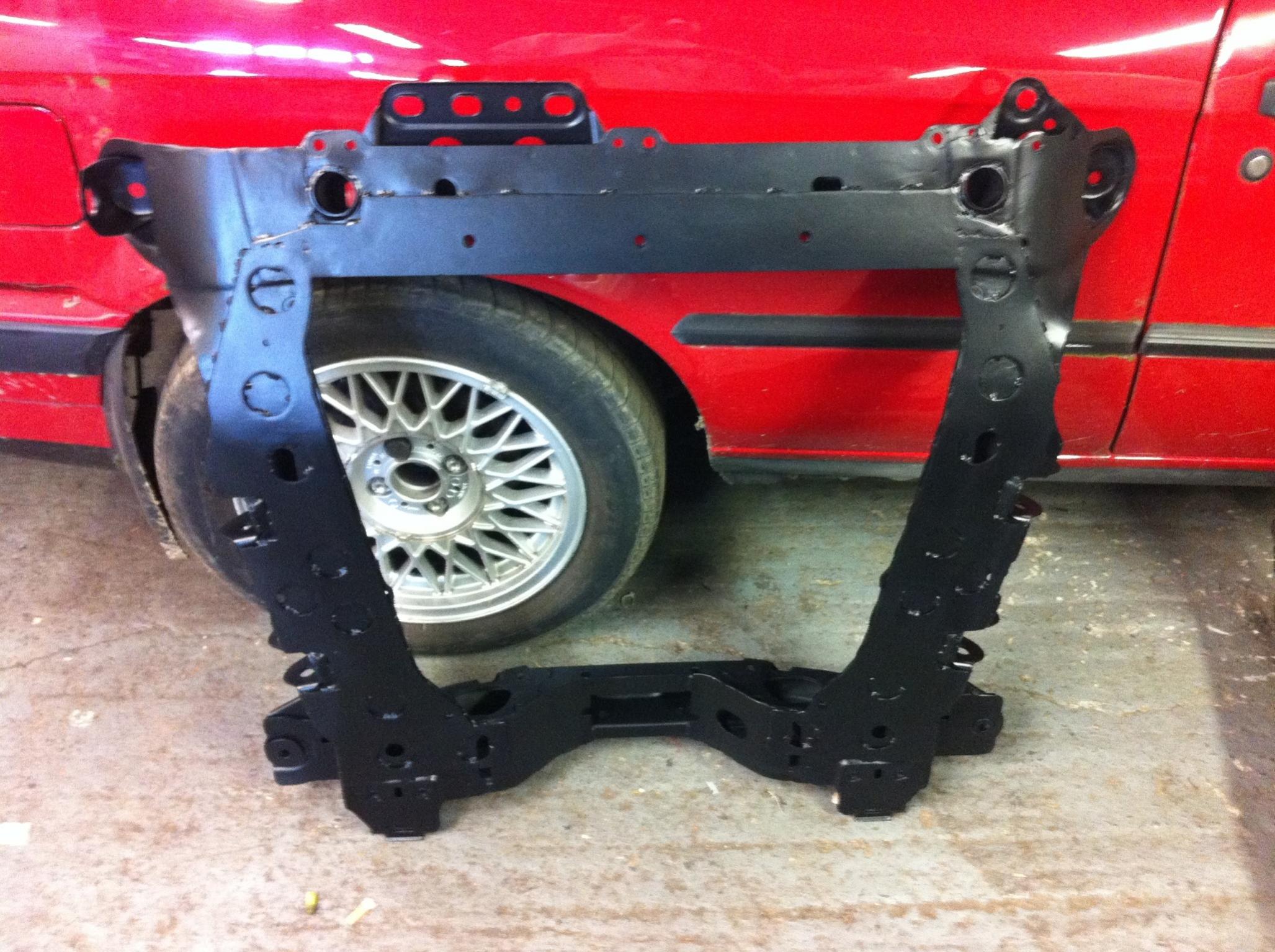

As Dan says wishbone kit is a waste of time, more often than not the standard wishbone takes the sub frame with it when It bends. Its worth while double skinning the underside of the sub frame and stich welding. That way the wishbone will bend like its meant to and in a bad crash the sub frame should still bend.

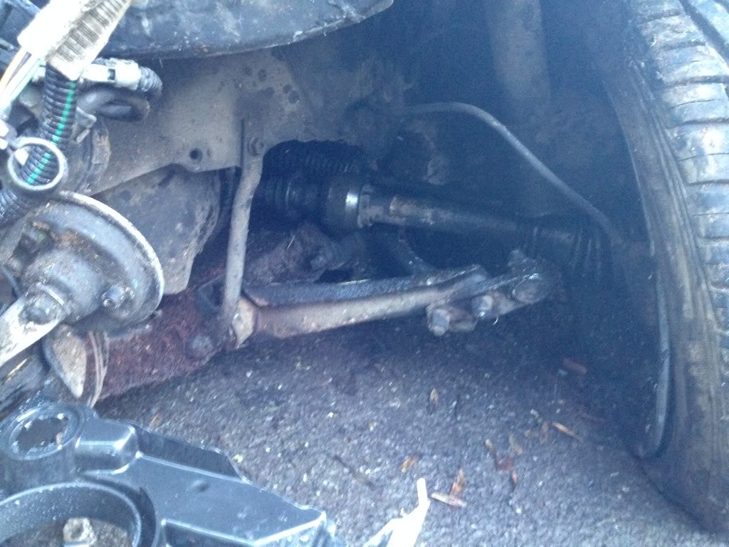

Prime example of what wouldn't happen if you fitted that strengthening kit (to the wishbones)
What? The hub wouldn't snap?!!!
The front subframe and wishbones are weak, so for any competition use the stiffer you can make them the better. If you hit a wheel hard enough to bend a wishbone, you've probably bent the subframe whether the stiffening plates are there or not.
