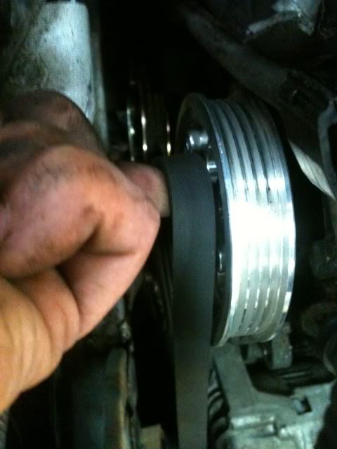

Just for those who think im intentionally bullshitting just to bring pure motorsport into disrepute this is a pic of how short the belt is next to the PS pulley with the alternator butted right up against the block:

As it stands the belt seems to be at a tension I'm happy won't damage any aux component bearings as it stands and is only currently slipping at full lock, which i can more than live with. It does whine a bit at higher rpm but I'm guessing it's just a characterisitc of the kit. I have the conti belt part No. I may try another belt and see if its any nicer of a fit.
Don't get me wrong I was well impressed with the purchase when it arrived, some very nice machining work has gone into these items and i also appreciated the fact they supply new cam end caps and the revised alternator bracket is worlds apart from the original tie rod setup. But my original point remains valid, I don't think it needs to be that snug a fit when there's so much adjustment avaliable, just makes it a pain to fit.
If it starts playing up again I'll make the effort to ring and see if they can offer a solution.
