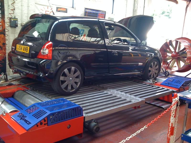

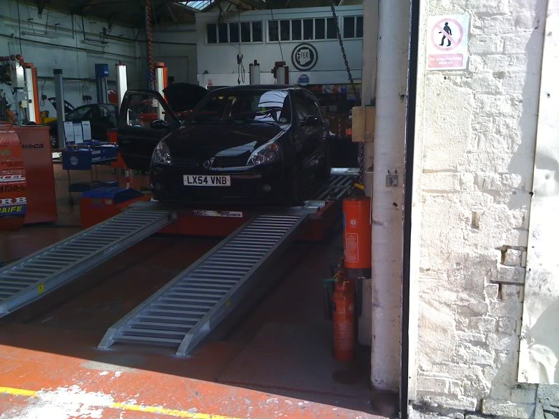

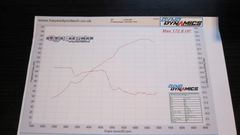

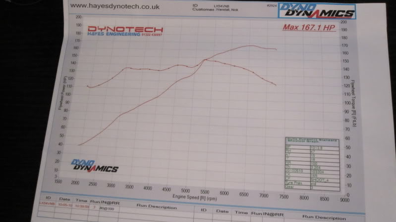

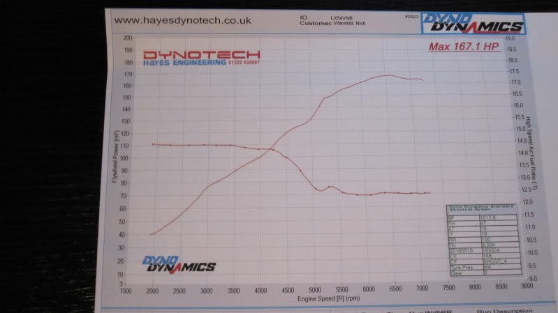

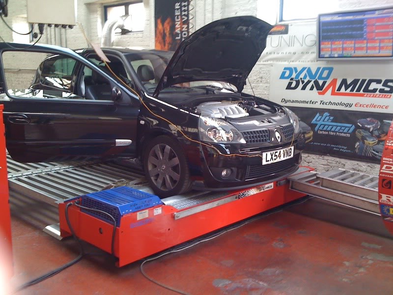

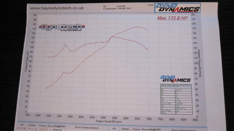

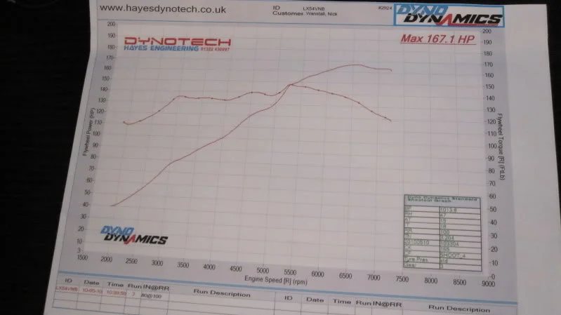

Now the cambelt was sorted I booked the car into Hayes engineering in Erith (Kent) to see if it was giving out good power, managed to get 167.1 bhp ( At the Flywheel) and around 150 lbs/ft Torque.

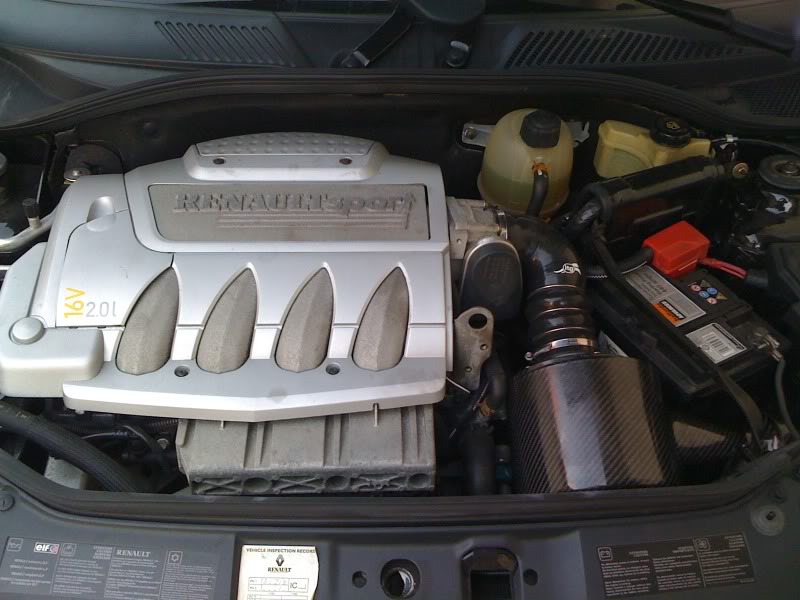

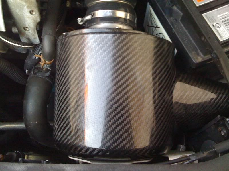

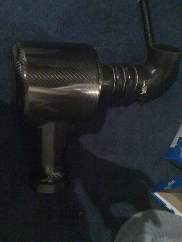

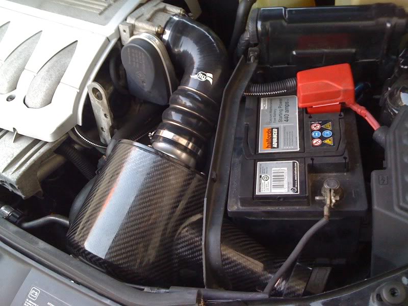

After going on about not modifying the car I decided to go against my word and buy an ITG Maxogen as I was getting slightly bored with the stock filter and tempted by the acclaimed bhp gains. Probably about 2bhp in all honesty.

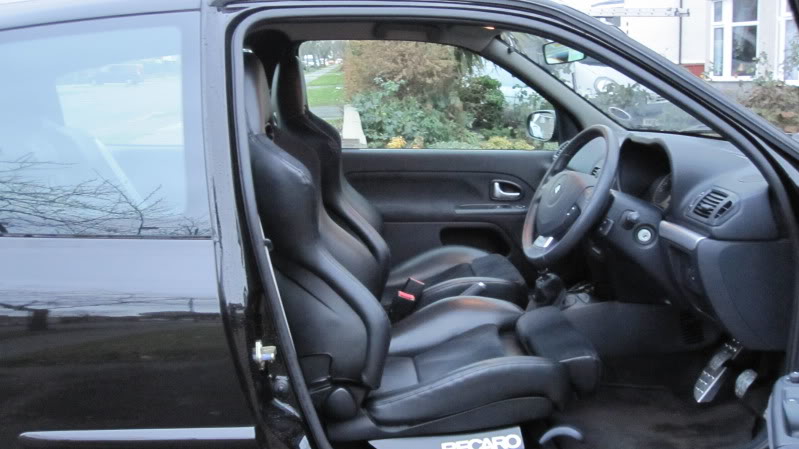

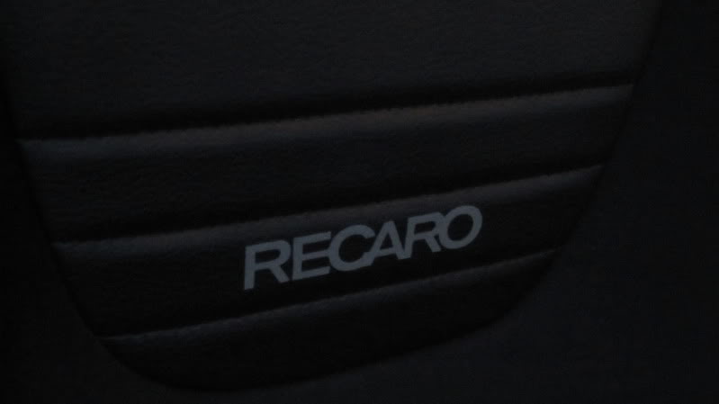

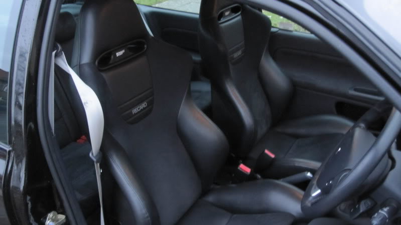

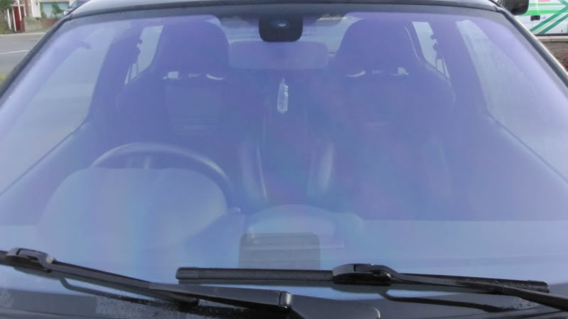

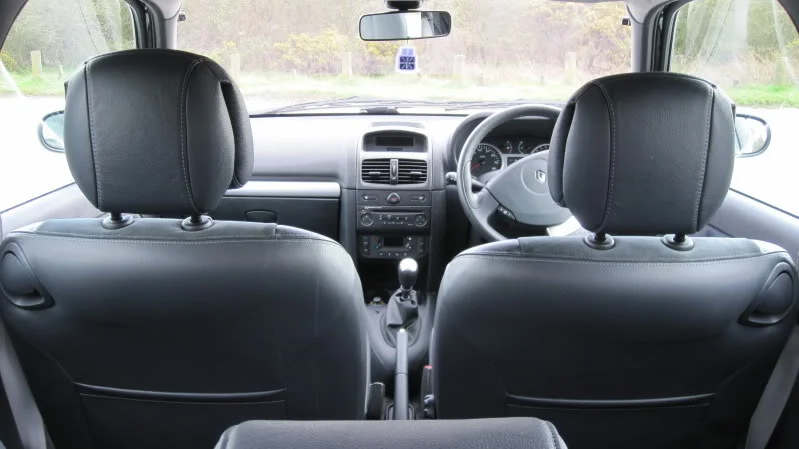

Due to not being a massive fan of the standard seats I decided to replace them with a pair of Recaro Treadlines and what a difference they made, the only ball ache was getting the airbag and service light to go out. But 40 pound later and a trip to maplins it was sorted.

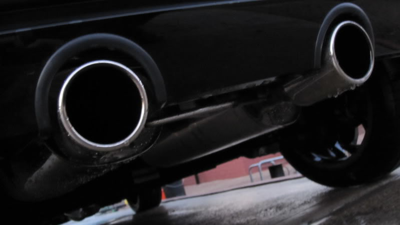

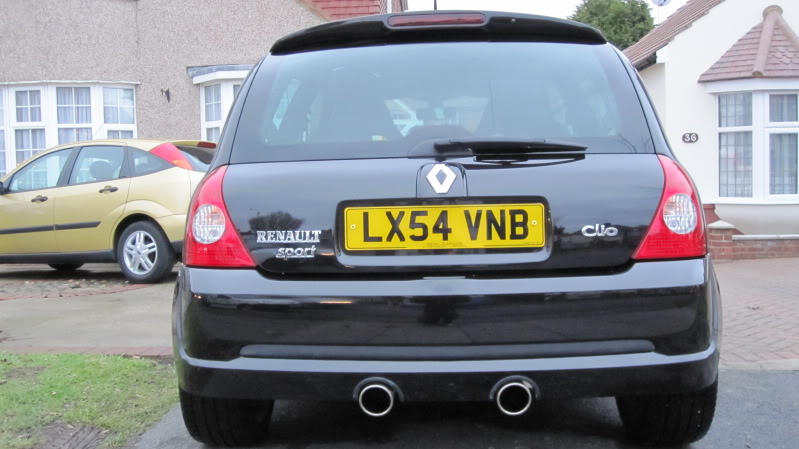

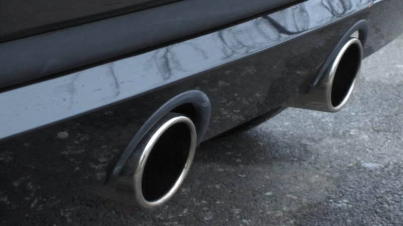

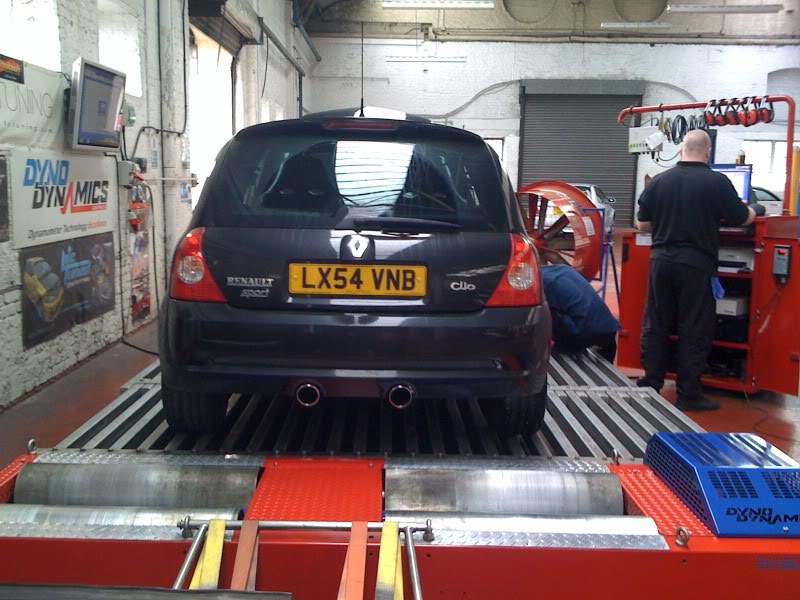

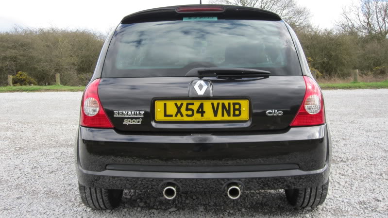

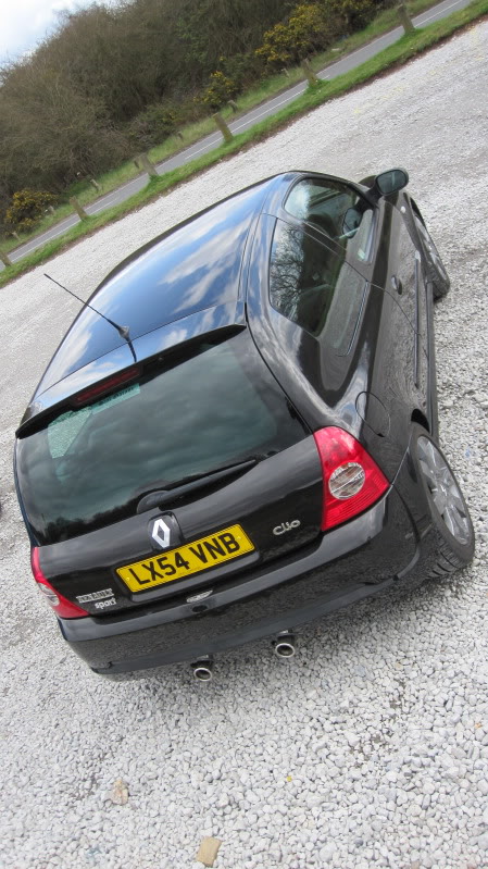

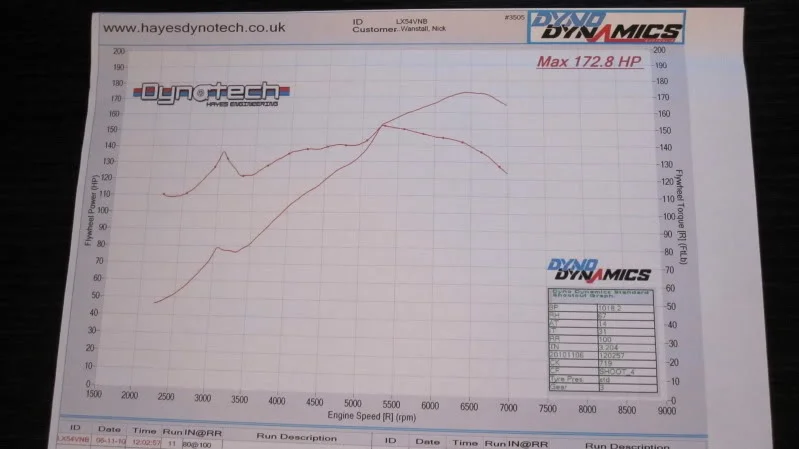

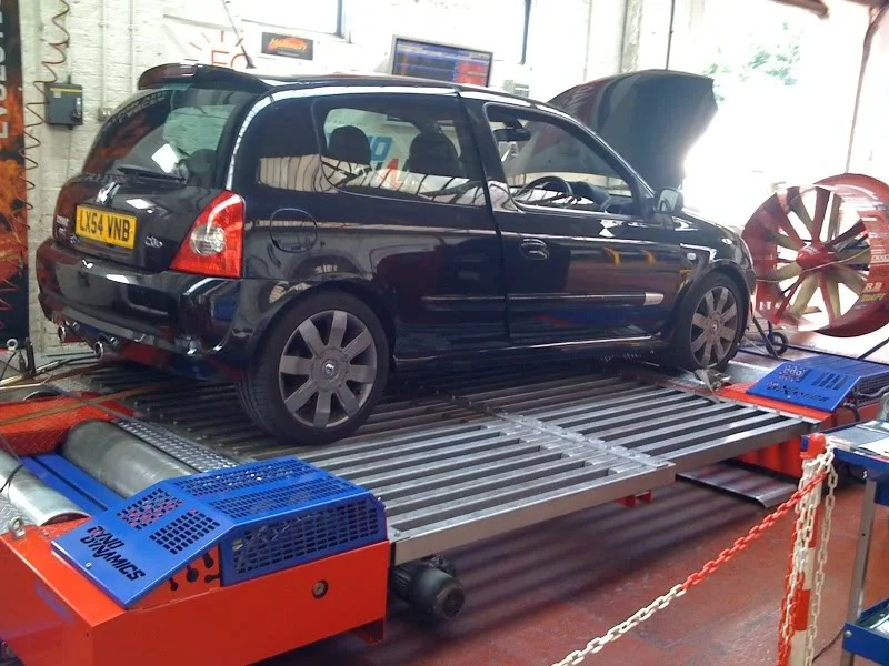

Now with the Maxogen fitted I was on the lookout for a Scorpion RS192 cat back exhaust to compliment the air filter, not willing to pay £400 notes for a new one I was fortunate to get a second hand one from the forum for half the price. I managed to get the Exhaust fitted at Hayes Engineering and got it on the rollers to see if it gave any gains with the air filter.

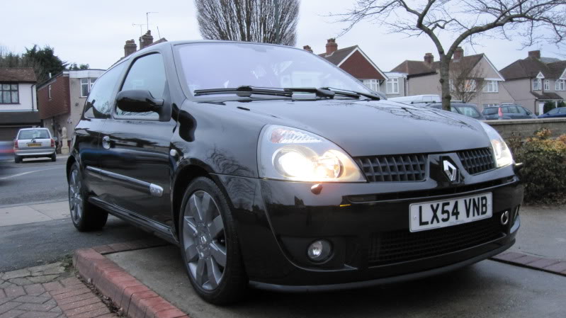

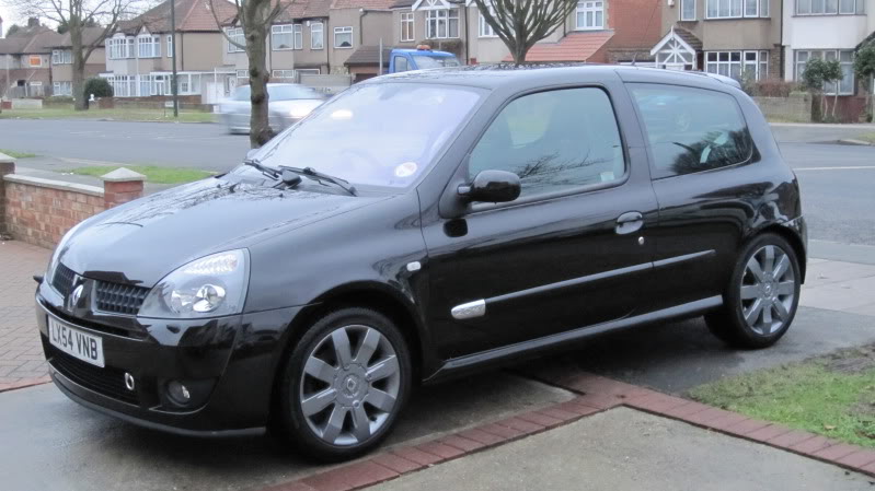

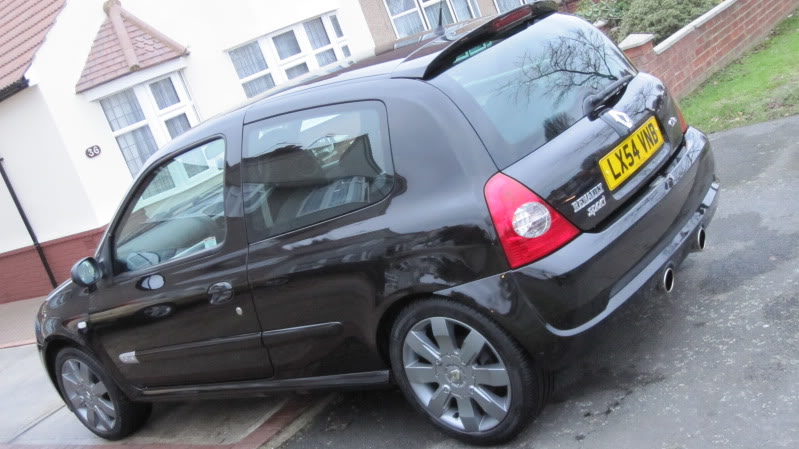

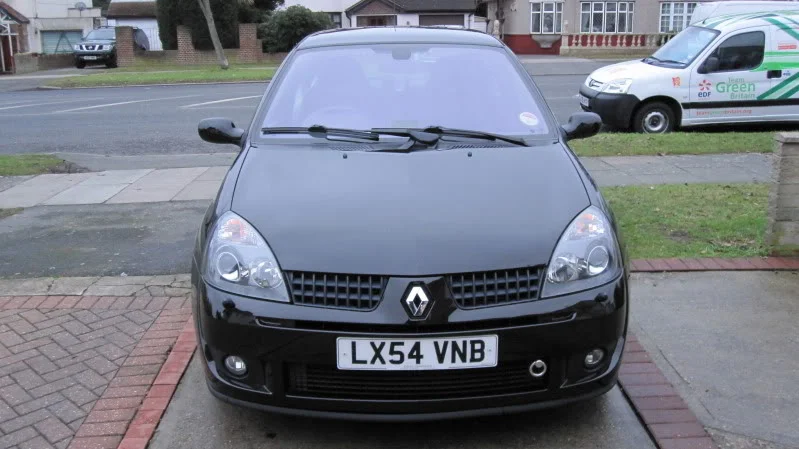

As it stands now after being detailed with the Si tow eye added.

Mint, as usual the Recaro's make it so much. 5.7bhp from an exahust claimed to give 10bhp and what was made up to be the best IK available... Shockingly true.
(I've the RS192 too btw!).
  Clio 182 2005
Lol i went with the Rs192 aswell, im just happy that it made a difference on paper !
  FULL FAT 182
I just think there the best exhaust out there, being that im getting on a bit i dont like loud exhausts. The fit was quite good with the aid of new hangers.
Aclaimed Bhp figures from the modifications are just a joke, according to scorpion and ITG i should have around 190 bhp lol,
but i cant wait to get the RS2 Manifold fitted, should make it 191 bhp with a bit of luck.

hmmm maybe why mine sits a bit low on the back ive tried everything to get the pipes sitting flush in the bumper. How much was new hangers? The way the car delivers power especially a stronger bottom end pull is very noticeable i think with a rs192 over standard.
  FULL FAT 182
I got some from ebay in the end for around 11 pound i think, but when i was getting it fitted they decided to use a couple of cableties to align the tailpipes as it was sitting to the left.
  Clio 182 2005
Found them mate is it the same mount for both sides?

Least that roller puts out realistic figures, lovely car.
Now you have a Maxogen I wouldn't bother changing it, they have just become less popular due to the stupid amount of money they cost. You're not gunna see anymore gains from a V6 box and ITG so unless you wanna free up some cash I would just keep it on if I were you. I would however put matched inlets, the 182 cat mod and some shocks/coilovers/springs on your to do list :D

That seems quite a low power reading even for a standard car. Atleast you gained something though, I've heard the maxogens in some cases can reduce power, possibly to do with where you mount the CAF?

Chris i think the car needs to be run in first, the F4R engine usually starts to open up around the 30k mark. But it pulls very well and ive opened it up on th motorway and it shifts, i might see if i can get it on the rollers and see what difference it makes with the standard airbox. The Maxogen does'nt need a CAF so ive been told by ITG but i removed the Acoustic valve as advised.

U seem to have a good taste! I would love the seats in mine! They are ace iv always liked them but in the black 182 looks so nice!! Will defo put pics up when I get mine! Just want the right one to come up! Iv been looking for 2months so far but most black 182's have over 40k which is to much for me!! And I want it standard! I'm a bit fussy!
Actually a totally accurate figure, possibly 1-2 less than normal - but a realistic reading non the less, especially for such a low mileage engine. They need at least 60k to reach their full potential in my experience.
  340i
From what ive seen the 1*2's make better power with more miles / abuse...
My pretty much standard 172 (exhaust, decat, remap, matched inlet/plenum) was 187.4BHP / 168ftlb at RStuning when it covered 88,000 miles
Please not i havent had the car mapped to suit the modifications, i've just put a deposit for the RS2 Manifold :)

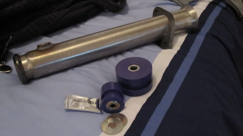

Just a quick update, i have just got a de cat for the RS192 system and the powerflex kit for the dogbone mount. Just trying to get prepaired for the RS2 Manifold that im hoping to get fitted in a months time.

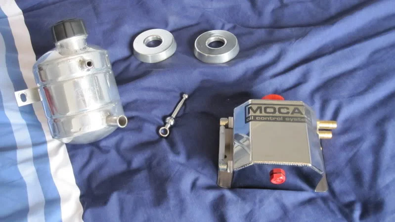

I know it's been a while since i last updated my thread but im just getting some parts before i get the rs2 manifold fitted.

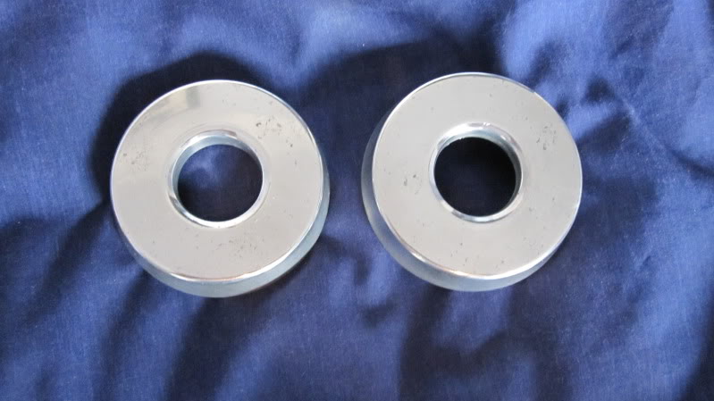

Aluminium Strut top covers

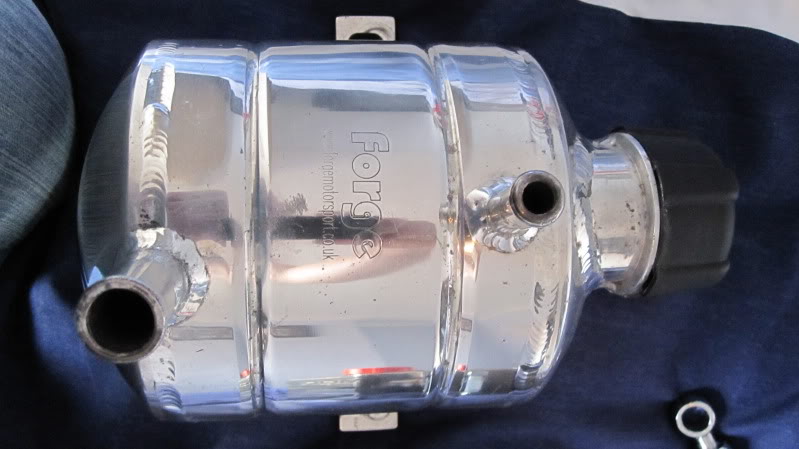

Mocal Oil catch tank
Shortshift pin
Forge Alloy header tank

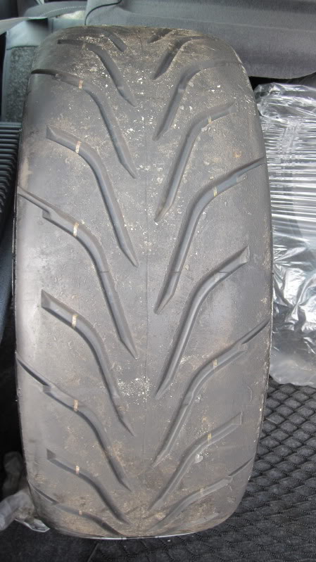

Toyo R888

Them seats are the dogs ;) Maybe they will hug me again someday soon :D

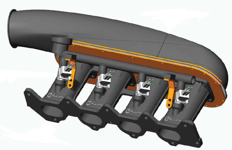

I have decided to go for the Black base manifold with orange anodised aluminium as this will look similar to the AST colour.
Im also getting the strut top cover anodised orange (poor man's top mounts lol)
Here is an ideal what the manifold should look like
