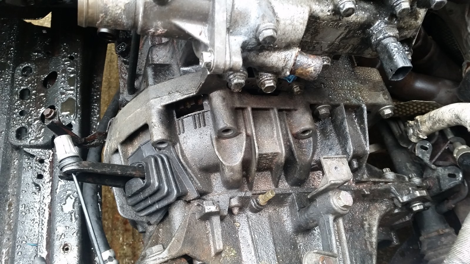

No shouldnt do, take the airbox out and its sat at the top between the engine and gearbox, held in by 2 10mm bolts
  Clio 172 Merc ML55
Not the best of photos but you can just make it out, its the little blue plug under the thermostat housing
  BG182 FF
Thanks for the help ads, working a treat now after cleaning it up a little Probably would have cost a small fortune in the garage..!
