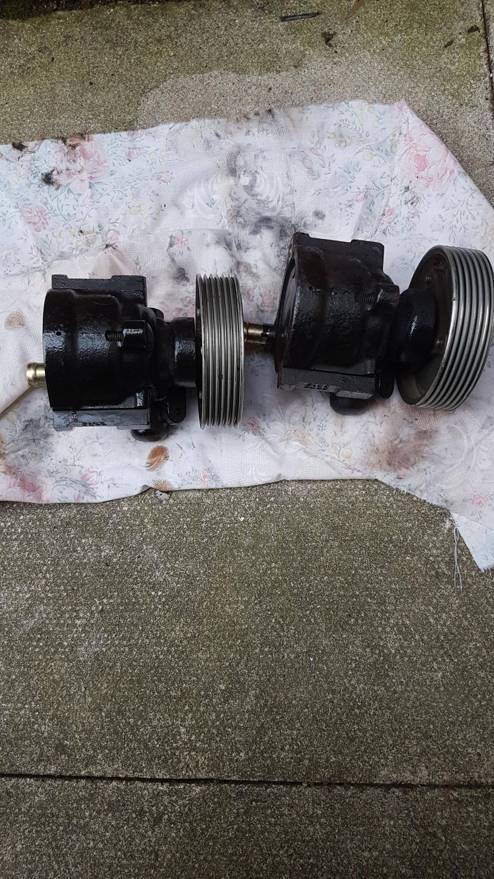

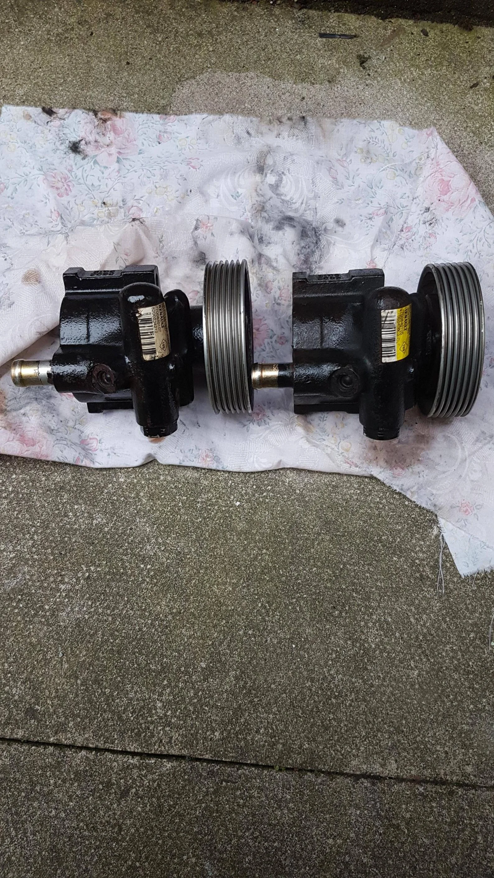

I have both pumps in my boot, will take pictures after work.
MorroN

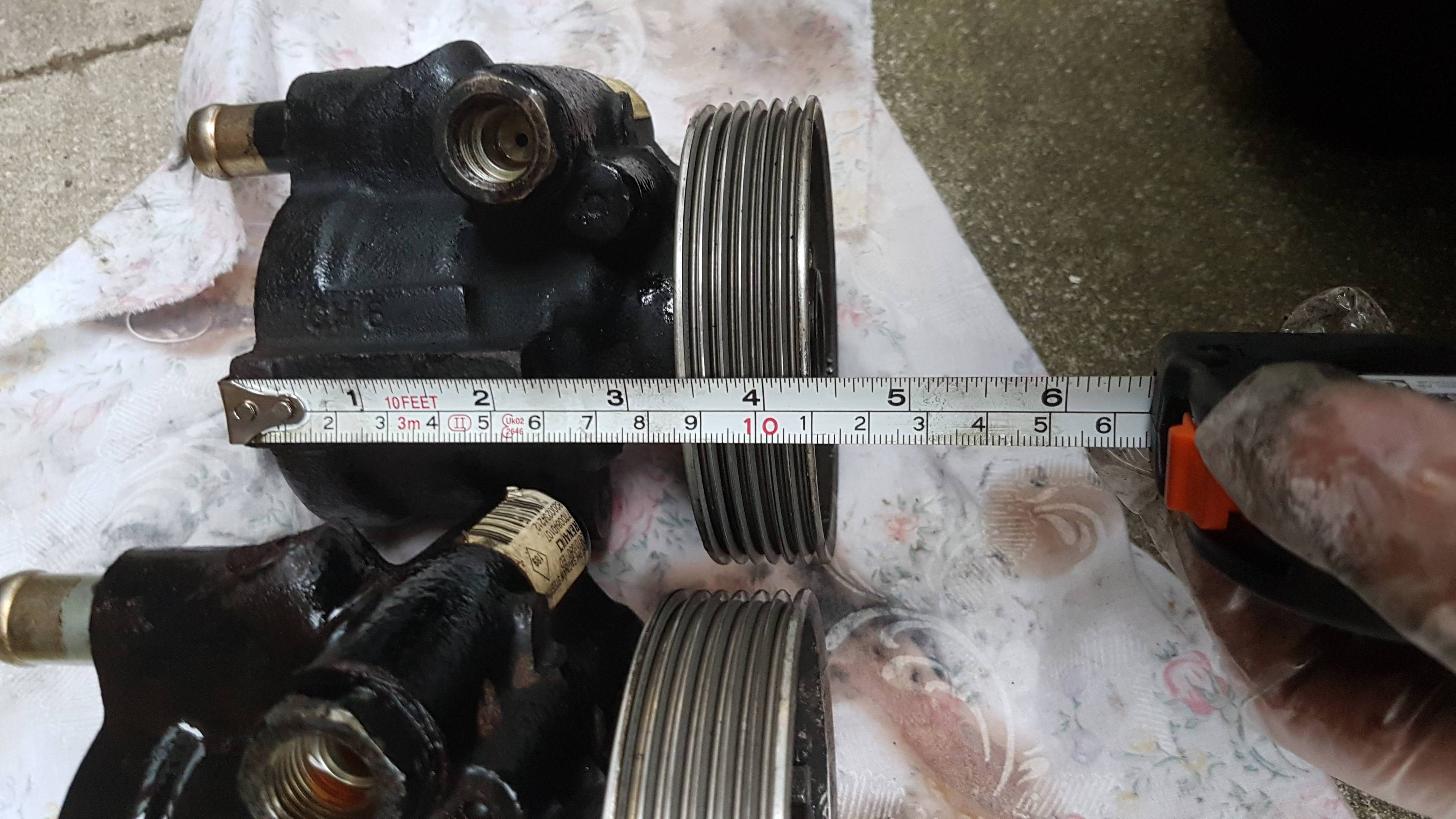

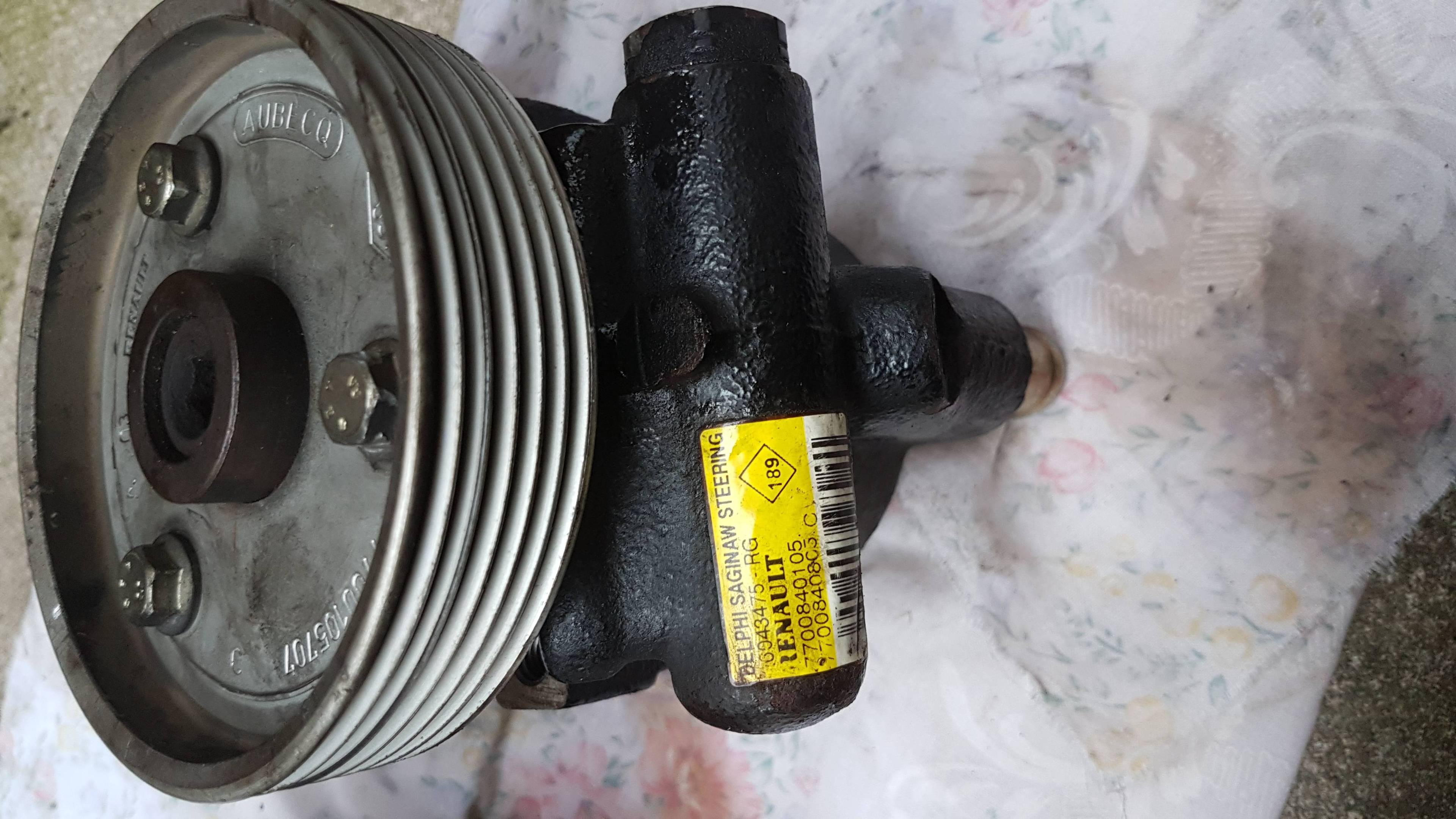

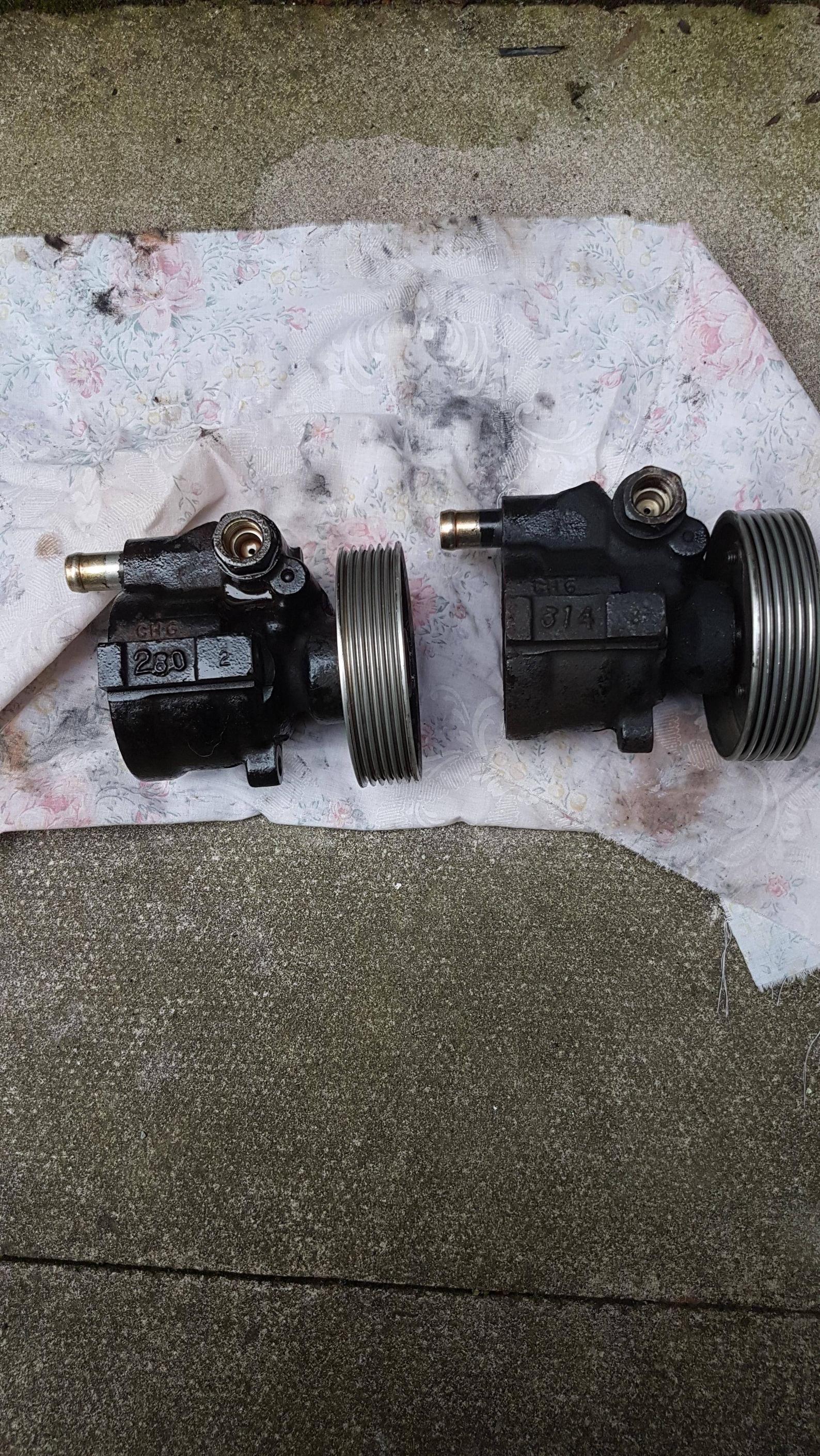

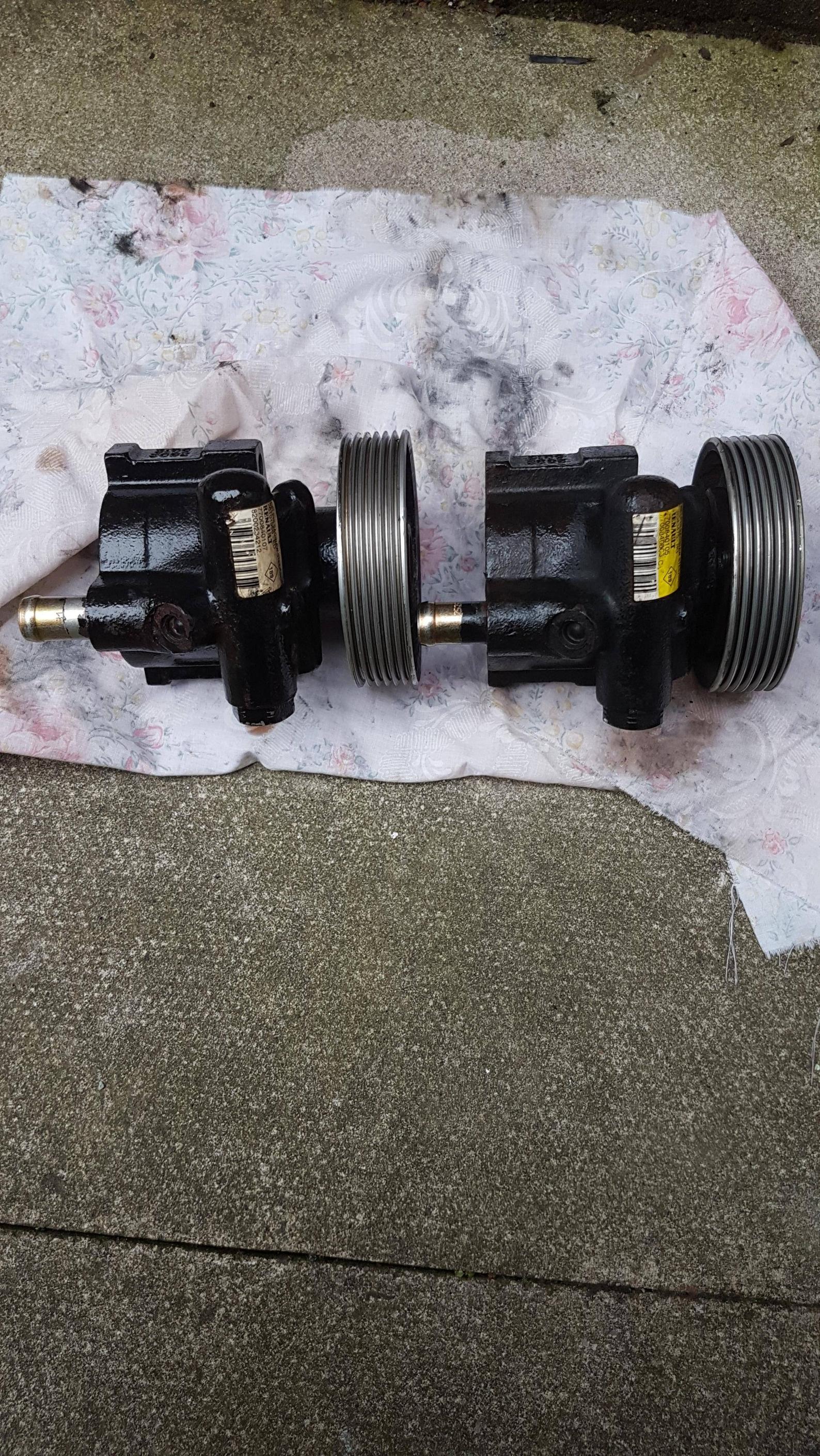

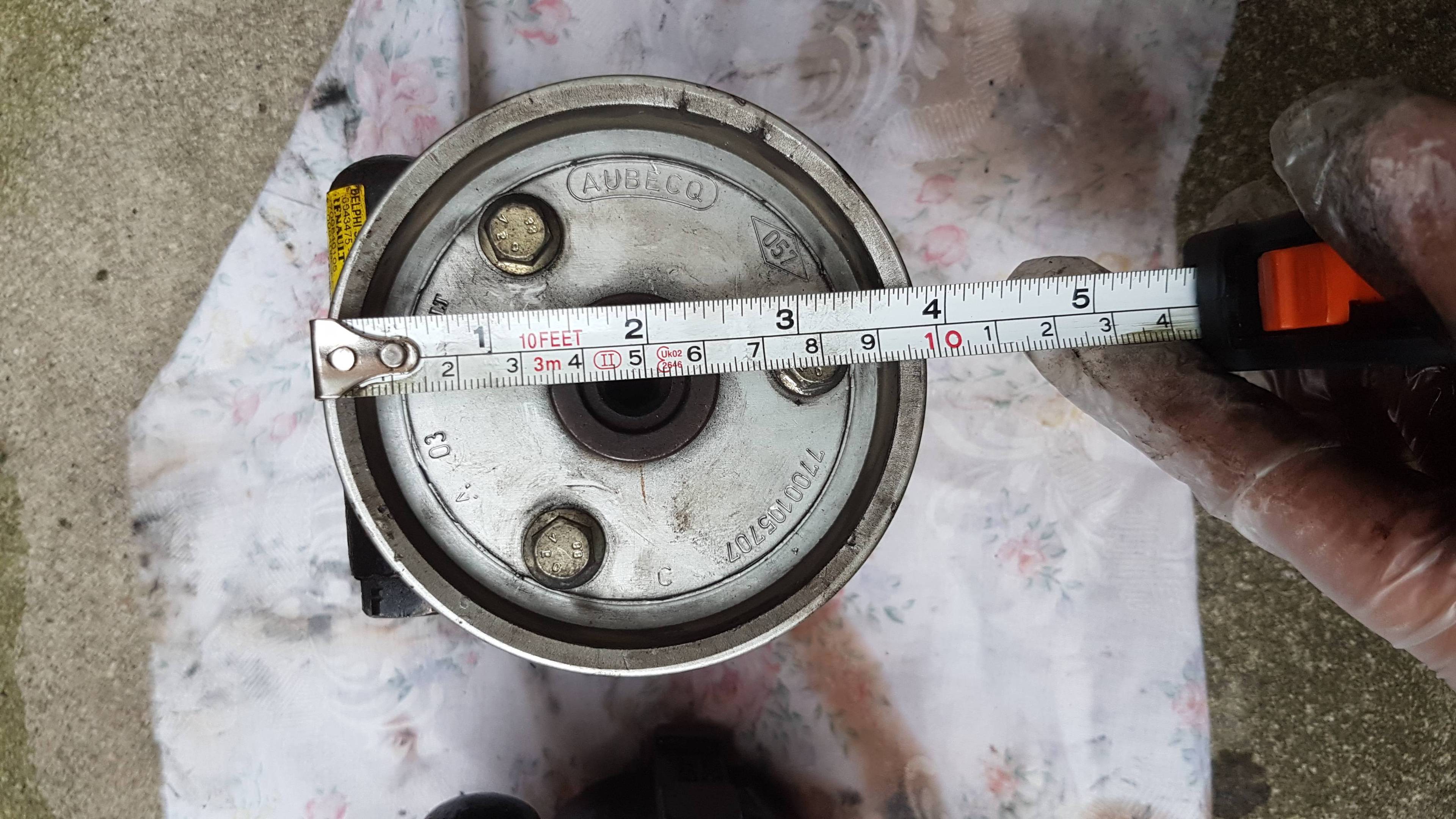

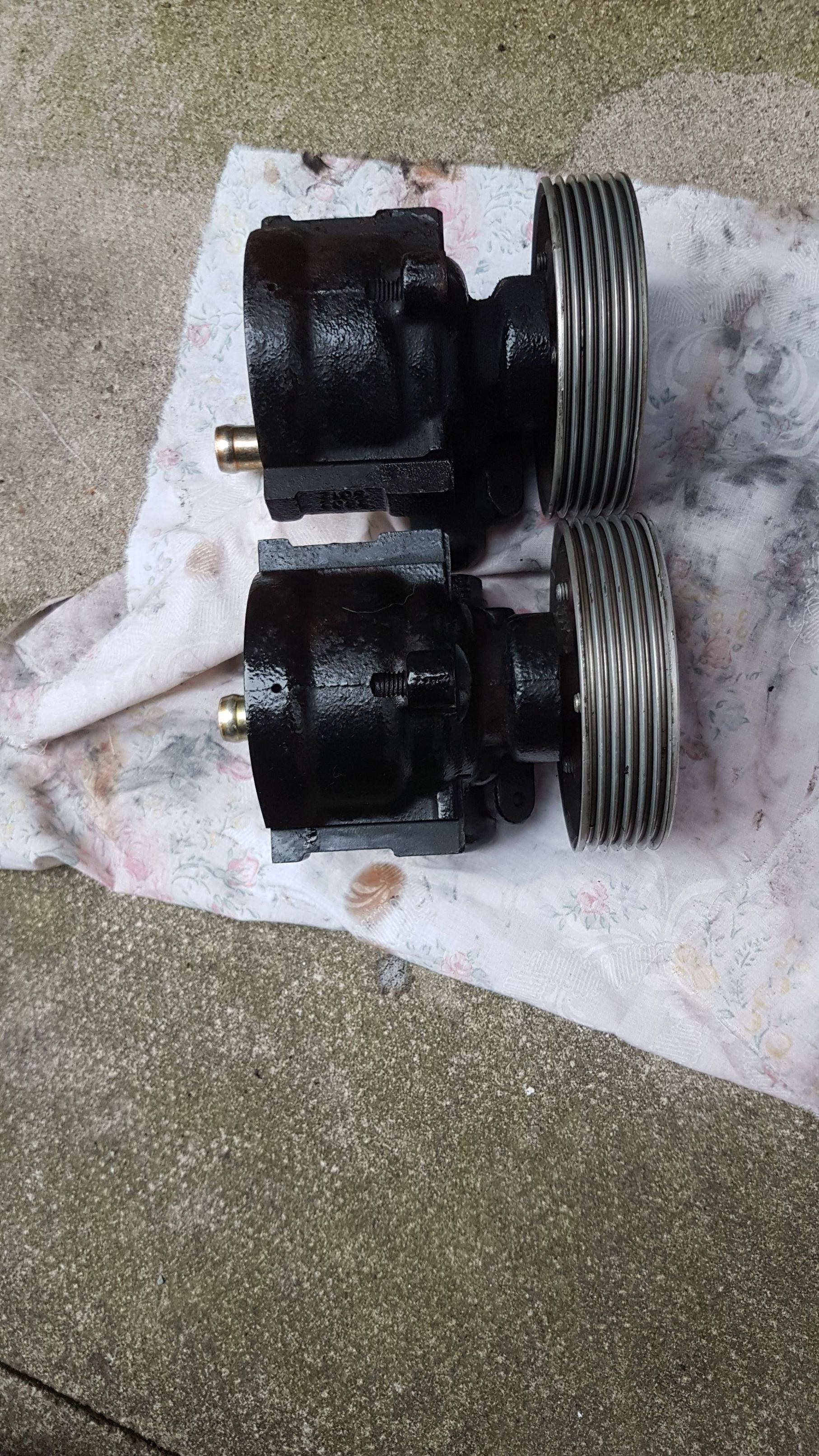

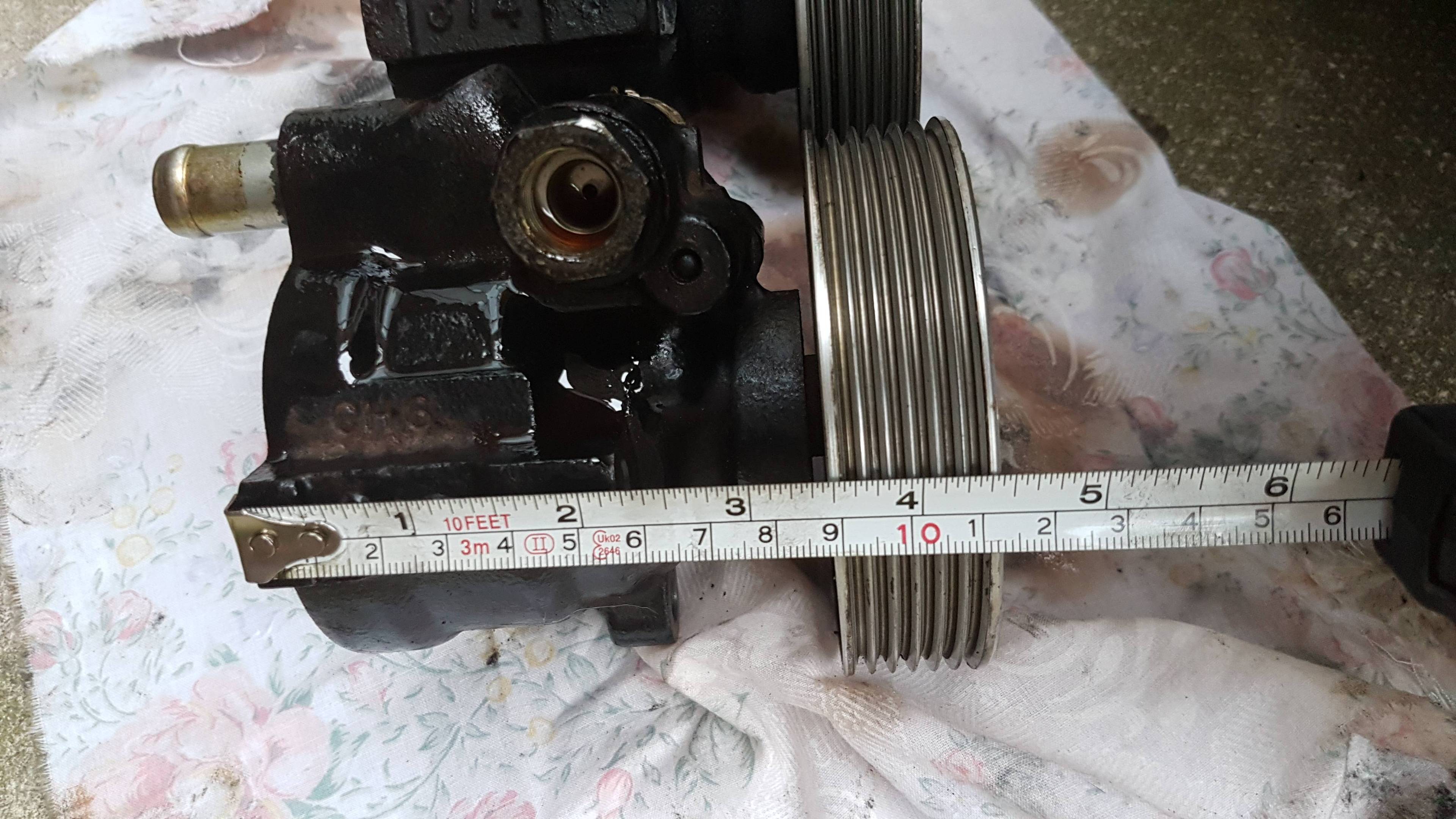

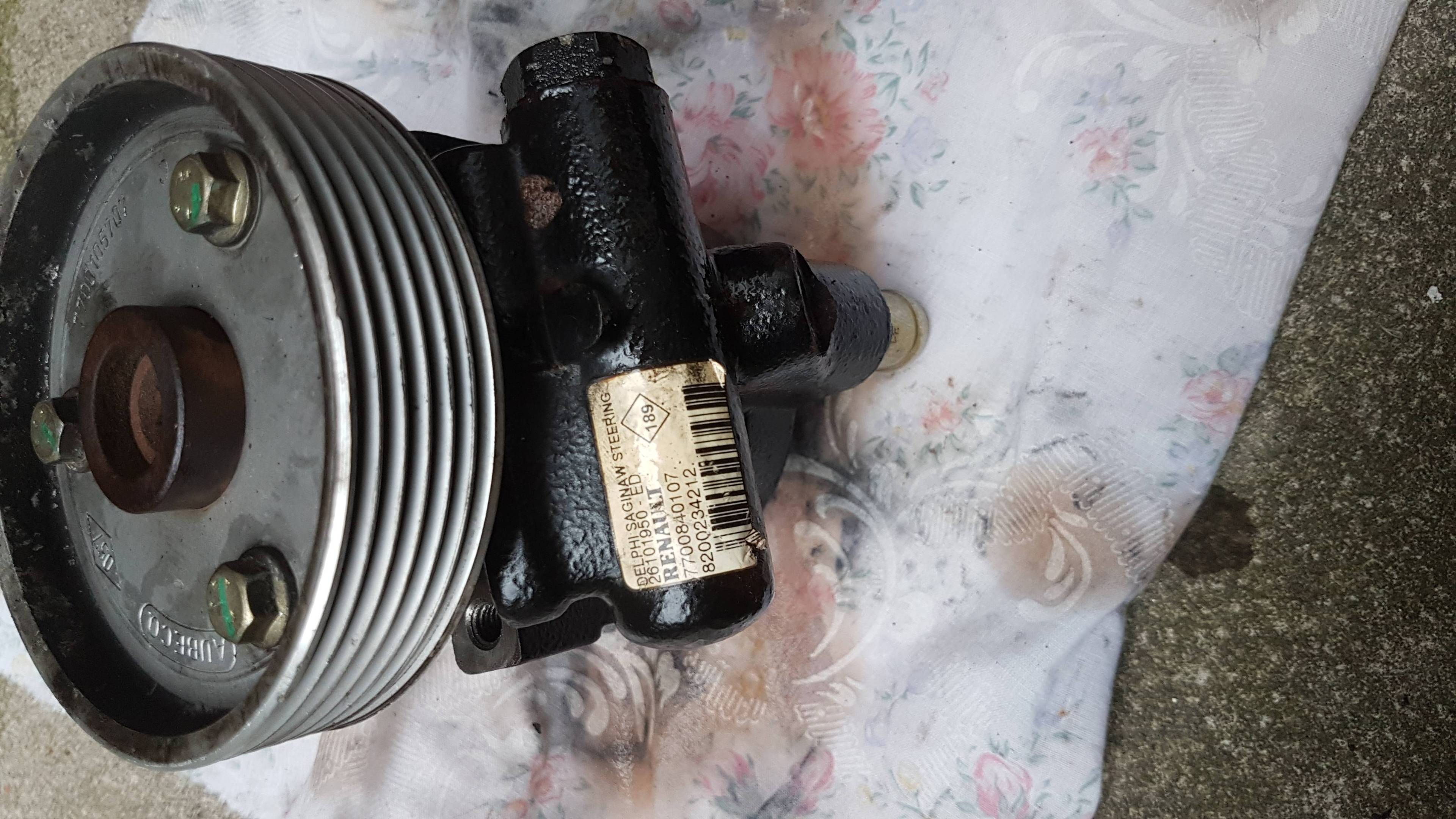

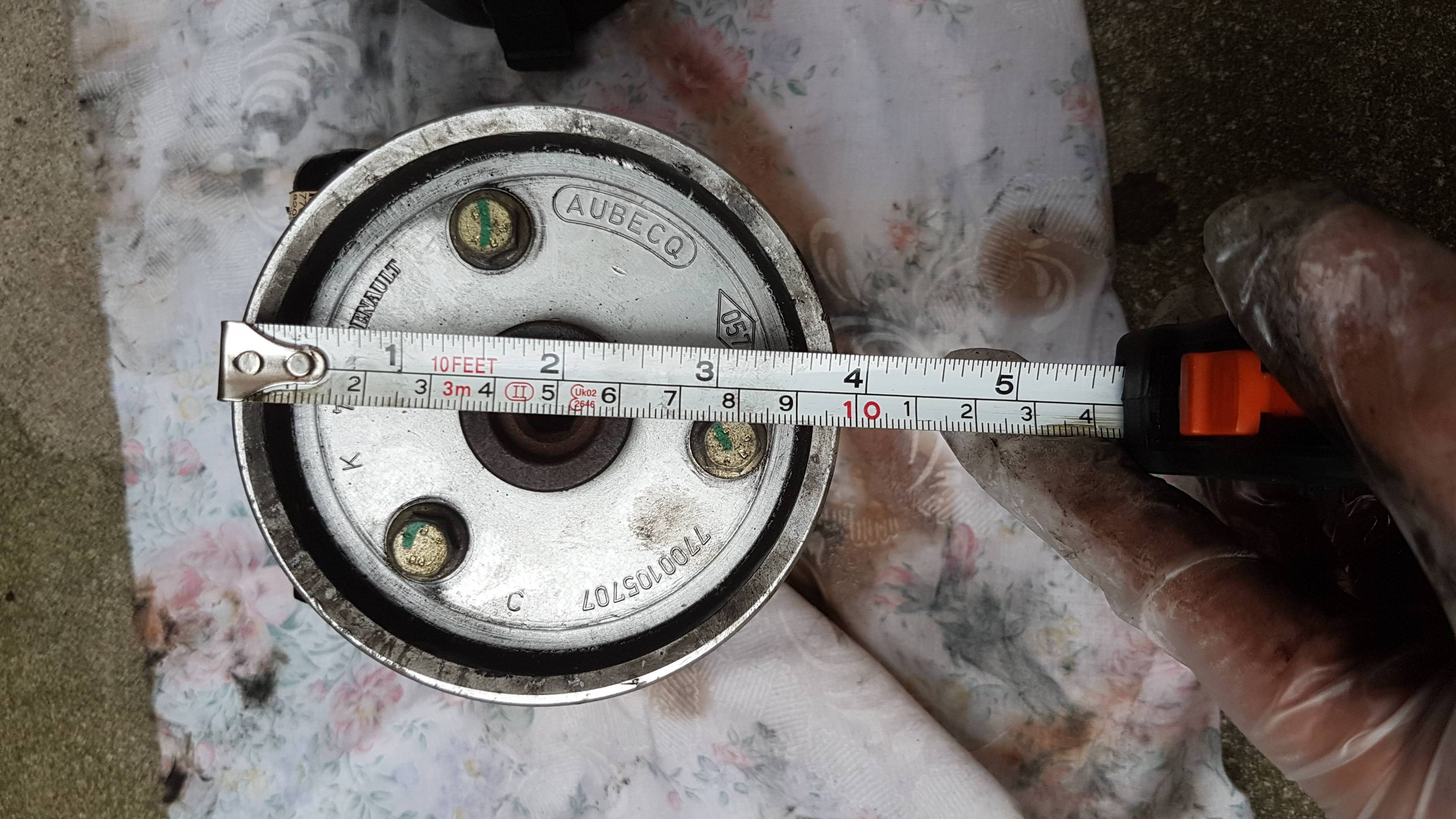

Hi Guys, so here is a comparison of the two pumps. The 182 pump has the white sticker part no 7700840107 and the cup pump has a yellow sticker 7700840105. As far as I can see the parts are identical, even measured them and the appear to be the same in all dimensions. So im not sure whats going on. In addition they both have the same play that was pointed out to me, are they both knackered or is this normal?
