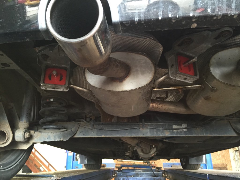

Need a new exhaust mount on the rear was thinking of the Powerflex, any real difference between the red and the black versions? Anyone had both?

I've got red and that was hard enough to fit. You get alot of resonance through the boot with them mind. I like it though:smile:
Definitely don't need black then, saw something about putting it in the freezer helps contract it to get it in easier, just don't want to buy another standard one and it disintegrate like the one I have now has.
  dan's cast offs.
they're easy. cut the rubber out from both sides and the bottom, bit of rubber grease or whatever you've got and push it in, if it won't go by hand get it in a vice.

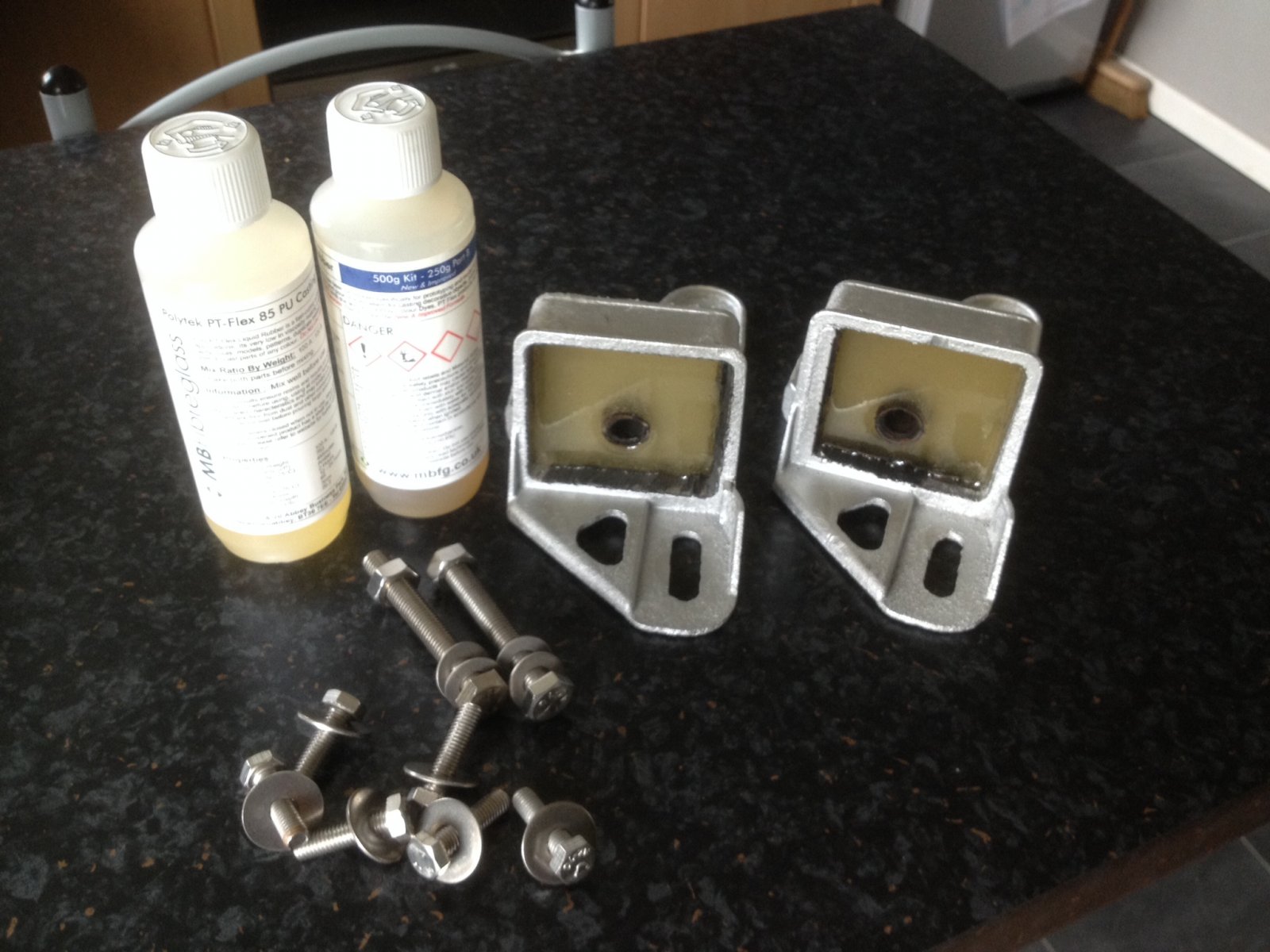

This is what I did on mine, bought a pair of universal mounts off eBay, cut the rounded bit square and put some self rappers through it, eyed it up and drilled a hole through the bush where I wanted it to sit, cost less than £15!!

Do them yourself - custom made mounts - perfect with no sagging!!!

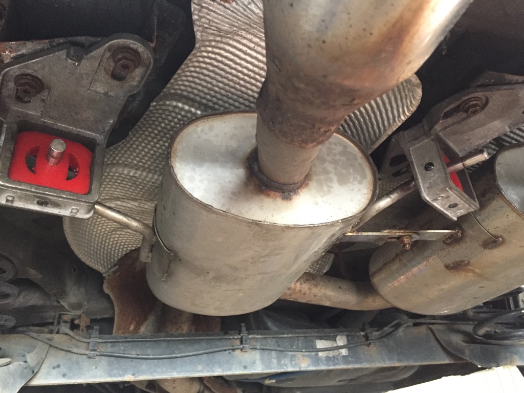

Made a custom mount using a new mount with added Sikaflex (just like Tiger Seal) no pictures unfortunately but filled in all the gaps on the normal mount and tried to force the hole for the exhaust to go through as high up as possible. Seems to have worked so far, let's see how long it lasts :smile: do have water dripping from after cat on the exhaust join though, should this have a gasket on? But fixed a slight blow between the middle pipe and the back box.
