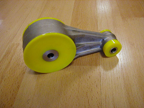

I just received my new powerflex dogbone mount kit today but i was under the impression that you got the actual 'dog-bone' with it... can anyone confirm from the pic below if this is the right kit i have been sent before i attempt to fit the bushes and waste my time.?

i would double check that before you try fitting it
ive just been on the phone to ktec about my powerflex bushes and he assures me the blue ones are for the twisted type mount :S
  PH1 Clio 172
Bugger thats all i need hahaha
the Kit number is: PFF60-211K quite helpfully the only compatability read i can find online just states "For all Mk2 Clio 172/182 models"
lol
  F4R'd ITB'd '92 cup racer
look on the ktec site under 172 engine, it shows both types of dogbone on there, the blue one in the twisted type, the yellow one in the straight type
im not saying it wont fit (although the guy at ktec said it wouldnt) im just saying check it over before spending time on it

Order one for the Clio Williams mate, thats the kit i have, as they have the straight do bones like our PH1's

at least you didnt spend an hour trying to press a poweflex bush in like me, there was no way on earth it was going in, im sure there is something wrong with it
i need to measure the centre pin for k-tec so they can compare it against another one in stock

If you look at the below pic from K-Tec's Website:
and then the kit i received:
the smaller of the two bushes doesnt have the solid steel inner... i also called Lark Speed yesterday to voice my concerns they also agreed that the kit i have is wrong and is for the twisted style dogbone :(
