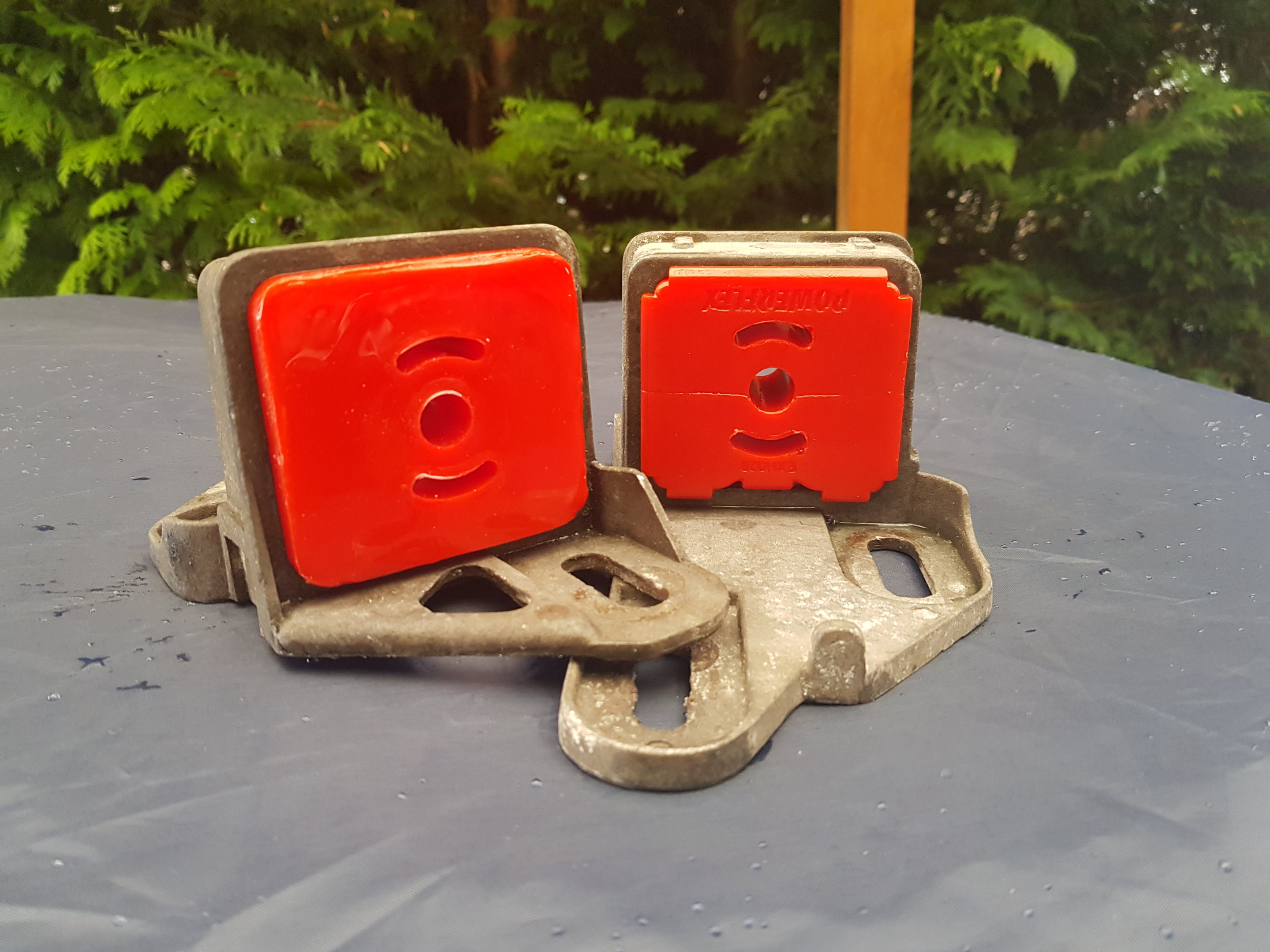

I used the red powerflex ones and got no noticeable added vibration. Everything else is black series powerflex though so maybe I just don't notice it!
They fitted really easily with a vice. Just need to make sure that all the old rubber is cut out and use fairy liquid on it all.
The only gripe I have is that the tips don't sit that high up. I'm going to modify the actual metal bracket part that these mount to that bolt onto the car when I get chance.

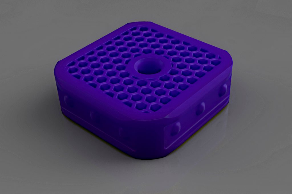

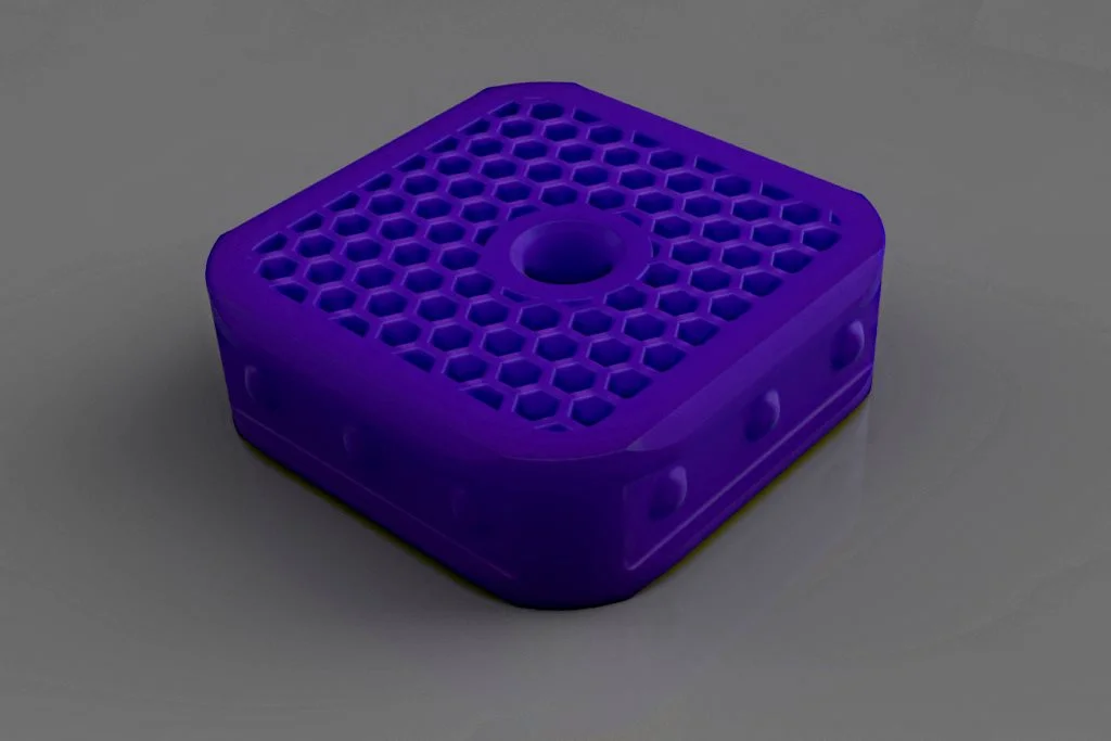

I made a custom one of those for my brother when he had the Clio, I'll see if I can find the CAD model but I can do you tailored stiffness/positioned ones if I find it.
  406 V6, Race Buggy
Can't find it, it must have been before I switched CAD setups.
Anyone local got an old one, or some accurate dimensions?

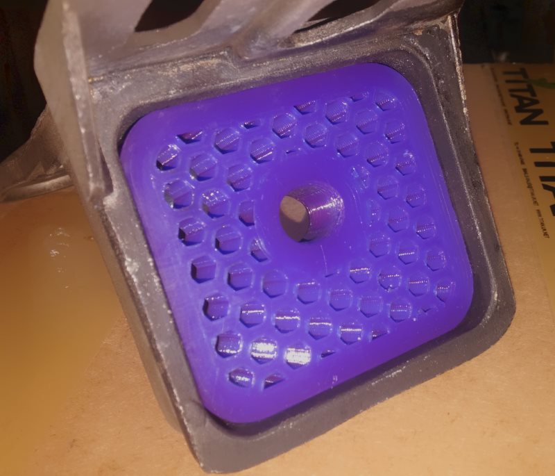

Anyone local to me want to be a test dummy for an uprated polyurethane one that doesn't also give you tinnitus and remove your fillings?

Where are you based Rich?
I've an OE mount coming in the morning to remake my CAD model from, I'll probably have a prototype out after the weekend.

Hi Phil, I'm down in Buckinghamshire unfortunately so I'm a bit of a trek from you :( I'm definitely interested in seeing the prototype though cheers!
  406 V6, Race Buggy
Yeah, I used the honeycomb on his and it was perfect right up until he sold it, so I know that'll work well.
Although his was just flat outers and just got glued into the housing - I'm trying to make this one clip in to make it easier and give it enough to cope with the housing tolerances - I made a prototype today which fits nicely but I'm not quite happy with the clips yet, so I just need to work on those and with bringing the production time + costs down, as currently they'd be more than the powerflex ones - maybe with a shorter bush that actually fastens in or similar.

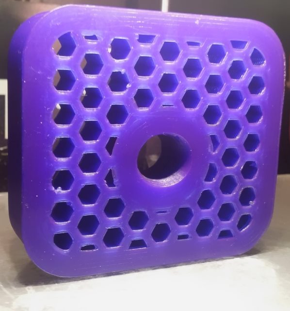

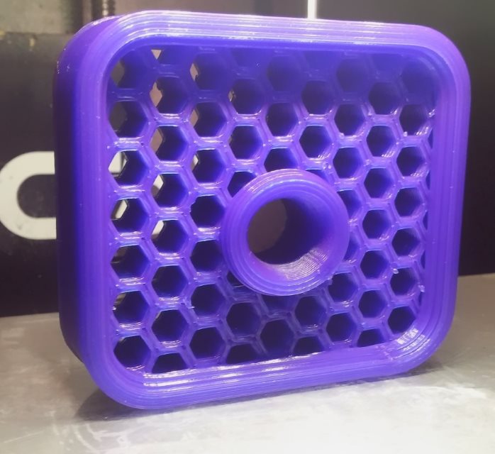

I could just do the simple ones with flat outers, rather than making a clip in one, as that would make it cheaper - they tap in with a mallet so they're pretty tight fitting - I just don't really want to find someone with a big stainless exhaust vibrates one loose :D
Although, I suppose you could just tie wrap it through the honeycomb, or add a bit of mastic when it goes in.
  406 V6, Race Buggy

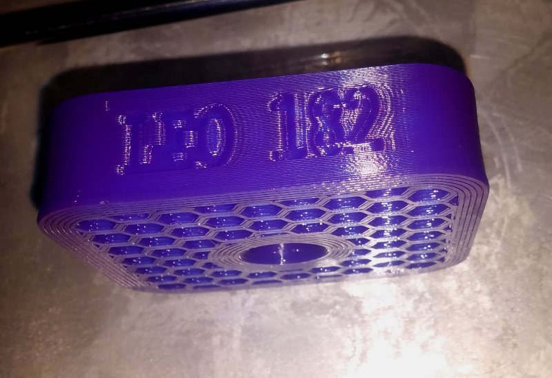

Et viola, I have also got a local victim/volunteer willing to trial them and keep popping back for me to check.
Although another wouldn't hurt, if someone is local.
Looks superb! Wish I lived nearer.
These would fix so many people’s exhaust hanger issues on cliosport.net
  406 V6, Race Buggy
I'd like to test them a bit longer to see if they retain okay and any refinements I need to make to suit different tolerances on the housings, creep over time, movement in the housing, etc - I do have a solution now that solidly bolts them in if need be, but I'm hoping to do without that to keep prices down - however if you're happy with a prototype pair as-is and giving me some regular feedback on them, PM me.
Otherwise it'll be a couple of weeks - I know the material/honeycomb lasts long term so it's just fitting I need to test - and then see about a group buy and what I'll need for trading a few of them here.
