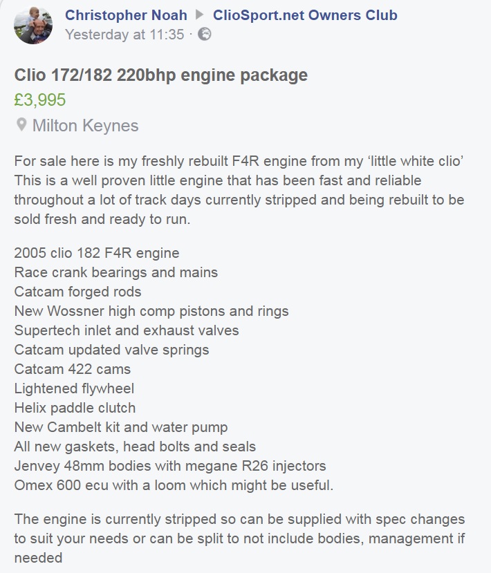

Whats needed for a reliable na 220-230 mate, and costs of parts/package?(not clioturbo)
Itb's/cams/headwork/forged internals to hit 230hp I think. Pure motorsport sells a entire engine kit that's good for 240hp. But you still need to buy their itb's/manifold etc probably around 10-12k in parts there
Wow, i didnt realise it was this much, ill be leaving it standard.
