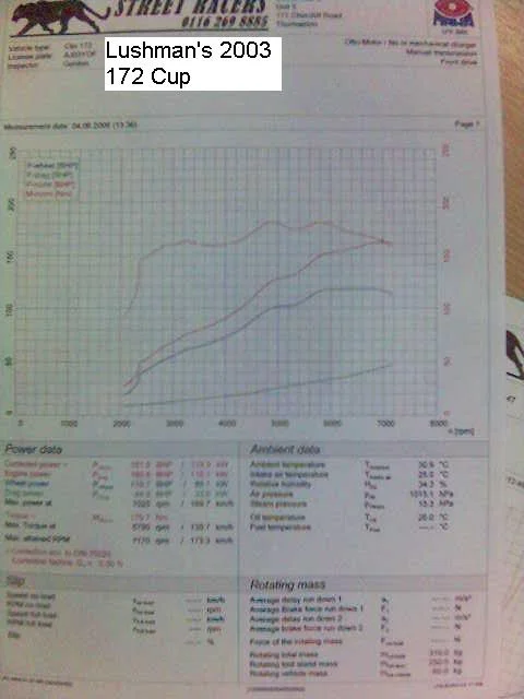

Today I took my cars to a rolling road.
With my cup having a piercross panel filter and devil exhaust from the cat back I would expect a slight improvement on the standard bhp. However it has just hit the 36,000 mile mark and is due it's 3rd service.
I had to runs with virtually identical readings. The bhp at the crank being 161 bhp with 197 torque. The car seemed to rev ok with no flat spots just down on power to what I expected
(172ish). could this be cause it's due for a service (booked in for tomorrow)? I guess I need to run it again after the service to see any difference.
I also ran my Ford Capri with a rover V8 engine.The power output for this was 151BHP as many people predicted being an old engine but the torque was 224, more than the 200 expected.

the bhp figures seem about right, but 197 lb/ft of turque seems way too high???
  Clio172cup, Capri 3.9 V8
that's because I mistyped it should be 179.7Nm @ 5780, not 197
161.6bhp @7025rpm (115.7 ATW) even so, it's nealry 7bhp down on standard I reckon a service could make for most of it.
PS I do have the decat ready to fit and will try again soon and let you know how I get on.

No offence, but that sounds bloody low! I had my Cup done when it had 8K on it, and it was standard, came out with 145bhp ATW (IIRC). Chris n Nic's cup got a bit less (with IK and new exhaust) and Pete's Cup came out with a couple more horses with some filter/ECU and exhaust work (This was about 2 years ago, so could be a little out with Mods!) I can't see there being a 30bhp ATW drop with these mods.
Try another RR and see the figures, as they could be out.

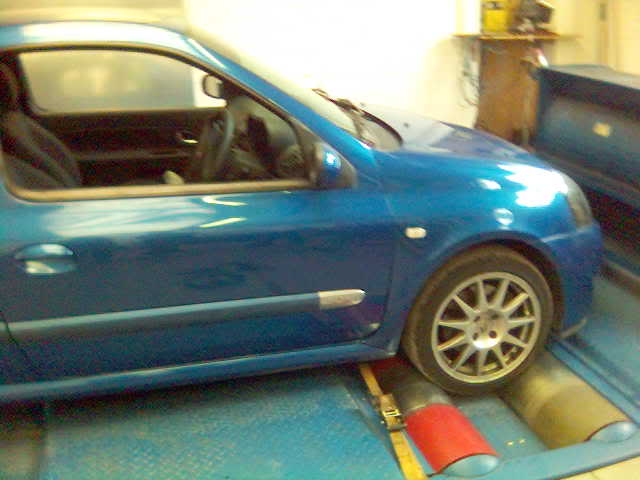

thanks all I have some more info that may add to the low BHP.
It went for it's 36,00 miles service and found the drivers side front brake was binding.
here's the Graph
and my car on the rollers
please excuse the poor quality pics.
