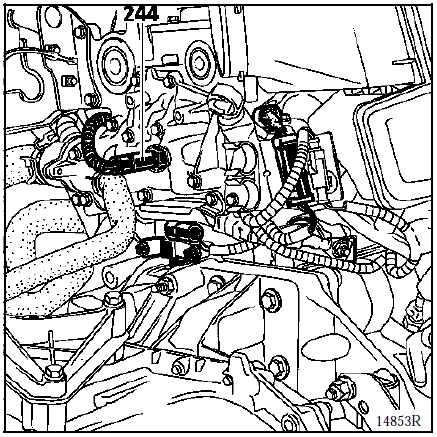

Right, can someone please confirm to me that the coolant temperature sensor is NOT the thermostat?
I'm led to believe they are 2 different things, however looking at Renault's crappy pics in the workshop manual it would suggest the location of the coolant temperature sensor is where I find the thermostat. Or I'm just missing it.
I can't make head nor tail of this pic... someone please help :) the bit labelled 244 is the coolant temp sensor, worlds most odd pic, what angle is it looking at the engine from???

Yeah the CTS is on the thermastat housing. Try replacing that as its cheap enough and if its old, then itll soon need replacing anyway. I'd chuck a new stat in too at the same time. Also take the throttle body off and give it a good clean and then see how that leaves ya

Cheers chaps, I finally located the CTS and the thermostat earlier so tomorrow I will take the air box off and have some fun :)
