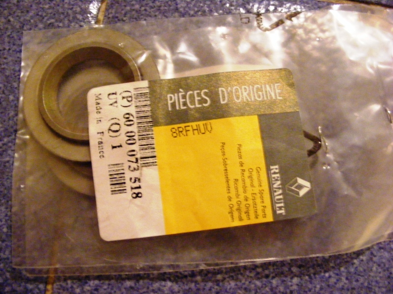

Has anyone got any pics of the rear disk spacer? Either fitted or just loose, just so I know what they look like.

Its a bit bigger than a 10 pence coin and is flat on one side and the other side is shaped. Almost like this |)
Iirc the flat side goes against the stub axle.

It's a lot bigger than a 10p coin.

Cheers guys.
Confirms that I am indeed missing them on both sides! 8 track days and 30k road miles and my wheels haven't fallen off though, so clearly not the major issue people think they are!
I will need to grab some, and also some replacement 30mm hub nuts. Where is best to get them from?

You've been lucky. I had to replace a bearing before a track day after I'd replaced it the weekend before and forgot the spacer!

When i fitted my disks and bearings without the spacer my wheel wobbled quite badly. I blamed it on a dodgey bearing so sent it back and got a new one. Obviously the new one was the same. Then i found out about these things:confused:
