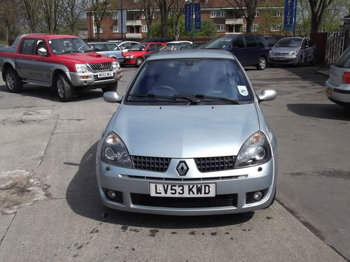

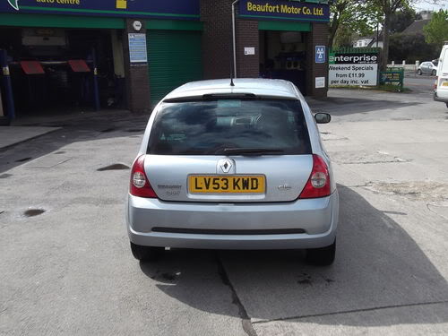

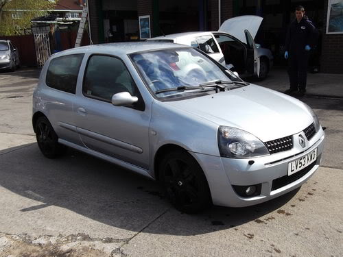

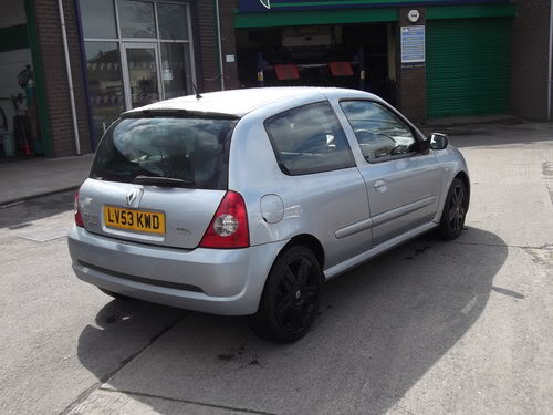

Today i slapped a deposit down on a 172. Now i've been creeping on here for a while and the Type R forum too but i finally decided to dabble in a Clio for a few reasons:
Insurance cheaper, better MPG, Cruise Control, the seats are more comfy and the corning is just as fun.
A bit about the car:
£2400
2003 53 plate so has all the little gadgets minus sat nav.
37000 miles
FSH With belts done at 25k
Went through it thoroughly, i was there almost 3 hours going over stuff. No issues with the clutch, lights, sensors, engine mounts and the washers worked but it was more like a drizzle so thats something to look at.

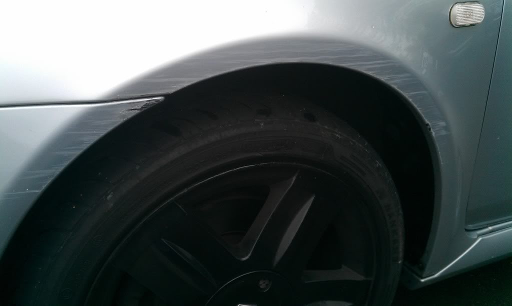

But the two main things the car needs: A front tyre, any suggestions for a decent tyre for a good price?
And there is a scuff along the arch and this should be getting sorted at some point next weekend.
Pretty damn excited to have something different after 3 years of Saxo VTR. Noticed a few interior plastics fitted together oddly or seemed loose, so i'll probably be bugging you guys once i get the time to give it a serious once over and get picky with it all. But for the price i couldn't really complain about these minor gripes. Looking forward to the drive home tomorrow and a good clean assuming it doesn't rain. I'll try and drop y'all some photos.

Here is said scuff and tyre:
I've been told it would be about 100 quid by a sprayer i know. So thats not too bad. Hopefully it will come out ok!

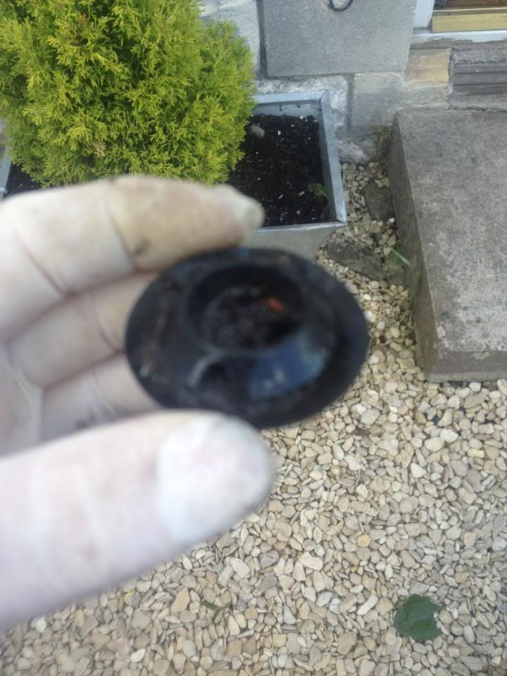

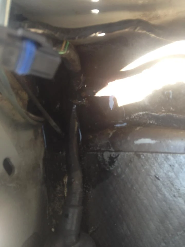

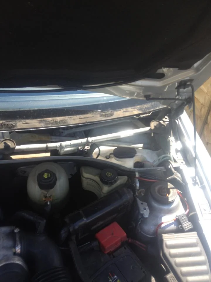

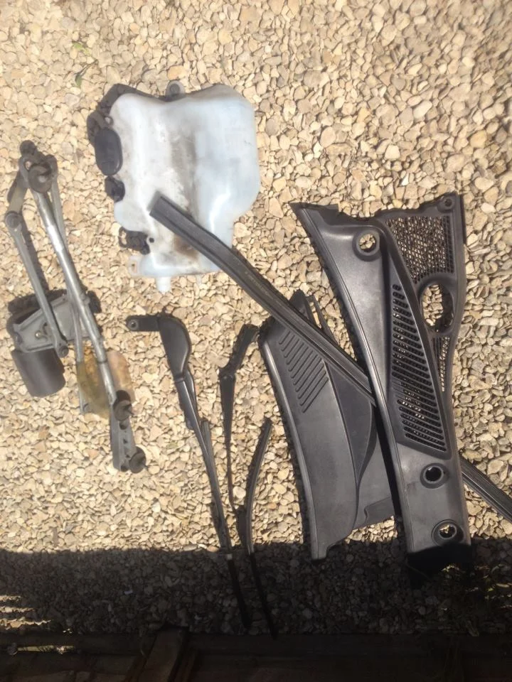

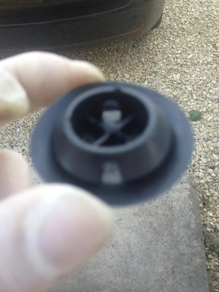

So the first bit of sadness came in the form of heavy rain. In June there was some terribad down pours in Somerset. Low and behold i couldn't walk to the gym one day, so popped my bag in the passenger footwell and off i went. On arrival i realised that the bottom of my bag was damp, cue the horror. The passenger footwell was absolutely drenched, at this point my heart fell out of my ass and i wished i listened to everyone who told me to avoid all 172/182s like the plague.
Straight to the forum i went and found out it could be as simple as something as a blocked drainage hole rather than every sill and bit of rubber failing. Off to investigate: All credit goes to my old man, We had to take the whole wiper unit, windscreen water and plastics off to get to a bit of plastic probably less than 2 inches in diameter. It was absolutely clogged with crap and needed to be cleaned. Ever since doing this the footwell has been stone dry.
181261_10151022900662790_2081501768_n.jpg Off with it all.
600340_10151022888177790_1630908953_n.jpg All off.
564364_10151022890957790_1180110422_n.jpg Alot of water where it shouldn't be.
http://i1085.photobucket.com/albums/j437/Leonzee/168838_10151022894372790_405794782_n.jpg This was the little bugger causing all the problems.

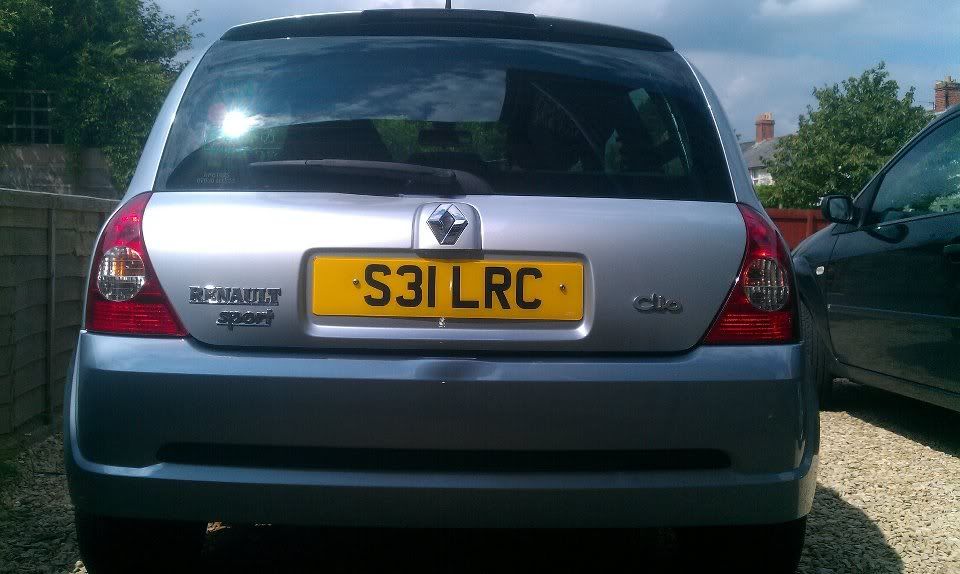

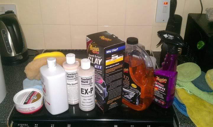

Next thing you know it was my birthday, absolutely spoilt by my misses and family I got a registration and over £100 of detailing products. Over the moon, I went about giving it the best clean I had so far. In all I was out there about 7 hours. The pictures don’t do it justice but the only thing i had was my HTC, not some fancy Nikon. On inspection there were only 1 or 2 spots that i noticed once i got it down bare, really happy with the lack of swirls. Collinite wax is epic, no two ways about it. I applied two very thin coats to it at the end of the long list of applied products and it’s still beading water in uniform on 95% of the car over a month on. I have no doubt it will last the winter.
http://i1085.photobucket.com/albums/j437/Leonzee/547787_10151140574615923_1622961473_n.jpg The products

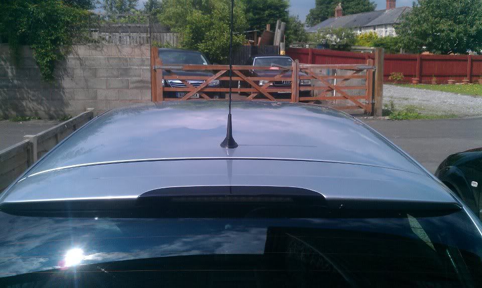

The other thing that’s starting to bug me is the rear wiper. It's KO'd and I’m going to take a proper look at it tomorrow. If you have a look at the pictures you can see it's stuck in that position. Think I might just dewiper it as I wash the car once a week so the back window never gets dire. While I’m at it I’ll probably attempt to remove the RS badges. Any tips for these?

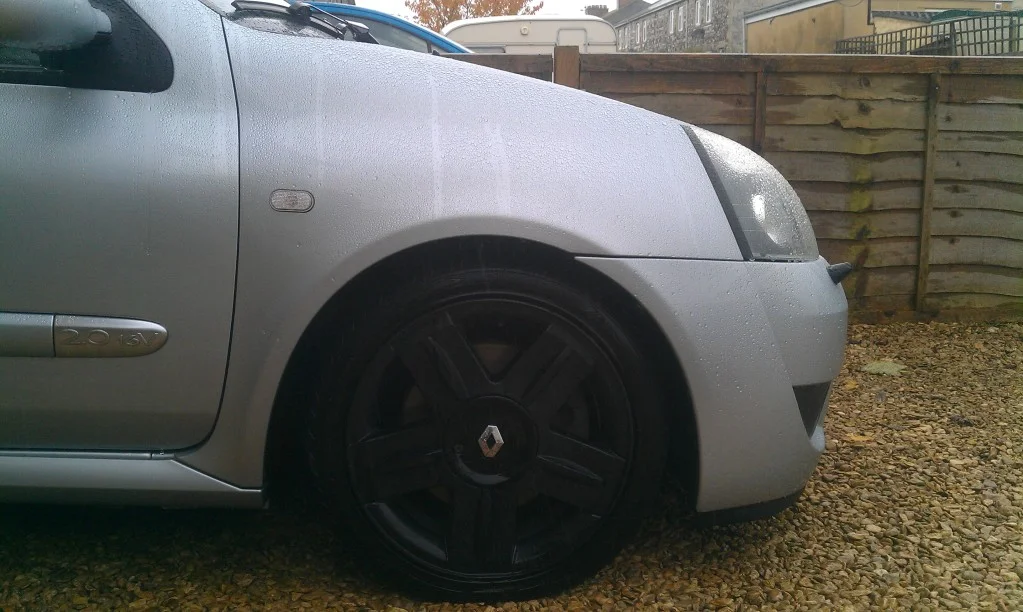

So more on my pathetic attempts at detailing the exterior. My first attempt was towards the end of July/August. The difference in the depth of colour and overall quality of look was amazing to me then. However, as we all know with detailing it gets better with time. There were a few more additions to the party of products this time.
1. So to start I rinsed with a hose to get any bulky debris off. Then i moved onto the Nilfisk to get any more stubborn bits shifted.
2. Once I did this I got out the Citrus Power and started to apply to the areas that needed more attention. Particularly the side trims, badges, handles and locks etc. Then after I let this work for about 15 minutes with the assistance of a bit of movement you could see these areas really being lifted of dirt.
3. Rinse again.
4. On close inspection the tar deposits on the paint weren't major and any real problem areas were attacked with Megs paint cleaner, which were literally a few spots. Then the whole car was Iron X'd for the first time. Needless to say there was purple everywhere!!
5. Rinse again.
6. Starting with the wheels I broke out the Megs Hot Rims and allowed it to work away. Rinsed them down and proceeded to wash the whole car with Megs Gold Class (now have Wolf Chems White Satin) and the lamb’s wool mitt.
7. Rinse again and repeat 2 additional times.
8. Now I moved onto the clay (Megs clay kit, but bought Bilt for next time XD), the paint was already feeling pretty smooth but there were some areas that needed to be brought up to the standard of rest of the paint, these were the flatter areas of the car. Nonetheless, the whole car was done in the same manner. I done this with a single bar broke into segments.
9. Rinsed again to get off those white trails from the claying process and dried ready for the various stages of polish and protection.
Before I layered up the new protection I had to address the waxing errors from myself and the previous owner. The best way to do this is FAIRY WASHING UP Liquid. Yeah I said it. Now I’m talking the smallest dab ever on a microfiber and this stuff will literally eat the wax off the plastics.
Now this is the stage that I thought improved the most. It wasn't the products that changed quality, it was the way I applied them. The first time I did this I felt like I rushed it, I used old applicator pads that were misshaped and past it and my prep wasn't as thorough. This time, I had a whole set of applicator pads brand new and a lot of time with no distractions.
1. Polishing: AG Super Resin, I think next time I’ll get something like SSR unless you guys know of a better polish for the 'Berg? But it definitely does a respectable job at removing minor swirls and marring which all this paint needed bar one area on the roof. However, I feel like the depth of colour could be a little better for sure if it was slightly more abrasive to remove those more oxidised flat looking areas.
2. Glaze: PB White Diamond, now this stuff is beast, literally after just these two stages you could leave it. It really brings the paint to an even finish, with a wet look, while bringing out the blue flake in the 'Berg paint. A must for this colour.
3. Sealant: PB EX-P, a really decent product at getting the shine of the paint and reflection to a decent level. Maintains the groundwork of the other two products too while giving an initial layer of protection.
4. Wax: Collinite 476 Super, anyone with a light coloured car knows this stuff is like putting a top coat on your car. Nothing degrades it for months on end. Really finishes the shine to a great level and the beading as you can see is next level.
On the tyres and trim I used CG New Look and this was great on the trim. Only lasted two weeks on the tyres but looked great the whole time. As you can see I went right up to the wire with light and if it was better lit the camera phone would have done it even more justice. But you can see almost how good it looks and how reflective you can really get silvers with patience.
Also got some silver visions and LED side lights, somehow managed to knock the xenon out in the process so it's aimed a bit low at the moment but nothing drastic. And the LED side lights are dead ... felt like a waste of time really. So yeah, now I just give the Clio a mop over once a week and most people that have seen this car will vouch for how great the paint looks all the time. Worth the work if you have the time to do it!

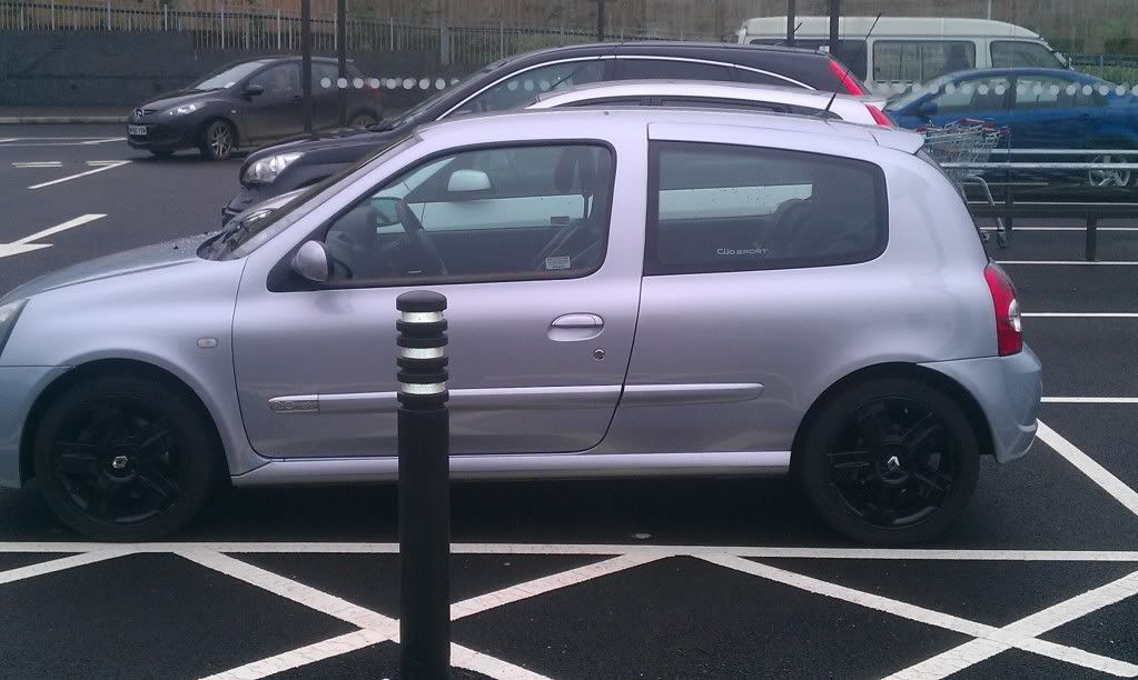

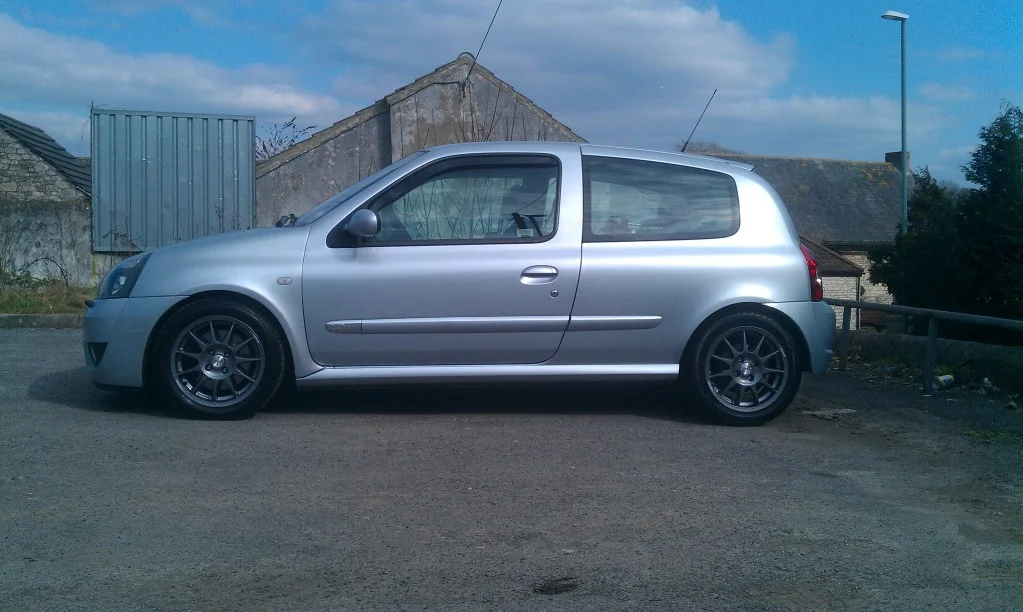

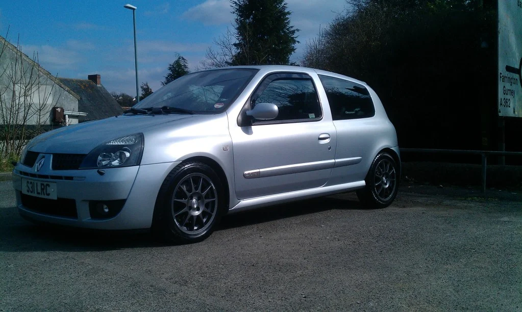

In the meantime I got a little fed up with the OEM wheels. So I decided to go for some lighter wheels in the form of some 15" speedlines.
  Iceberg 172

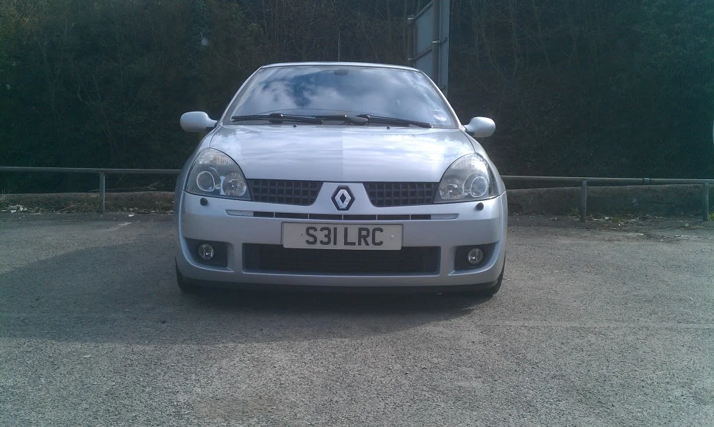

So this is how its sitting at the moment. Really quite happy with it. The body work is in better condition than when I bought it too. I think on my next detail with some new techniques I've picked up and the swirls on the bonnet will be cured :) plan on keeping it for quite some time once I've set it up!
Next things to do are a big service with plugs etc and the rear pads need doing too. Then ill be happy.
