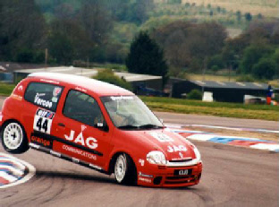

Were the cup racers phase 1 with phase 2 fronts then? Do you have any pictures pal?
  182cup & 172 racecar
2001
  2001 CLIO 1.9 DIESEL
Thanks for that, so is that a newer shape car with a phase 1 front end?
Really want a definitive answer so i can get some bits ordered lol.
Cheers
?, I'm confused now.
That's a ph1 with a ph1 front end, then when the ph2 came out, they just changed all the front panels to make them look like new cars.
They did the same with the 197 and the 200, just to make them look like the newer showroom models.

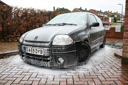

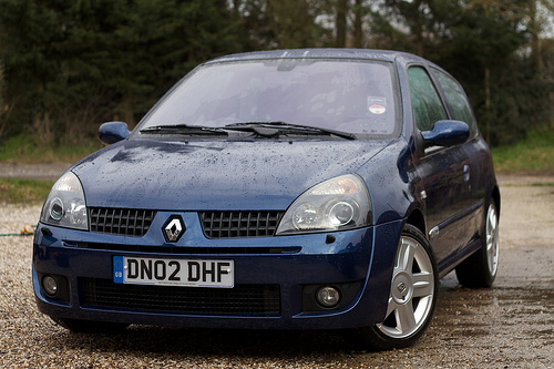

Mk2 Ph1 has the rounded lights, like this:
Mk2 Ph2 has the triangle lights - it's literally just a facelift - like this:

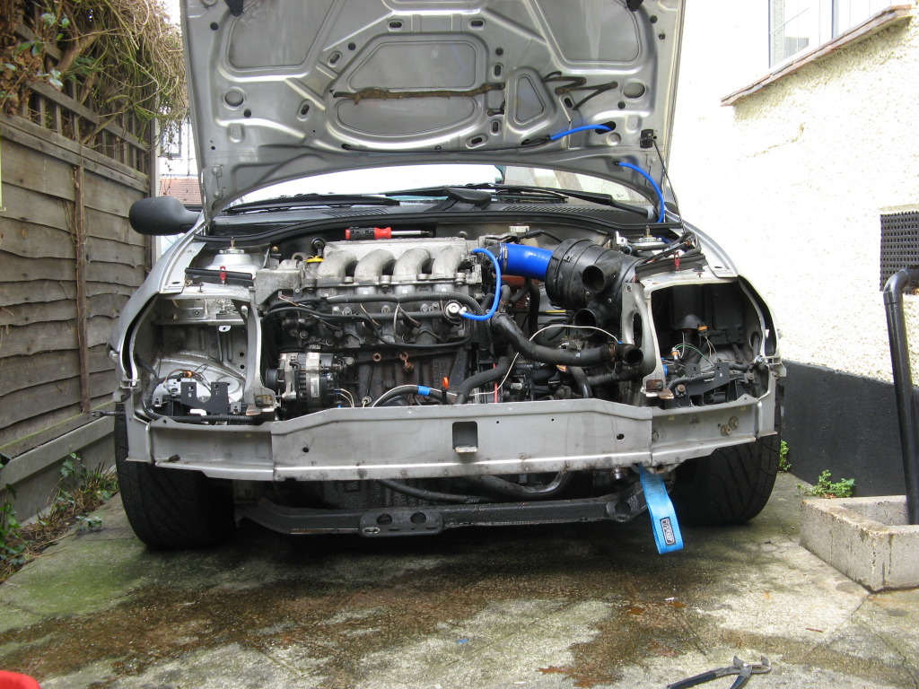

find a pic of a ph2 with the front bodywork removed and compare the two!
thats my ph1 with the bumper and lights removed, (sport wings still on, sorry)
would be insterseted to see the outcome as ive always wondered this!
  alien green rs133
I have done it. you have to replace the slam panel and the bit that goes around the headlights also you need to modify the bits that the bumper/wings mount to. its alot of work, your best bet is to get a complete front end off a ph2 car, (from the struts forward) and start cutting + welding :rasp:
