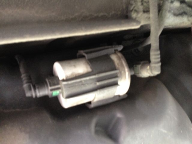

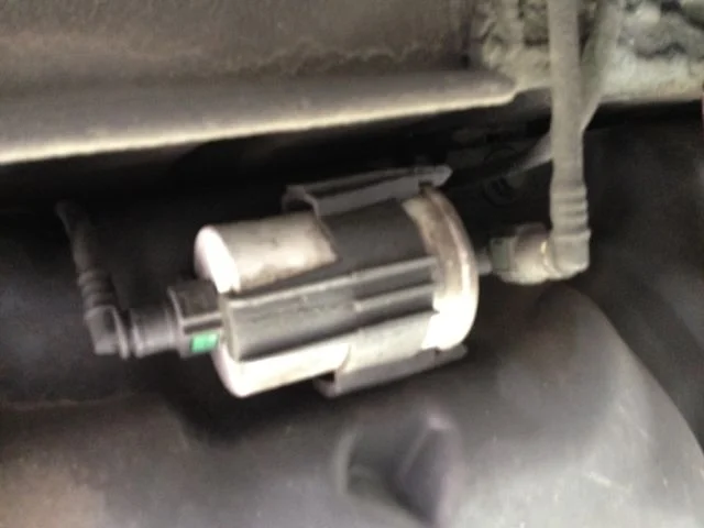

On my ph1 it's under the car towards the backend alloy silver cylinder type where the fuel line clips on both sides the new type black plastic .

That's the one , the new ones are black plastic when you change it squeeze the green bits in on the plug which clips on to the filter .

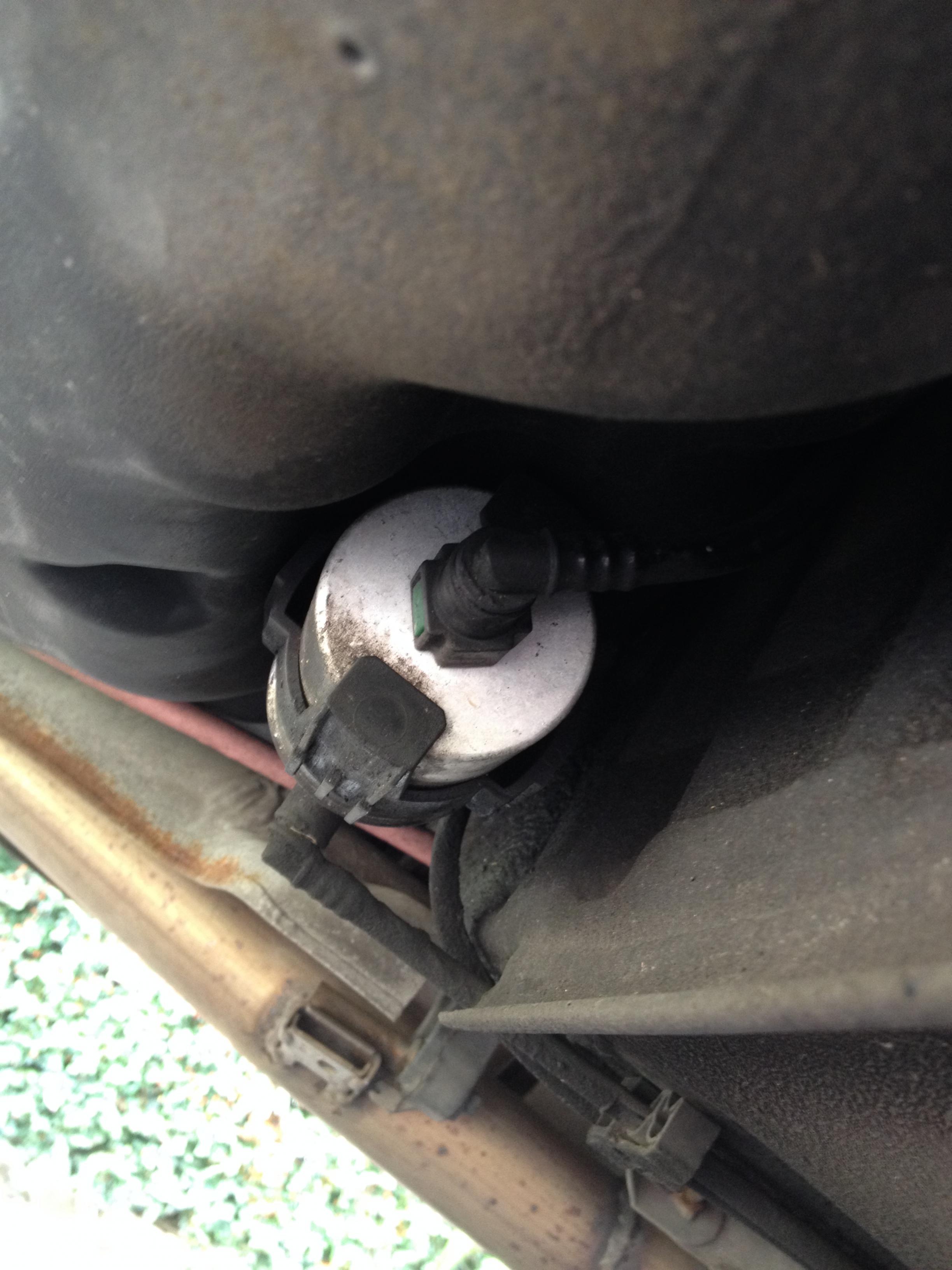

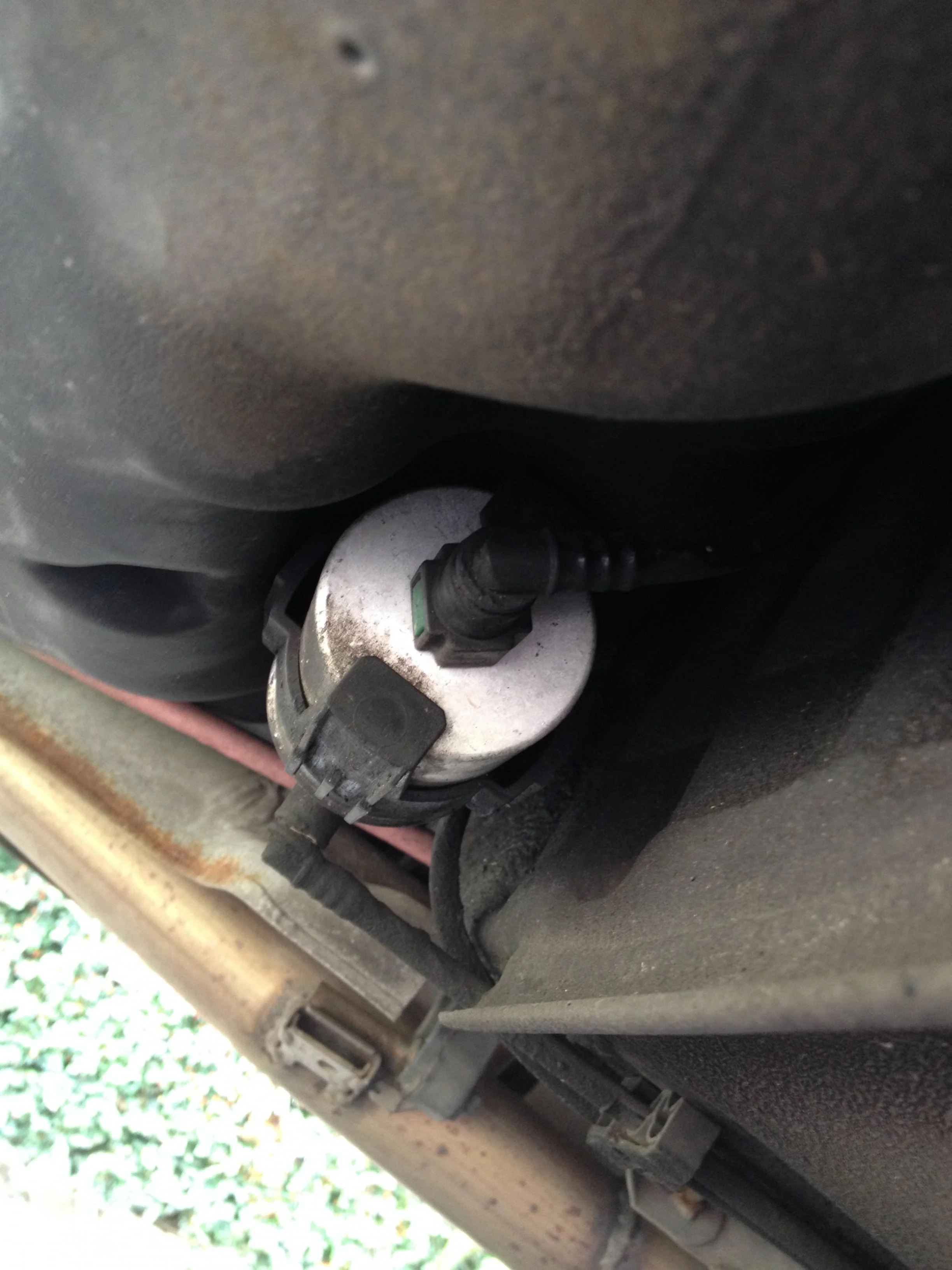

Thanks, thats on a Ph2 registered 1st March 2004. Do you know the service interval?

Don't know the service interval on them but I changed mine around 70k they don't cost a lot and no time in fitting a new one
