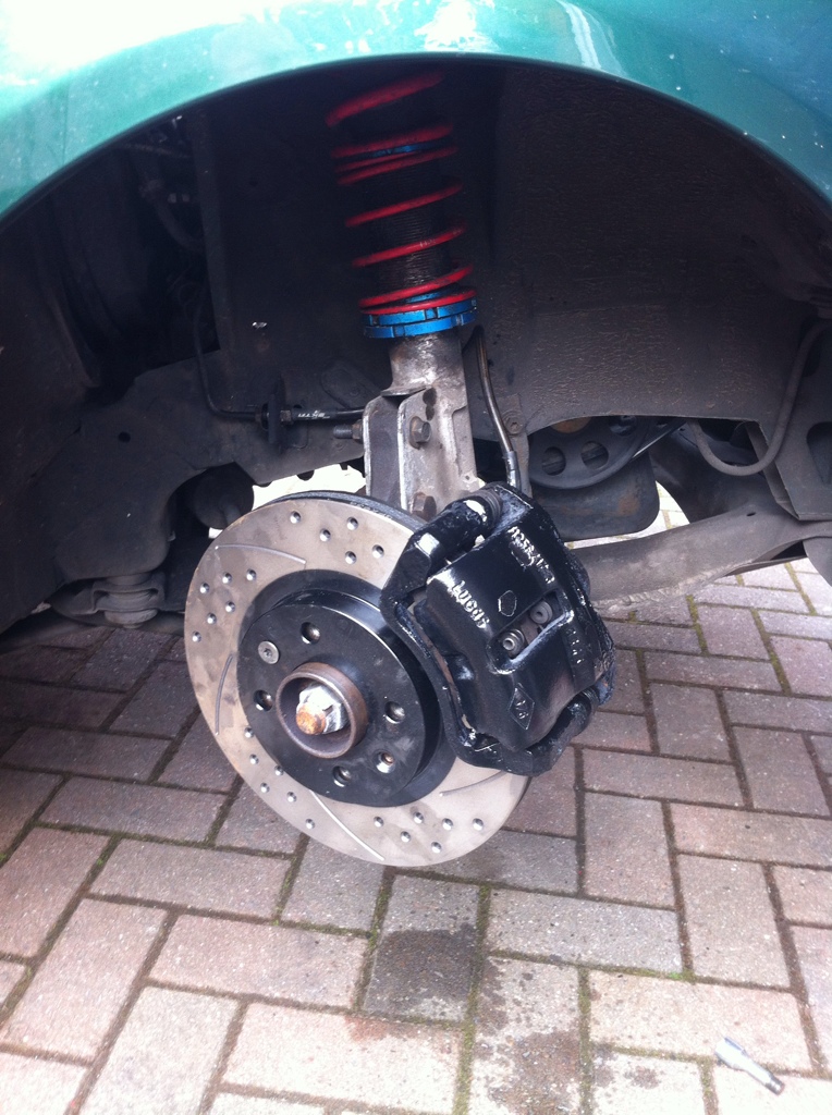

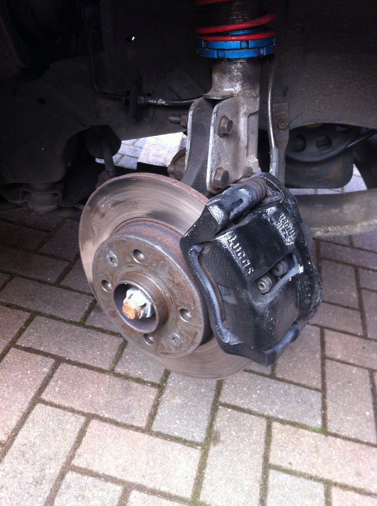

Before:
During:
After:

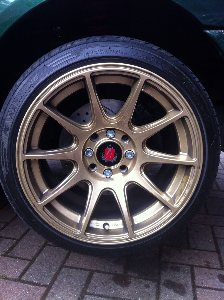

Notice the change from 239mm solid discs too 259mm vented ;) woo!
  172 Flamer, BMW E46
Erm, brakes cost me about £80 to convert in total,
Braided brake hoses i already had,
callipers £20
Carriers £20
Discs roughly £35
yes its all a straight swap :)
  172 Flamer, BMW E46

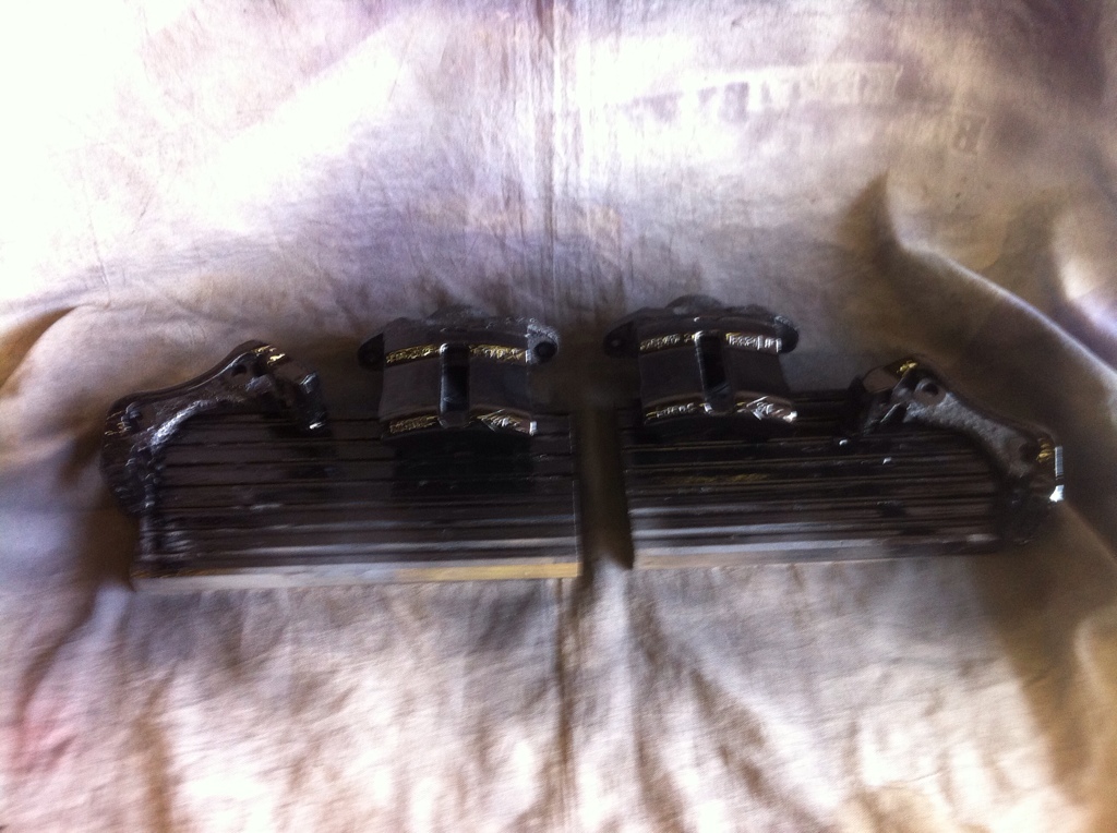

From The scrapyard locally to me.. theres loads on ebay but i wanted to check the bleed nipples werent seized..

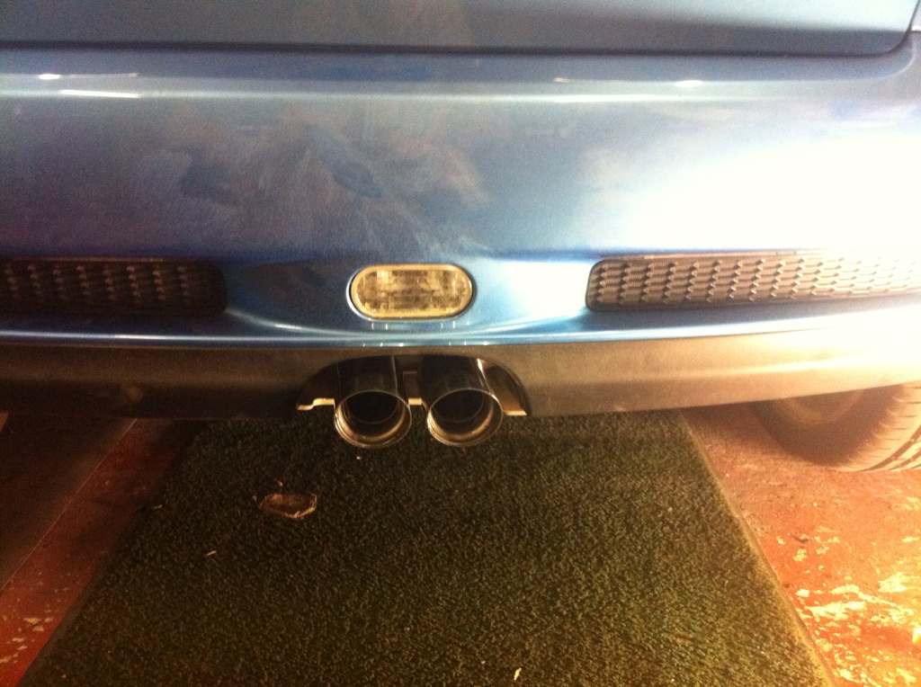

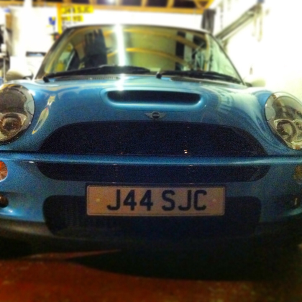

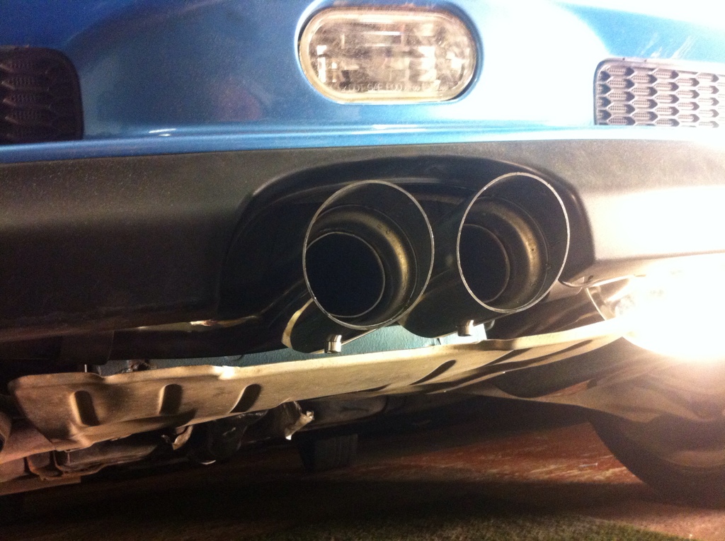

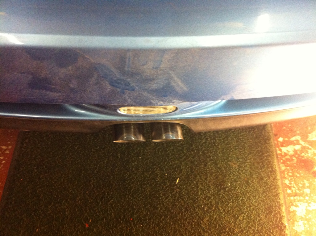

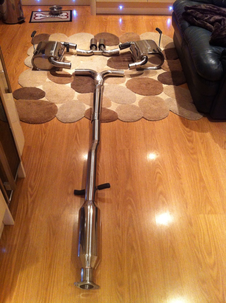

Thought i should give you a little update on the cooper S aswell.. changed a few things over the past week... ill start a project thread when it gets serious ;)
Cat back exhaust
Gloss black grill
