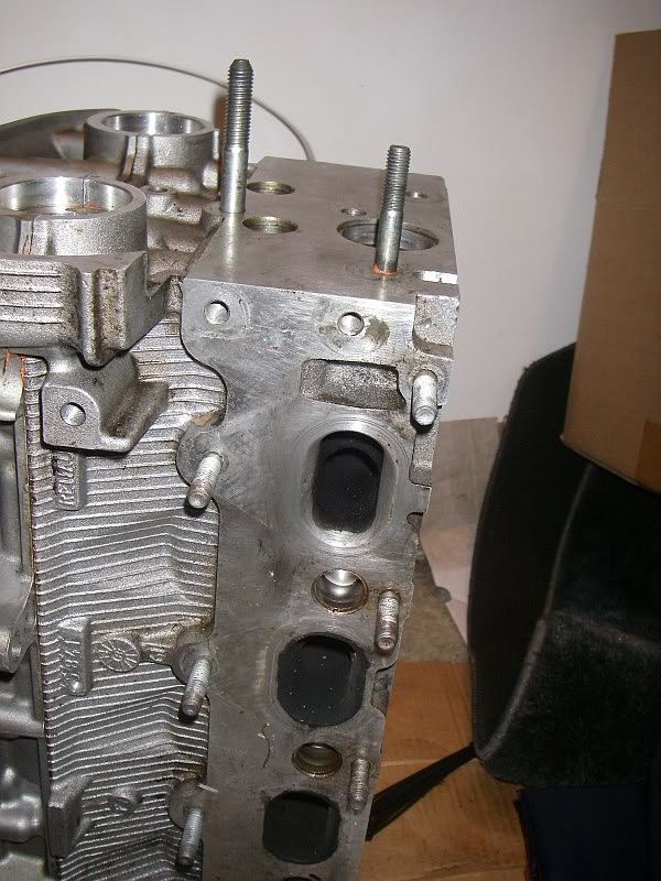

Ive got a few heads in the garage, one is a 182 head and the other is a 172 but I'd have to check the ID to see if its a phase 1 or 2. I'll take a pic of the exhaust ports and upload them if it'll help...

Ashy, does the 182 head have a taper into the rectangular port (~4mm chamfer) or is it flat like the yellow head?

thanks Ashy, it looks like the 182 has the chamfer I was talking about.
I'm not set up to measure exhaust ports. I have seen 2 flow bench tests on clio sport heads, one flowed 80CFM at 11mm lift, and the other 110CFM, I'll let you work out which is which.

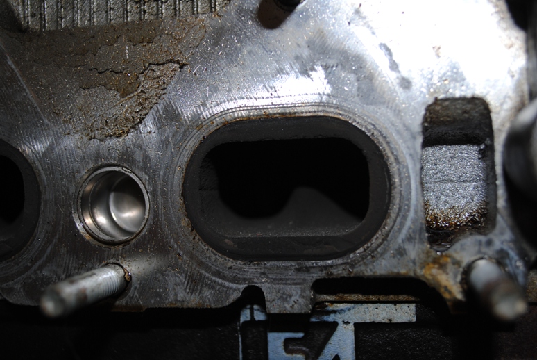

I've given it a bit of a clean, and taken a pic, it looks like someone has been 'shaping' it with a dremel
Valves are the same.
That head you have their Andy has certainly been fettled with, looks like a horrible job tbh.
yeah, you have to wonder why though, Renault would have put that step there to reduce reversion, that chamfer will have reduced that, but done nothing for flow. It looks to be the only change made, so it'll be fine to play with.
