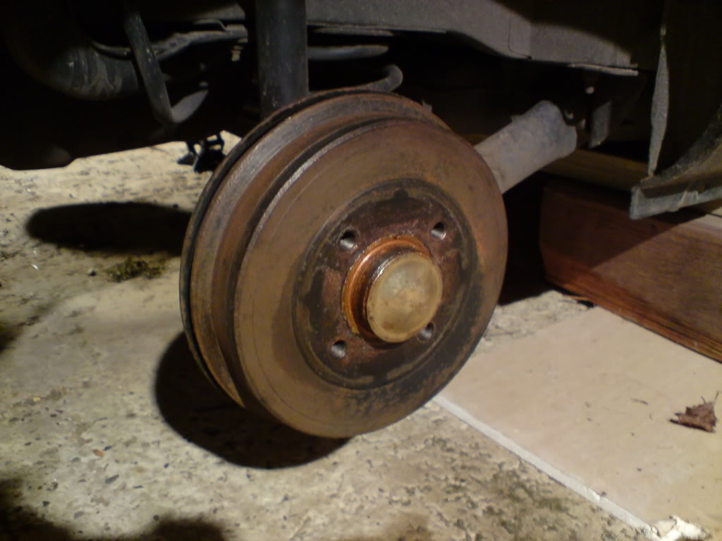

the other day i was bored and it was a nice day so didnt want to sit inside, ended up outside painting the car! looks much better than it did before IMO, just need some "proper" brakes now!

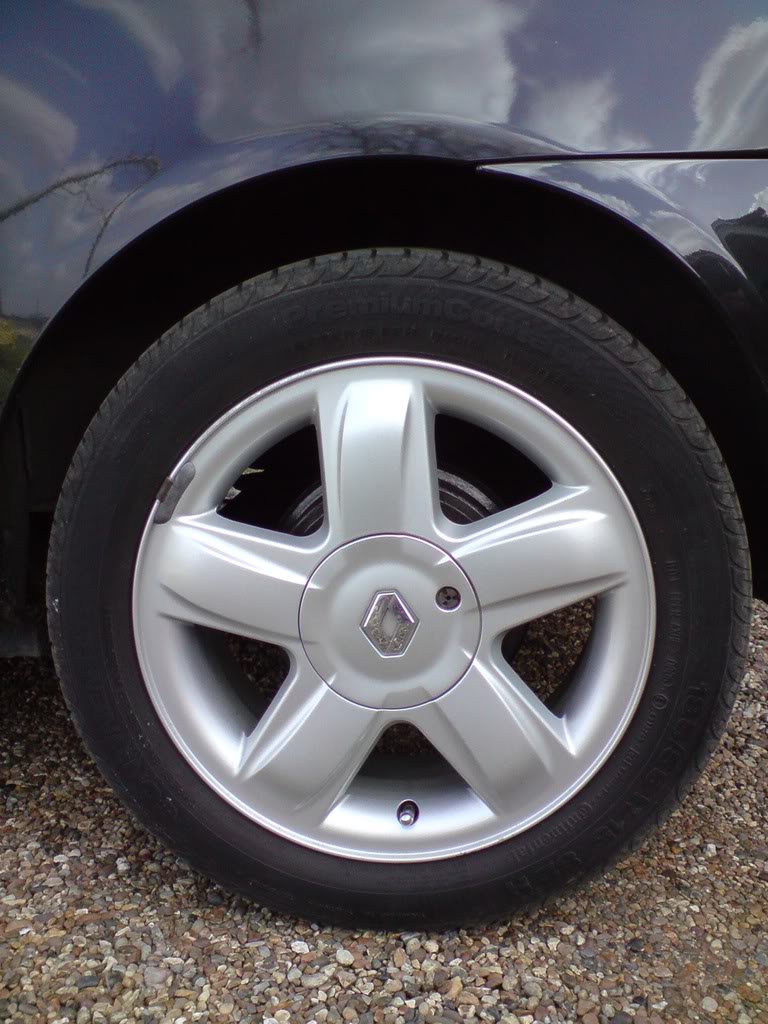

took the wheel off:

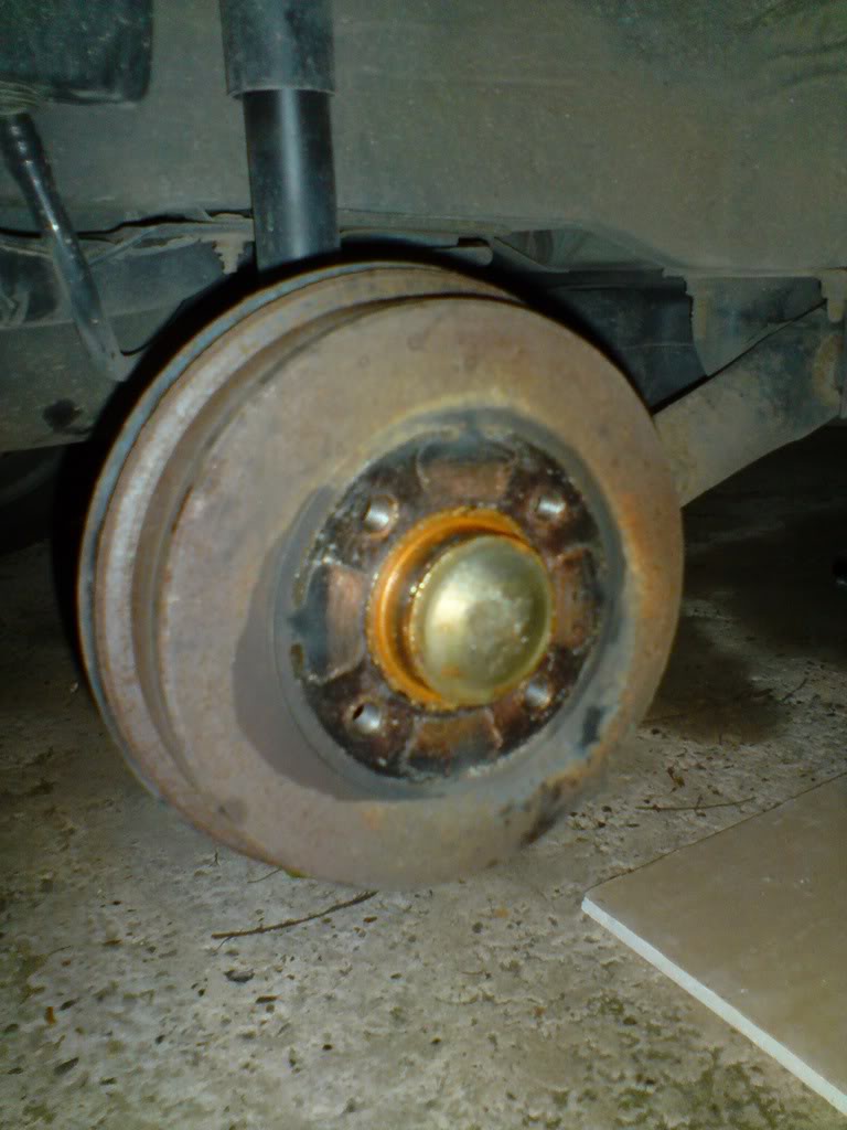

bit of prepping:
on with the paint (pic looks shite and not covered well but thats just the light on the new layer of paint:) :

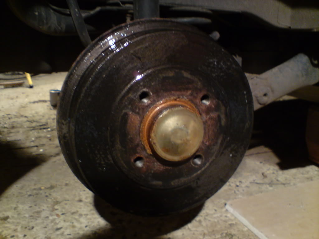

drums...done!

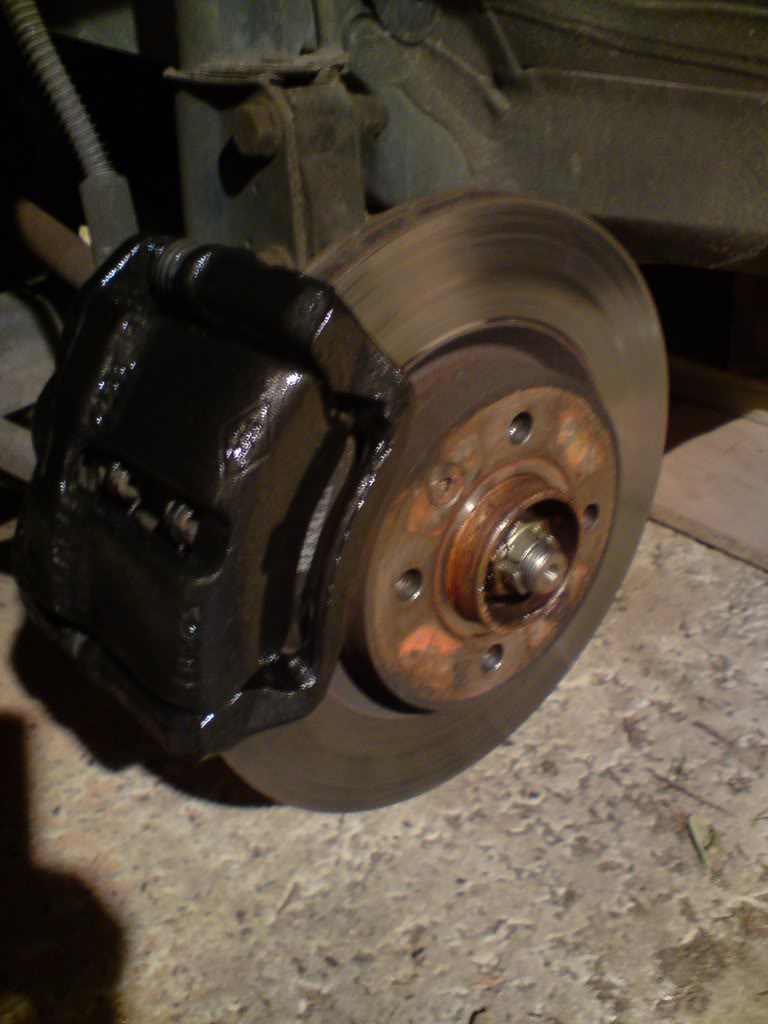

then the calipers

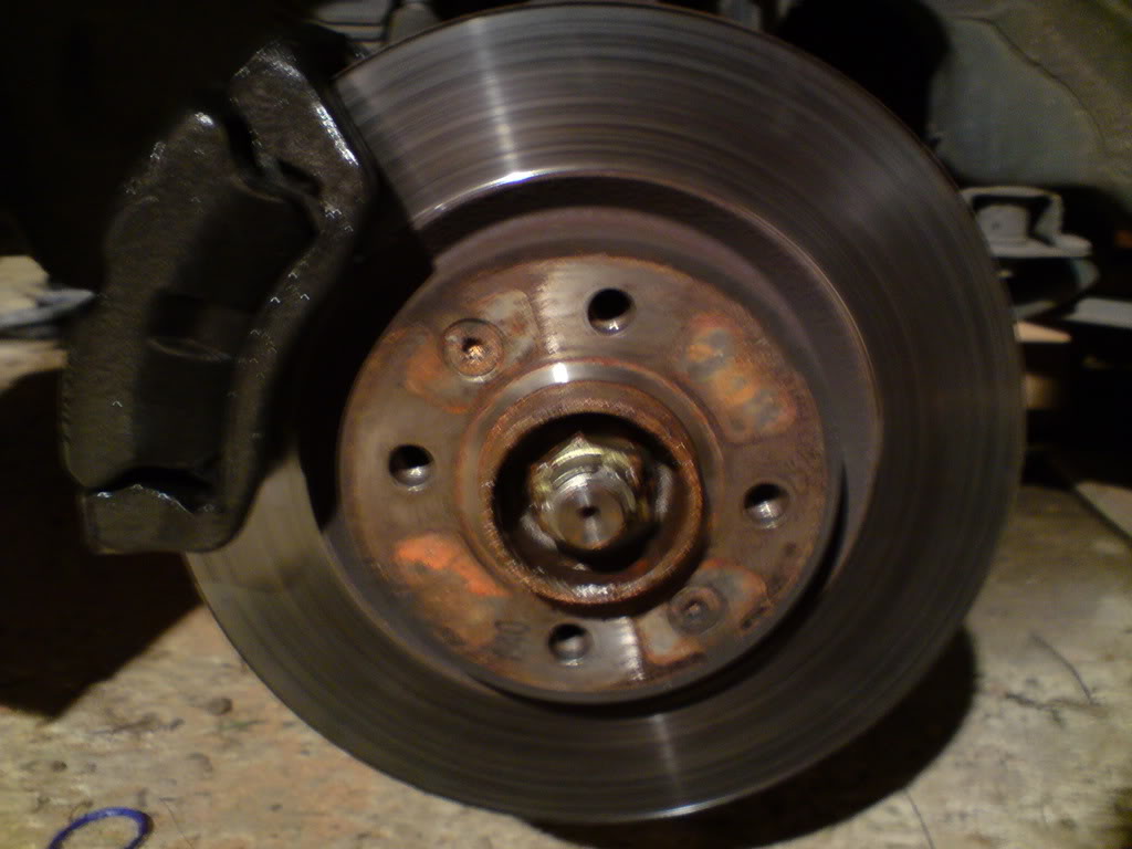

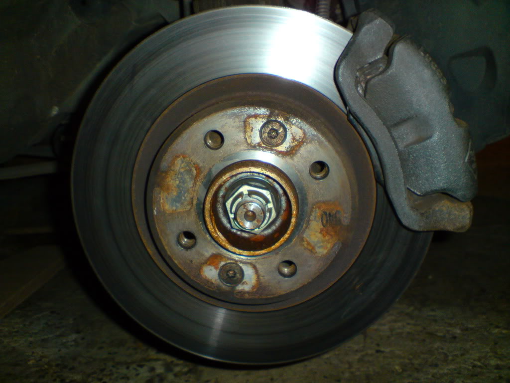

after a bit of prepping:
then the paint:
thanks for looks, and ignore the poor pics (quality and stability) please, oh and the filthy car. comments welcome:D

What did you use to clean them and paint them?
the best thing to begin with prepin is wire brush an water to get rust and dirt off, then let the drums an calibers dry then apply paint, either normal gloss paint or purchase caliber paint from ur local motor factor store mate.
  Combo
^^ pretty much what i did, wire brush to get rid of all the major crap, then a slightly softer brush to get rid of a few left over bits, then cleaned with warm soapy water (fairy liquid), allowed time for them to be really dry and then painted them with black hammerite, i did a couple of coats.
