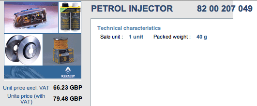

Prices from Renault are -
You would be best to buy a new sealed genuine OE from Renparts on ebay for £32.50
http://www.ebay.co.uk/itm/Renault-C...:2.0+16V+Sport|Model:Clio&hash=item46170fe9f5
